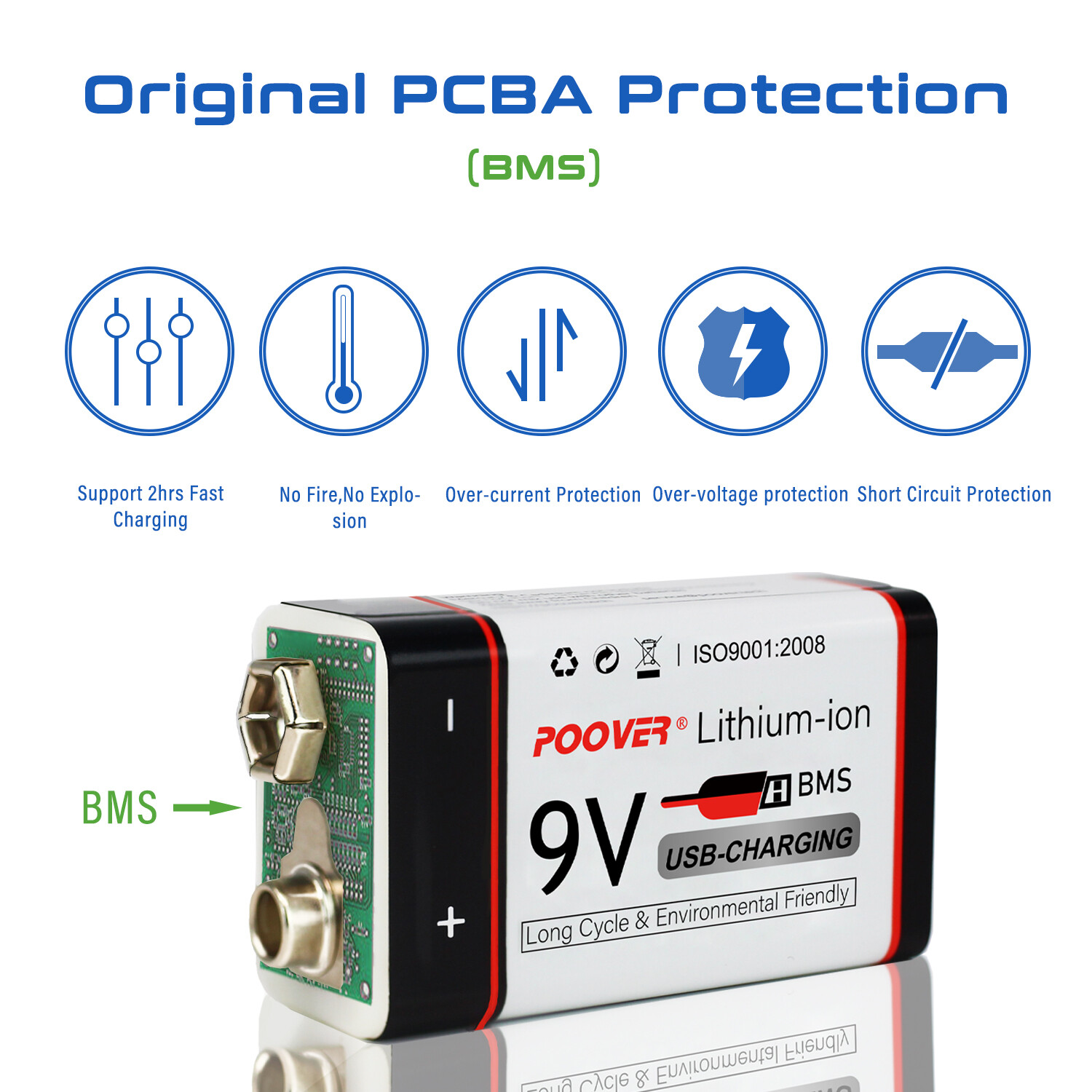

Sam Spoons wrote: Tue Feb 13, 2024 9:54 am Another +1 for rechargeables. I'd suggest Nimh batteries as I think they do supply the full 9volts, there are lots of Li-Ion 9v/PP3 batteries which work well in digital pedals like my loopers but the ones I have max out at about 8.4V so may not be ideal for a guitar preamp.
You've got that the wrong way round. NiMH batteries are 8.4V. Also, the capacity of a 9V NiMH is generally low. There are now USB rechargeable Li ion batteries available, like these :
https://www.ebay.co.uk/itm/144773411390
They have a high capacity and are the full 9V. One thing that's different about them is that they stay at 9V throughout the discharge cycle. They go along at 9V, then go to zero. There must be voltage regulator circuitry built in. With a guitar, there is usually some warning that the battery is going as the sound gets bad. These just stop, but that isn't a problem as it is possible to always have a fully charged spare.

That's interesting, Merlyn. One of the views shows a circuit board at the clip end (covered by a plastic cap on the other pictures):
Don't know what BMS means (guess: Battery Management System) but presumably the circuit is preventing over-charging on input and, as you suggest, managing voltage on output.

merlyn wrote: Tue Feb 13, 2024 1:30 pmhttps://www.ebay.co.uk/itm/144773411390
Seesh these are nifty charging directly from usbC cable phone charger. I was purrchasing Kodak 9V from pondland.

Time for some facts and figures. A Duracell alkaline battery has a capacity of 550mAh. The Li-ions I linked to have a capacity of 1200mAh, or more than twice an alkaline battery. That will go down through its lifespan, but will still be more than an alkaline battery. I haven't timed it, but they do last longer.
Maybe by using the word 'warning' I've given the wrong impression. The voltage on an alkaline battery goes down through its lifespan. Eventually that is too low to run the preamp, and the guitar sounds bad/unusable. The battery must be changed at this point.
I get 9.1V on the Li-ion battery I have here.
