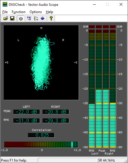

ef37a wrote: Tue Feb 27, 2024 11:55 pm I grabbed that clip with Audacity Nigel and it looked and sounded like mono to me so I viewed it on Samplitude's vectorscope. Pure mono i.e. no directional information.
Something in your system is VERY wrong, then Dave. Here's a screen grab from RME's DIGICheck when monitoring the output of the Youtube player here.
Looks like stereo to me. Not W-I-D-E stereo, admittedly, but definitely not the thin vertical line that would indicate mono. And it sounds stereo, too...

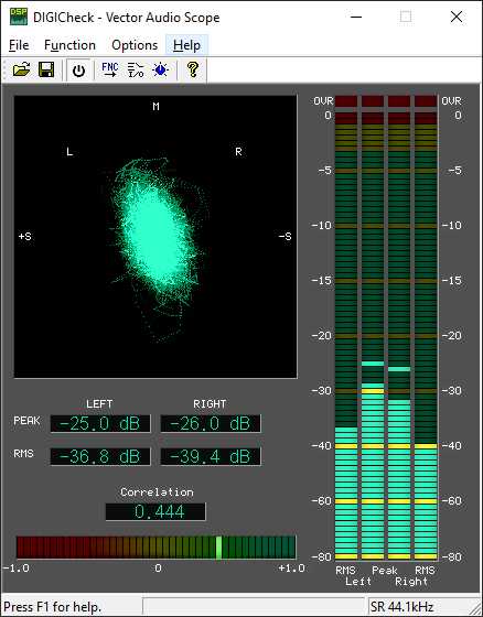

ef37a wrote: Wed Feb 28, 2024 8:16 am Well maybe my extraction process was flawed James so if someone could do that and post a (normalized) clip that shows the difference information I would be obliged.
Here's another of rain recorded in the UK through open windows:
https://www.soundsnap.com/ambience_subu ... window_wav
Even Stereo-er!

Yes Hugh, that soundsnap is stereo and Audacity records it as such and Samplitude shows a 'blob' instead of a fuzzy line. I have not changed any settings in Audacity and I record clips from R3 quite often for my son, never broke, don't fix it. I shall try that other sample later.
