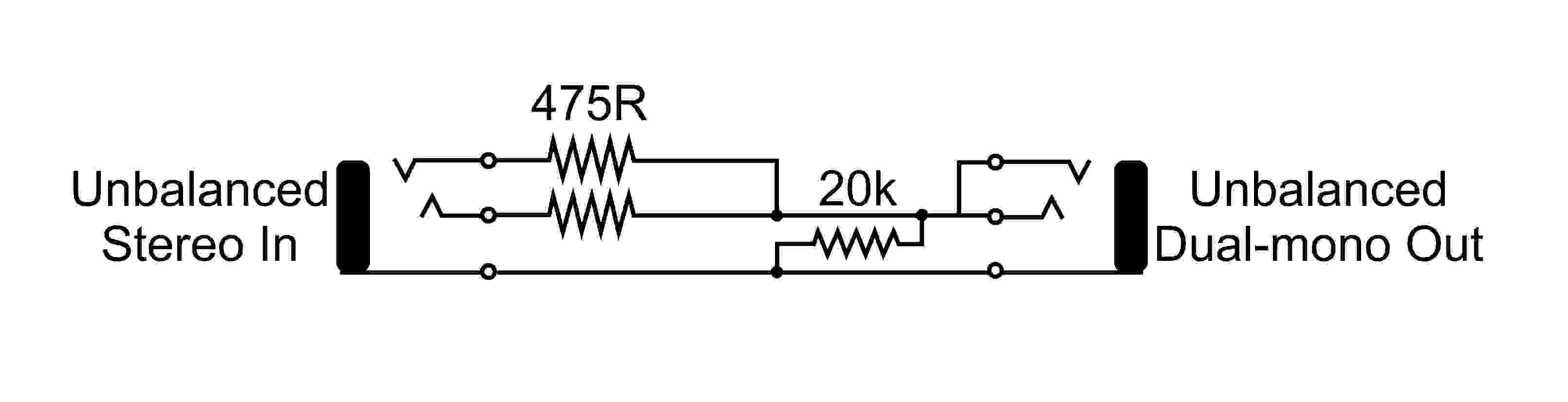

I recently made a stereo to mono cable using a few resistors as detailed in another thread on this board and it works a treat. It goes to an ART DTI (that Hugh made me buy) and off to a little amp (in bridged mode) for my mono grot box.
Now.... I would like to take a stereo feed from my laptop, convert to mono and get dual-mono in the stereo headphones.
I've trawled the web and my own head but am confused.
Anyone care to give me a pointer...? Many thanks.
Re: Stereo to Dual-Mono headphone wiring.
You need resistors in there to keep L from driving R and vice versa (a simple mono summing lead)
Not sure if those resistor values will work as it doesn't specify it's for headphones......
Then just fit a stereo minijack socket to accept the headphone jack at the other end with the tip and ring wired together so it feeds the mono signal to both L & R
Probably easier to do it in the DAW though.... Reaper has a dedicated mono sum button on the master 'channel' strip.

Easy as that... That was the closed door in my head this morning... thanks, Sam.
Just for info of anyone reading this, I used this config from the Rane site at http://www.rane.com/note109.html for my cable.
But i know your one works too.
Thanks again.
Thanks again.

Yep, just wire the tip and ring together at the headphone socket for dual mono.
I'd be tempted to use lower resistor values if you are feeding headphones direct unless you have plenty of spare volume or high impedance headphones. Something like 100 ohms would be work.
Posts: 16990 Joined: Mon Sep 10, 2001 12:00 am
Just for info;
Headphones are a pretty standard 24 Ohm Sony hifi jobbies and i'm using them with an also pretty standard laptop internal soundcard headphone socket.
Tried the 470R / 20k combination and as suggested the output was pretty low.
So for anyone reading i ended up with 47R and 2K to ground and that gives an almost identical volume level in the headphones.
Thanks again for the advice.... works a treat!

Yes, makes sense. The resistor values in the Rane design above are intended for use in a voltage-transfer line-level interface. However, your headphone-driving application requires a power-transfer interface, which means you'd need much lower mixing resistances, of 100 Ohms or less as James suggested. So scaling everything down by a factor of 10 makes good sense.

I've dug out this old thread because I'm summing two channels (not heaphones this time but a simple diy mic amp and simple diy jfet piezo preamp) to one mono output and am finding that the volume pots for each are effecting each other.
I'm using the 475R / 20k configuration.
Is there a way to to that happening?
I wondered the purpose of the shunt resistor?
Would be grateful for any clues. Many thanks.
If you're working in the voltage domain i.e the output will not directly drive headphones, then the summing resistors can obviously be higher. Otherwise looking back into the pot, it can drag down the output from the other side, and in fact for any passive resistive mixer this will always be true to some extent, although obviously if the pots were, say, 1K and the summing resistors were 10K, then the effect would be minimised.
Otherwise you would be looking at an active design, using a low-cost dual opamp, chosen depending on whether you want to directly drive headphones or just another input. There are a ton of devices available, many single supply, a bit of googling will probably come up with a design you can use. Just bang it together on a piece of veroboard.

You probably want to use higher value resistors in line with the outputs for this particular purpose. The best value depends on the design of the source and destination circuits but I would guess that you may want to go as high as 5 or 10k to reduce interaction between the volume controls.
Thanks ajay_m, I'm going to stay passive I think and keep it simple, realise its a compromise but its not that critical.
Thanks again James. I'll experiment with some larger resistors and try and find a good compromise between loss of gain and function.
Thanks very much again.
You can minimise the problem with a passive adder but that means some truly large resistances. This adds noise (is proportional to that resistance), and you'd still need an op-amp to follow, even if just a unity gain follower, just to get a low resistance output that can drive something else without adding complications like HF or LF rolloff because high resistances invite relatively long time constants when interacting with other components in input circuits.
If you are compelled to use an op-amp, you might as well use a standard inverting config to take advantage of the lower input resistances and lower noise.

If both devices are giving out similar line-level outputs, then a standard passive mixer resistor solution should work, as long as you then feed into a headphone amp driver circuit.
Yes, they would.
The headphone stereo-mono adapter is designed for that specific application of dual amplifiers expecting to drive a low impedance, high current load, and the actual load being high impedance and voltage driven. The resistor values are specific to that task.
You have nominally low impedance outputs feeding into a high impedance input, and all voltage-driven. That requires a different approach. Ideally, you need to know the output impedances of both sources, and the input impedance of the destination to calculate the optimum values.
And by the sound of it, the sources output through pots, which means their output impedances are variable from lowish at full volume, to potentially quite high at low volume. That complicates matters....
However, I would suggest starting with series mix resistors of at least 1k ohms, and possibly going as high as 10k ohms. The higher the value the less volume pot interaction... but the greater loss of overall level.
If this is a permanent installation there's no need for the shunt resistor — that was only there in the headphone adapter to maintain a load if it was unplugged from the destination (and to minimise DC popping).
Be aware that passive mixing like this always results in a loss of level, related to the ratio of series mix resistor and destination input impedance, as well as the number of mix inputs. In this case I'd expect around -12dB would be typical....
Hopefully the amp has enough gain to compensate, but if you want to avoid that level loss you'll need to go active with a virtual earth mixer circuit built around an op-amp or two.
