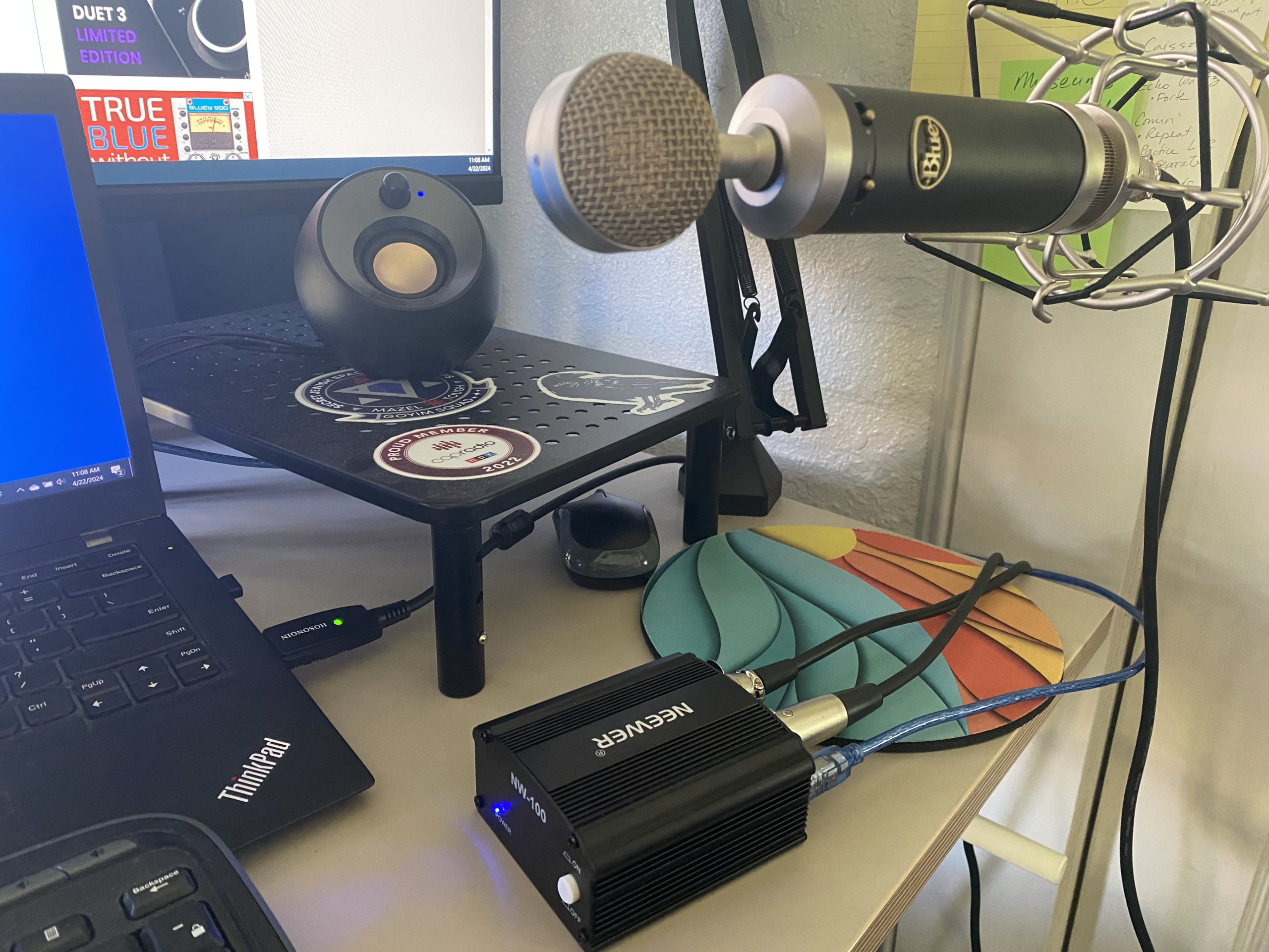

An XLR cable goes from the mic to the NEEWER power supply, then another cable from the XLR port on the power supply to a USB port on my laptop. I also have a cable going from the power supply's DC 5V port to another USB port on my laptop to get power to the power supply. Hope that makes sense.
It just seems odd that it worked for a day and then stopped without me changing anything.
Here's a photo of the setup: https://visions-voices.org/wp-content/u ... scaled.jpg

pchadwick wrote: Mon Apr 22, 2024 7:15 pmthen another cable from the XLR port on the power supply to a USB port on my laptop.
OK, so this is the likely culprit, or rather, how your laptop is seeing it. This cable is acting as an audio interface, so check that your laptop is actually set to use this as the input and not the built in soundcard.

So the USB is only providing power, it is not an audio interface? I would guess that the reason it "worked for a while" was that the audio was being recorded via the laptop's onboard mic. Seeing as there is no audio connection from the Blue mic to the laptop.

I had the impression the audio went via an XLR to USB cable with a biilt-in ADC — the lumpy lead in the photo.

Hugh Robjohns wrote: Tue Apr 23, 2024 7:47 pm I had the impression the audio went via an XLR to USB cable with a biilt-in ADC — the lumpy lead in the photo.
OK so that cable is the thing that shows up on the computer, since it is essentially an audio interface. If that is not showing up that is the problem, not the Blue mic? Hopefully... we don't want more than one problem :)
Swapping the other mic in suggests that the ADC is still working ok, it might be as Hugh suggests that the power supply is not able to provide enough oomph to keep the Blue going but the other mic draws a lower current.

I appreciate all the suggestions and attempts at figuring out the issue. The Blue mic says it needs 48v power and the Neewer power supply is 48V.
I switched the Neewer power cable (that plugs into a port labeled DC 5V) from a USB port on my laptop to a USB plug that's plugged directly into a wall outlet, but that didn't solve the problem.
Not sure why it wouldn't work, but maybe I should try a different power supply? There's one that's labeled DC 18V and the cable goes directly to the wall outlet without using a USB connection.

I think that’s your next step. As said above, the 5V supply may not provide sufficient current for the Blue mic. Only one way to find out.
