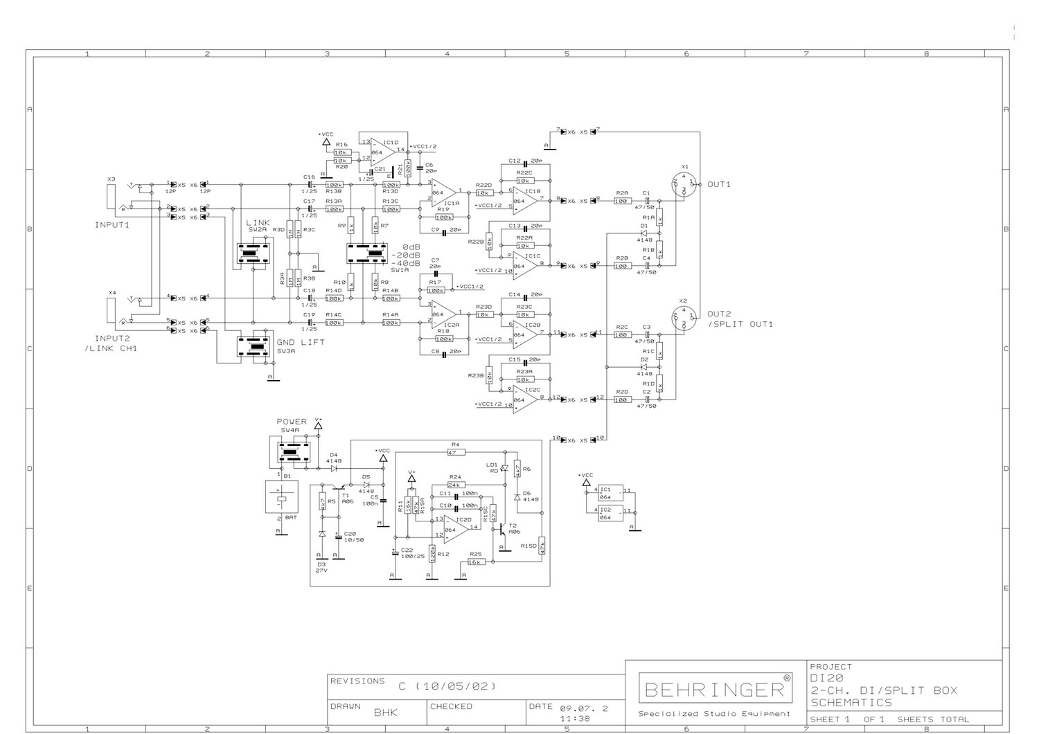

The DI120 does not employ isolation/step-down transformers. And its ground-lift arrangement is unusual — similar to a pseudo-balanced approach. The active elements are TL064s... not the quietest op-amps on the block.

Hugh Robjohns wrote: Thu Jun 06, 2024 11:11 am The DI120 does not employ isolation/step-down transformers. And its ground-lift arrangement is unusual — similar to a pseudo-balanced approach. The active elements are TL064s... not the quietest op-amps on the block.
What a faff way to make a DI box! Yes the TL64 is more a 'cooking' IC than 'studio' but putting 200k in the op amp's inputs is 8uV of noise they could have avoided!
Passive DIs are pretty simple devices and since Orchid have gone a bit pricey why not make your own? Spend the big money on a decent transformer (Sowter if you want home grown) then its just a tin and some jacks. Or you could use a really cheap and grotty traff and get some "attitude"?
BTW Hugh, how do you get Behringer schematics please? If I could find one for my BCA2000 I would get it out of the loft and try to fix it!

ef37a wrote: Thu Jun 06, 2024 4:08 pmBTW Hugh, how do you get Behringer schematics please?
I found that one on a public website, but I've no idea where it came from I'm afraid. I doubt Behringer are happy its out there, either!

Sam Spoons wrote: Thu Jun 06, 2024 5:01 pmThe DI120s were noisy and physically extremely fragile, certainly not up to being kicked around a live stage
I'm not convinced the DI120 was really conceived as a true DI box at all, for the following reasons:
1. It doesn't inherently pad the output signal down to mic level.
2. It has (crude) balanced inputs.
3. It has a Split feature to duplicate one input at both outputs.
4. It doesn't provide galvanic isolation.
I think it was conceived as a balanced line driver/signal splitter and was re-purposed somewhere along the line.
