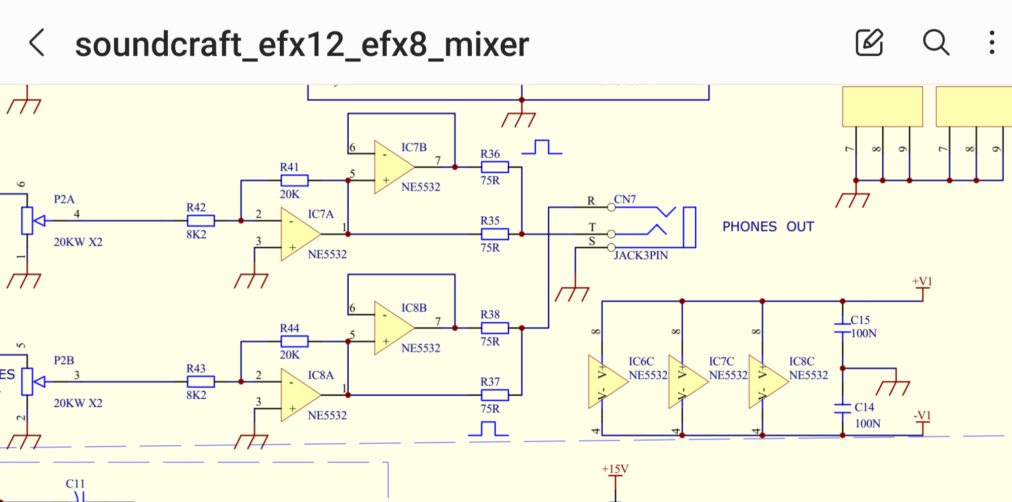

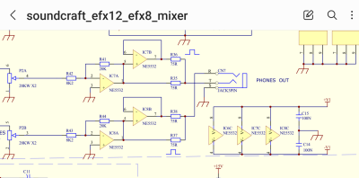

It is interesting to look at the output circuit of the EFX12. It looks like it may be a Doug Self design using a pair of NE5532 op amp sections in parallel with 75 ohm output resistors on each section. 300mW into 150 ohms implies an output current of 45mA which is very close to the recommended limit for 2 of these op-amps in parallel. If one of the op-amps happens to have a higher resistance output than normal then you could end up with more distortion than expected.
I would have thought that they would be happier driving higher impedance headphones at a lower current.
Posts: 16991 Joined: Mon Sep 10, 2001 12:00 am Location: The wilds of Hampshire

Re: Beyerdynamic DT770 Pro 80 ohms occasional distortion!
Here's the schematic James referred to above, in case anyone is interested. I agree that is is more of a voltage supplier than a current supplier, so may well perform better with higher impedance headphones — not least because there'll be much less signal voltage lost across those 75 Ohm output buffers.
Posts: 43693 Joined: Fri Jul 25, 2003 12:00 am Location: Worcestershire, UK
