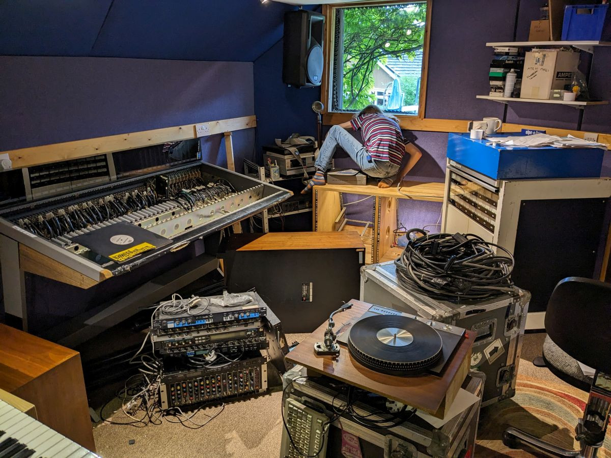

Big studio move tomorrow - this is how we ended up today...

Are your computer monitors in the first picture 4x3 screens?

Kwackman wrote: Sun Sep 01, 2024 8:39 am Are your computer monitors in the first picture 4x3 screens?
I used to have 2 4x3 screens but one went wrong so it was replaced by a 16x9 screen. The studio computer doesn't get used so much these days - much of the work is done by the laptop in front of the mixing desk now as the audio interfaces that I use the most require a more modern OS.

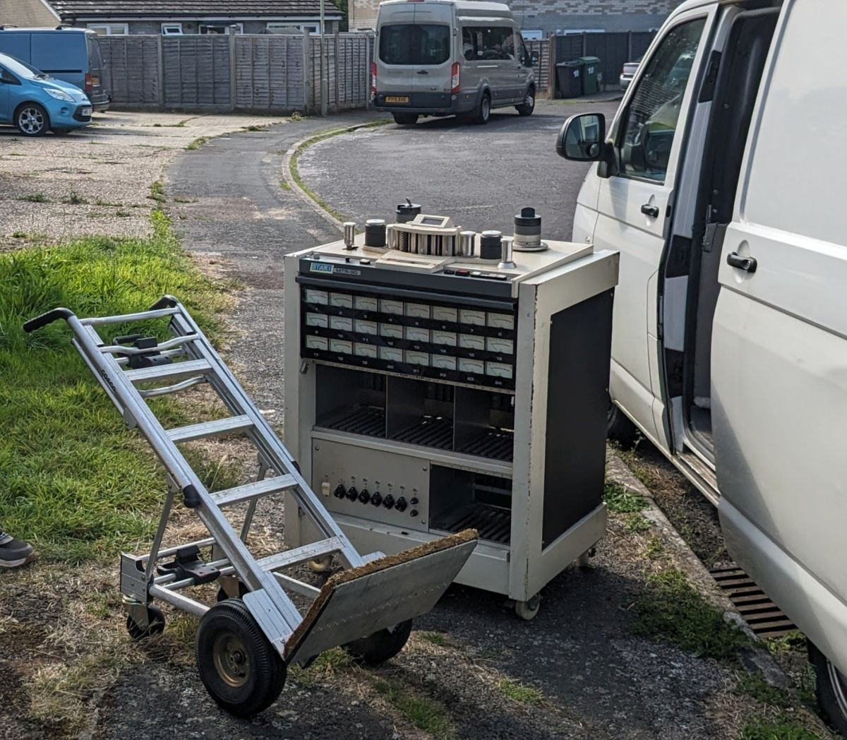

Big Bertha is on the move
Big Bertha is in da house!
Whenever I move the MTR90 I always hope that it will be for the last time - although this time I know we will be moving her again (albeit just a few yards) in a few months time.

It is a beast!

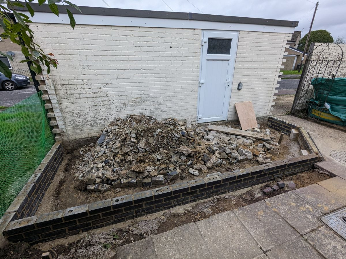

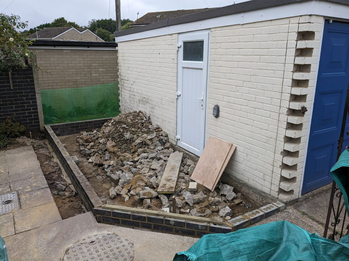

Progress has been a bit slow over the last few days thanks to the weather and waiting for materials but we are on the move again with the start of some bricklaying...

If, as appears to be the case, you are re-using your old bricks, well done. Not always the easiest, sometimes not the cheapest (labour to clean them up) but definitely the most sustainable. :thumbup:

BillB wrote: Tue Sep 10, 2024 9:56 am If, as appears to be the case, you are re-using your old bricks, well done. Not always the easiest, sometimes not the cheapest (labour to clean them up) but definitely the most sustainable. :thumbup:
Yes, we are re-using quite a few of the bricks - fortunately we have a source of cheap labour here ;)8-)

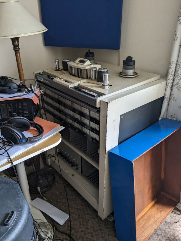

Just spotted that Nakamichi, it never ends, I'm the Hercule Poirot of hi-fi.

Arpangel wrote: Tue Sep 10, 2024 8:32 pm Just spotted that Nakamichi, it never ends, I'm the Hercule Poirot of hi-fi.
I'm impressed considering there was only about a quarter of the front panel in shot and missing the really interesting unique bit (though I guess you can see the name if you zoom in).
Edit to add - but can you spot what is strange about the Otari's heads?

James Perrett wrote: Wed Sep 11, 2024 7:58 am
You’ve got me there James, is it a 16 track head block?

Arpangel wrote: Wed Sep 11, 2024 8:16 am You’ve got me there James, is it a 16 track head block?
You are close - the play head is 16 track while the record head is 24 track so I can choose which format I want to play with just the flick of a switch.

James Perrett wrote: Wed Sep 11, 2024 9:19 am
Interesting! but how does this work if you want to play back 24 tracks? do you have a spare head block?

Play from the 24 track record head using the sync playback mode. In the olden days there was a noticeable quality loss using the rec head for replay, usually because the head gap was wider and the electronics didn't have the right EQ etc... but not in the Otari.
I have a similar function in my Revox PR99 — half -track replay head, quarter-track record head used only for replay via the Sync head buttons. (Record functions disabled)
Posts: 43685 Joined: Fri Jul 25, 2003 12:00 am Location: Worcestershire, UK
Re: James' Studio Build 2024
Yes, the record head has a dual winding with the windings in parallel for recording and in series for playback so better optimised for each function. I bought the 24 track head from a dealer in the Netherlands and was expecting to receive a playback head but when the record head arrived I tried it and the results were good so I kept it.
