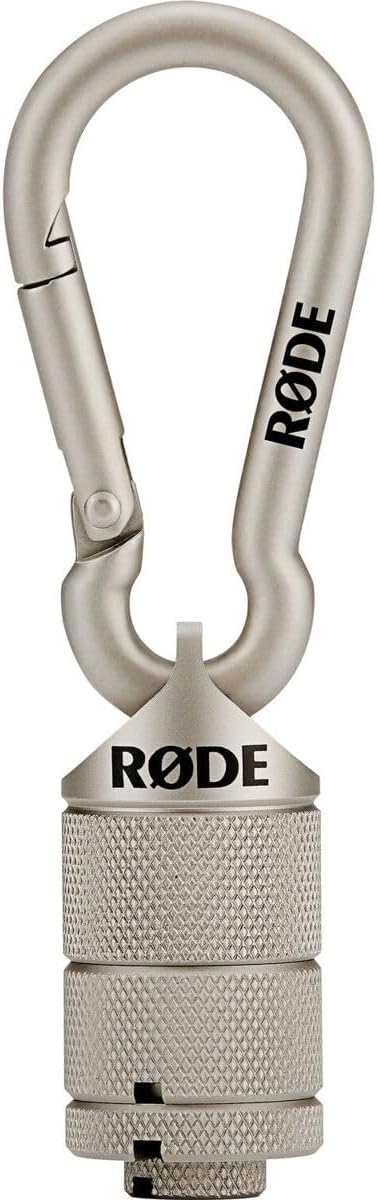

This covers most bases in a convenient format:
RØDE Thread Adaptor Universal Adaptor Kit with 1/4, 3/8 and 5/8-inch Adaptors
RØDE Thread Adaptor Universal Adaptor K ... /d/5h0yxTo

Ooh, thanks Hugh, I'm getting one!

I notice from that picture that the adapters all have just one slot cut in them.
Always been that way and is a PITA as anyone knows if they get screwed in 'slot first'.

The Rode kit is nicely done and won't get lost...although it might get stolen as it is so desirable! But it is pricey at around £20.
If you do a search on Amazon for 'Microphone Thread Adapter Set' you find dozens of options for half that much or less.
