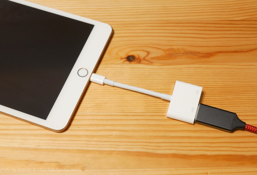

I totally agree - it's a very bad design decision by Apple. I have a friend with a Lightning-connected iPad who bought a Lightning Digital AV Adapter from Apple, so she could watch iPad movies on her large screen TV via a long HDMI cable.
It cost £50, but because the much heavier and less flexible HMDI cable ends up flexing the thin adaptor cable about half an inch from the Lightning connector, the adaptor cable has already become intermittent.
The slightest movement while watching a film now results in momentarily breaking the video connection, and then you have to reboot the iPad to get its video signal re-recognised by the TV's HDMI connection.
Apple eh?

I did overspend for an apple adapter that looked like the above photo. It has USB and lightning slots side by side so I could charge while doing USB things.
My ipad is 2nd gen so lightning is the connector on the ipad side.
I went apple as I didn’t want to mess around with testing and sending knock-off adapters back.
It has lasted awhile and is still going strong but I’m very careful with trying not to stress the adapter.
If I was using a thicker cable like HDMI I would probably duck tape the HDMI down or put a brick on it so it would stay put and not stress the cable so much.

Sage advice MFG, and if now bought any official Apple adaptor I'd also reinforce the half inch of sleeve next to the Lightning plug itself (the break occured exactly where this ended and the cable was suddenly more vulnerable) with several inches of decent heatshrink.
However, in this particular scenario, the large TV was in the bedroom, while the iPad controlling the chosen streaming movie was several metres away, balanced on the bed. Somehow I doubt that a brick or duck/duct tape would be a popular solution here
