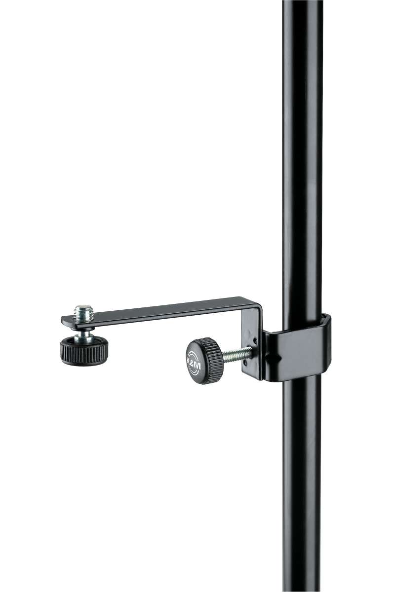

Can anyone recommend an easy/cheap way of mounting 2x 414s in Blumlein on a single pole that I can mount on a single stand that I can carry? The few that I can see for sale are very expensive for what they are!

One of these little cheap mic extension bars https://www.gear4music.com/PA-DJ-and-Li ... KeEALw_wcB
Gives you a rig like this:

Drew Stephenson wrote: ↑Tue Feb 04, 2025 4:39 pm One of these little cheap mic extension bars https://www.gear4music.com/PA-DJ-and-Li ... KeEALw_wcB
Thanks, that's exactly the kind of creative (and affordable) solution I was looking for! Handy to have too, will get this on order.

As Drew says, a guitar clamp is a convenient and low cost option for supporting one mic below another.

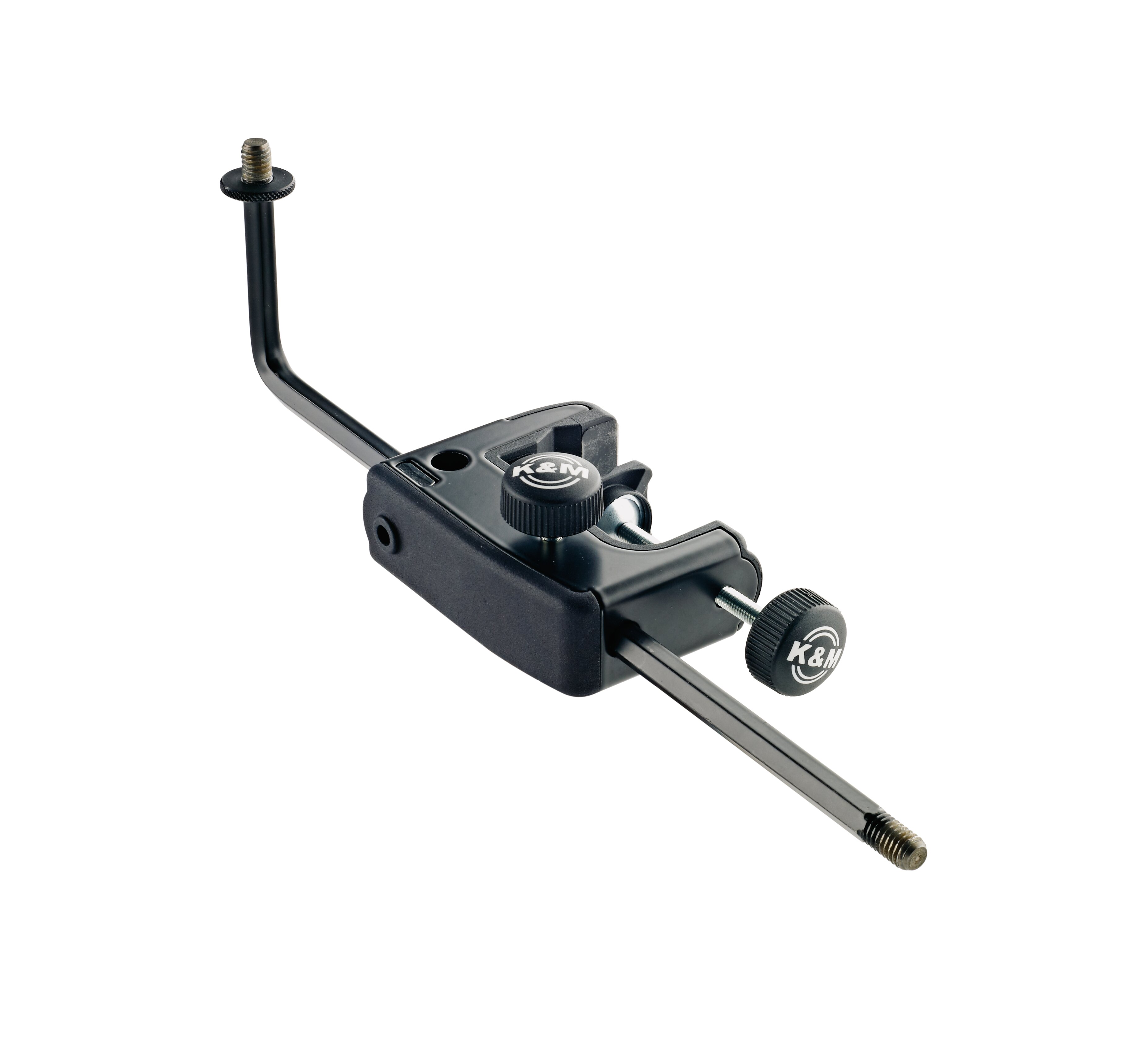

Surely M/S would work with a single straight stand plus the guitar mic adapter mentioned above? Sure a spaced pair of omnis is a bit trickier to manage but should still be possible with a single stand and a spacer bar. As your 414's are multi pattern it shouldn't be too hard to carry enough different adapters and such like to experiment with all the options?

Sam Spoons wrote: ↑Thu Feb 06, 2025 9:39 pm Surely M/S would work with a single straight stand plus the guitar mic adapter mentioned above?
It depends if the mic adapter will extend far enough to align the stand mic with the one on the guitar adapter (K&M 238). The K&M 24050 is a lot more versatile, but twice the price.
Posts: 43690 Joined: Fri Jul 25, 2003 12:00 am
Re: Field Recording & Blumlein Mount
I like the look of that, maybe I need one
