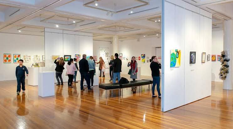

I stumbled across this FB post which appears to be the OP asking the same question... but with a picture of the venue which I thought might be helpful to contributors.
https://www.facebook.com/share/p/1AFJfbBsbN/

Ye gods - that's definitely a case of damage limitation then.
I would be inclined to at least get a large rug beneath the trio, to absorb at least some of the reflections from that oh-so-shiny floor.

Yes that is indeed my post and the photo you see there is a local council art gallery in Victoria, Australia. I got a few helpful comments on there. Also a lot of kind of silly ones suggesting I hang booms from the light bar or use a giant ambient pole. I'm not sure what kind of gigs people are working where those are considered simple options.
So far, I've devised a plan to use a wide-ish spaced pair however each mic will be mounted a seperate mic boom. I'll have one mic stand on either side of the cello riser and raise the booms up in towards the the centre of the ensemble; dare I say it might look pretty. Cello spot will be needed.

Any chance of visiting ahead of time? Hearing the acoustic for real will make miking decisions so much easier!
I think the ambient pole was my suggestion here... but it was before I'd seen the place, and to be fair, the ambient pole has solved a lot of tricky recording situations for me.
Having now seen the place, dropping mics from those lighting grids might well be a pragmatic and audience-safe solution.
I'd ignore the suggestions to put down a rug, though. Stages have wooden floors for lots of reasons, but most orchestral instruments are designed to work with reflections from wooden floors.
