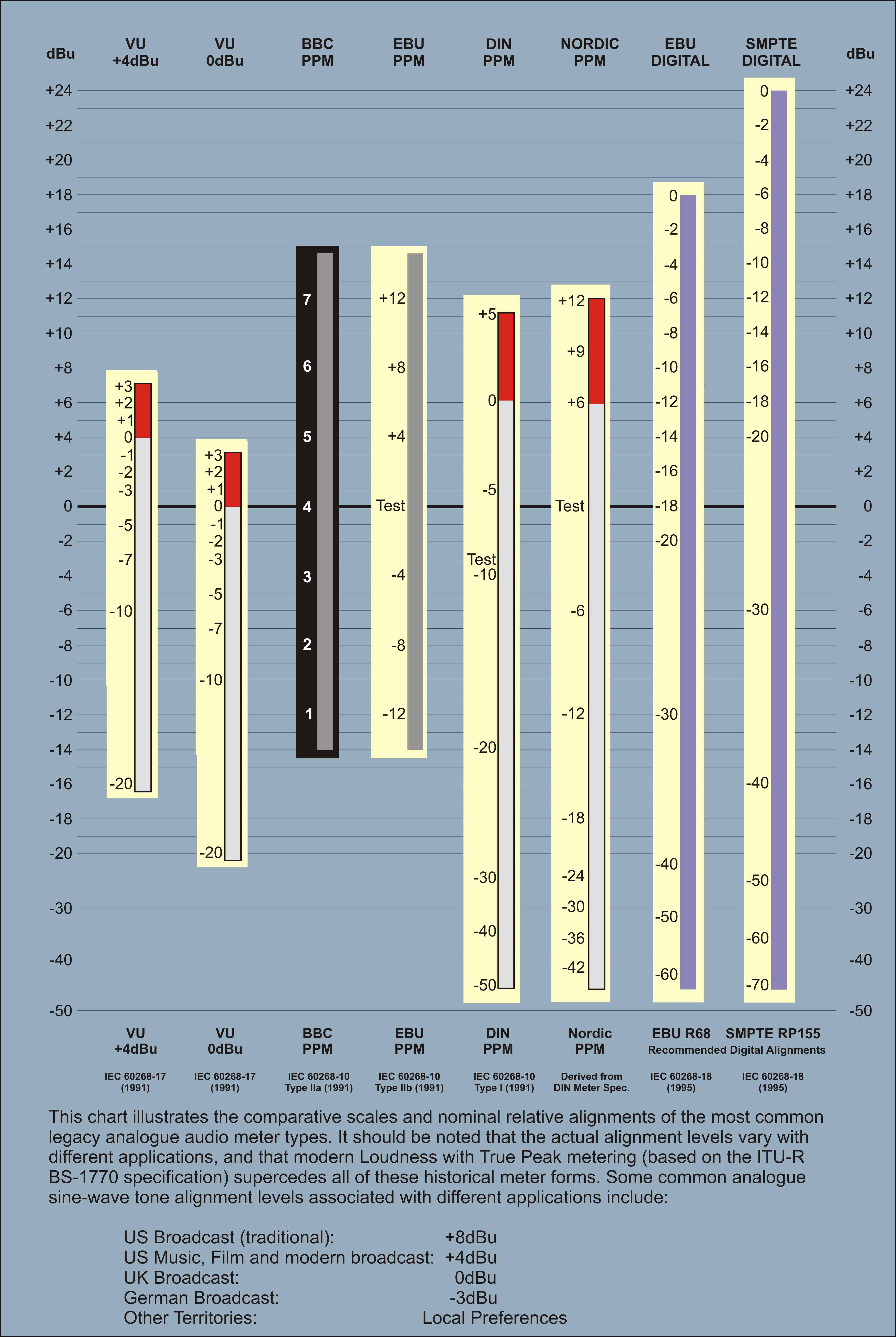

This article from Hugh gives a pretty comprehensive take on metering: https://www.soundonsound.com/sound-advice/metering
I think there's been a more recent update too with a nice graphic showing how the different scales align but I can't seem to find that one at the moment.
Re: Stereo RMS Combined RMS
This one?
That's the one.
