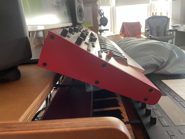

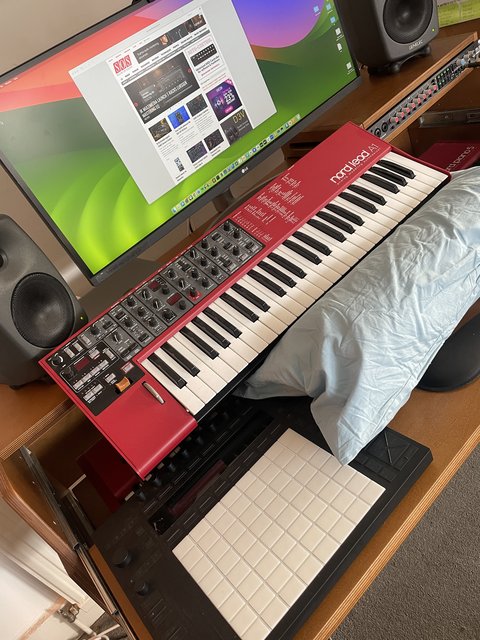

Any thoughts on a mount or bracket that gets me from picture one to picture two/three? Minus the pillow, obviously!
Bit crap at DIY so it should not be made by my clumsy hands, the desk is a nice piece of furniture so it shouldn't gouge great troughs out of it, and the keyboard can't rest on the lower shelf as it's a sliding shelf and still needs to move.
It might not be possible. There's not much room and most of the weight of the Nord Lead is over the edge of the shelf. Just a thought, in the neverending journey of studio ergonomics!

Pretty hard to see from those pics. Is there room to mount the keyboard on a tray under the shelf? (https://nz.pinterest.com/pin/synthkeybo ... 693210121/)

It looks like you’re going to have to get some mdf cut at B&Q to make a shelf using wood glue that slots under the furniture top shelf with sides that you’ll have to cut the angled slope.
I would suggest giving it a back section for support and structure and cut out a hole at the base if needed for wires etc. It’s not clear if you need access to the keyboard just visible at the back?

Stagg do these keyboard brackets, meant for 'slat walls', the type you often get in music shops.
https://www.amazon.co.uk/Keyboard-Slatw ... OIRF&gQT=1
But if you mounted a couple of blocks of wood underneath the top desk tier, drilled some holes in the flat 'wall' end of the arms, you should be able to screw them into the blocks and mount the keyboard on them.

MOF wrote: Sat Apr 19, 2025 10:34 am It looks like you’re going to have to get some mdf cut at B&Q to make a shelf using wood glue that slots under the furniture top shelf with sides that you’ll have to cut the angled slope.
Oh ffs, gah! Why do I always forget cabling when thinking of these things :headbang:

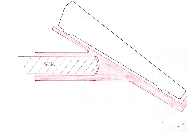

I'm wondering whether something like this might work. Obvioulsy the drawing's quite crude and not to scale. There'd be two such mounts and the weight of the keyboard itself would secure them and rubber pads between the mounts and the desk would prevent slipping and protect the wood. Am I missing something?
I'm lousy at DIY but pretty handy with CAD software. It wouldn't be so difficult to get some prototypes laser cut in MDF or ply.

Unless you're going to screw into the desk I wouldn't be trusting that.
Personally, if this was my desk, I'd create a similar set of holding brackets, but ones that hooked over the rear of the shelf.
I'll knock up a quick pic.
Summat like this:
The weight of the keyboard at the front keeps a balancing upward at the back. Additional pressure at the front (from playing) doesn't then cause it to move away from the shelf. The arms that go front to back can be shaped to go under your screen but over the mount. Hook the back in place, drop down the front, add your keyboard to make it secure.
Could either do as two separate arms (with a couple of horizontal studs for stability) or run a couple of bars between the two arms (probably what I'd do).
Could probably cut all of it out of a single length of 4x1, but I'd need to knock up a couple of scale drawings first.

Yeah I wondered if with my design the downward force ultimately brings the keyboard forwards
