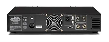

Strange manual. The front and rear panel drawings don’t show a DI output, but the block schematic does and it’s in the specification list.
According to the schematic, the DI is positioned just before the master volume control, so you could leave the speaker(s) attached and turn the master volume right down.

Weird that they omitted the DI out from the rear panel drawing... but it definitely exists:
