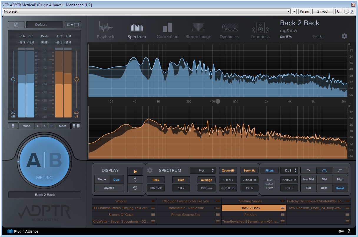

You could import the track to your choice of DAW, and then toggle between your own mix and the imported reference track to compare them, but in most cases it's easier to use a suitable plugin.
For some years now I've used MetricAB from Plugin Alliance, which lets you load into it up to 16 different reference tracks, either using them whole, or marking a specific shorter section that loops round.
Then, at any point in your song, just open up the MetricAB plugin window and click its large A|B button to switch between any of your chosen reference tracks and your mix for A/B comparisons. Another single button press will adjust the loudness of all your reference tracks to that of your mix, so you can compare them more honestly.
This is greatly helped by switching between the various tabbed windows, where you can compare the frequency spectrum, stereo imaging, loudness levels, and so on. You can also filter what you're hearing, so for instance it could be useful to hear only the low end or the high end when comparing your mix with that of a reference track.
