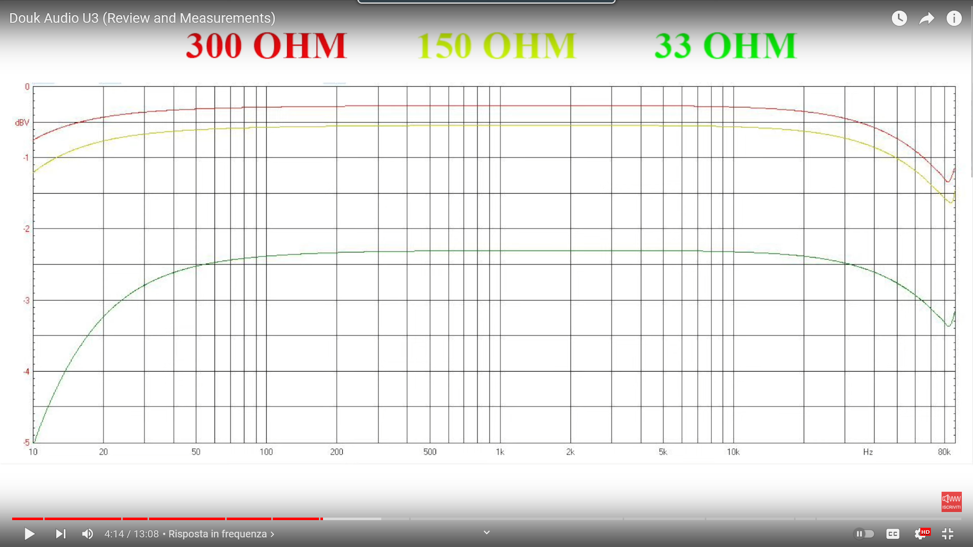

James Perrett wrote: ↑Sat Jun 07, 2025 11:38 am The use of output capacitors means that low frequencies are going to be slightly reduced with standard 32 ohm headphones which may be important if you are creating dance music where bass level is important.
However, looking at the test results on your very welcome link James, with a 33ohm load the frequency response only measures -1dB down at 5Hz, so I doubt that's a worry in practice.
Re: What do we think of this headphone amp with replaceable opamp
A possible point of concern is that uptick in the frequency response just above 80kH - suggests marginal stability.
Indeed, why haven't they tamed the bandwidth well below that frequency?
- Folderol
Forum Aficionado -
Posts: 20880 Joined: Sat Nov 15, 2008 12:00 am
Martin Walker wrote: ↑Sat Jun 07, 2025 1:30 pm However, looking at the test results on your very welcome link James, with a 33ohm load the frequency response only measures -1dB down at 5Hz, so I doubt that's a worry in practice.
The graph that I looked at shows 0.5dB down at 30Hz - and an 0.5dB difference is certainly audible with a good monitoring system. I'd expect a well engineered amplifier to be almost flat between 20Hz and 20kHz.
Posts: 16989 Joined: Mon Sep 10, 2001 12:00 am
My apologies - I was looking at the 300/150 ohm curves

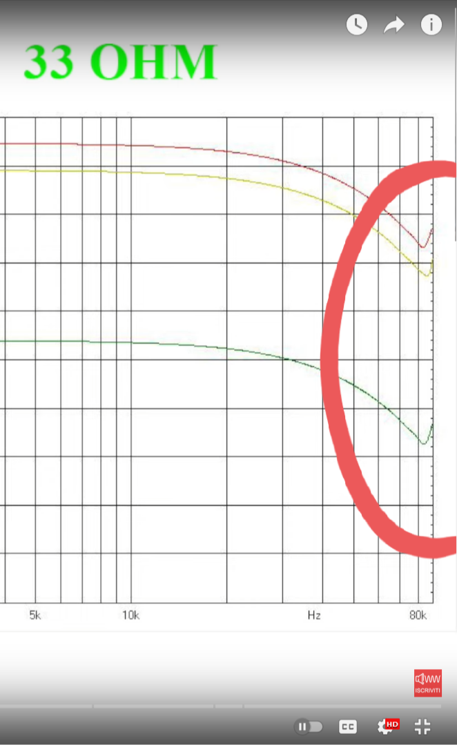

I think Will is talking about this frequency response plot:
Which, after rolling off gently from 20kHz, has a rather alarming rise at 80kHz towards a resonant (?) peak at maybe 100kHz or higher — just above the measurement range.
That kind of thing is never good, and highlights the importance of looking beyond the wanted bandwidth for unwanted artefacts.
It's hard to tell, but there is a hint of an uptick above 80kHz in the noise-floor plots too, which suggest a possible self-oscillation problem, rather than a resonance problem.
So, it is definitely NOT class A and it delivers less than half its advertised power but the video tells me is is a remarkable good device even at the very low price. I find Amazon have them at £44.00 Hmm, tempted but...MOT next month!
There is that problem at ~80kHz. Couple of 27 puffs?
Will mentioned "out of audible response trimming"? The argument has raged for ever whether we need amps to go much beyond say 30kHz and has never, to my knowledge ever been resolved? I don't think there is any other area of "control" engineering where systems are made to respond to signals way outside what they will experience? Examples are bumps in the road and waves in the sea.
