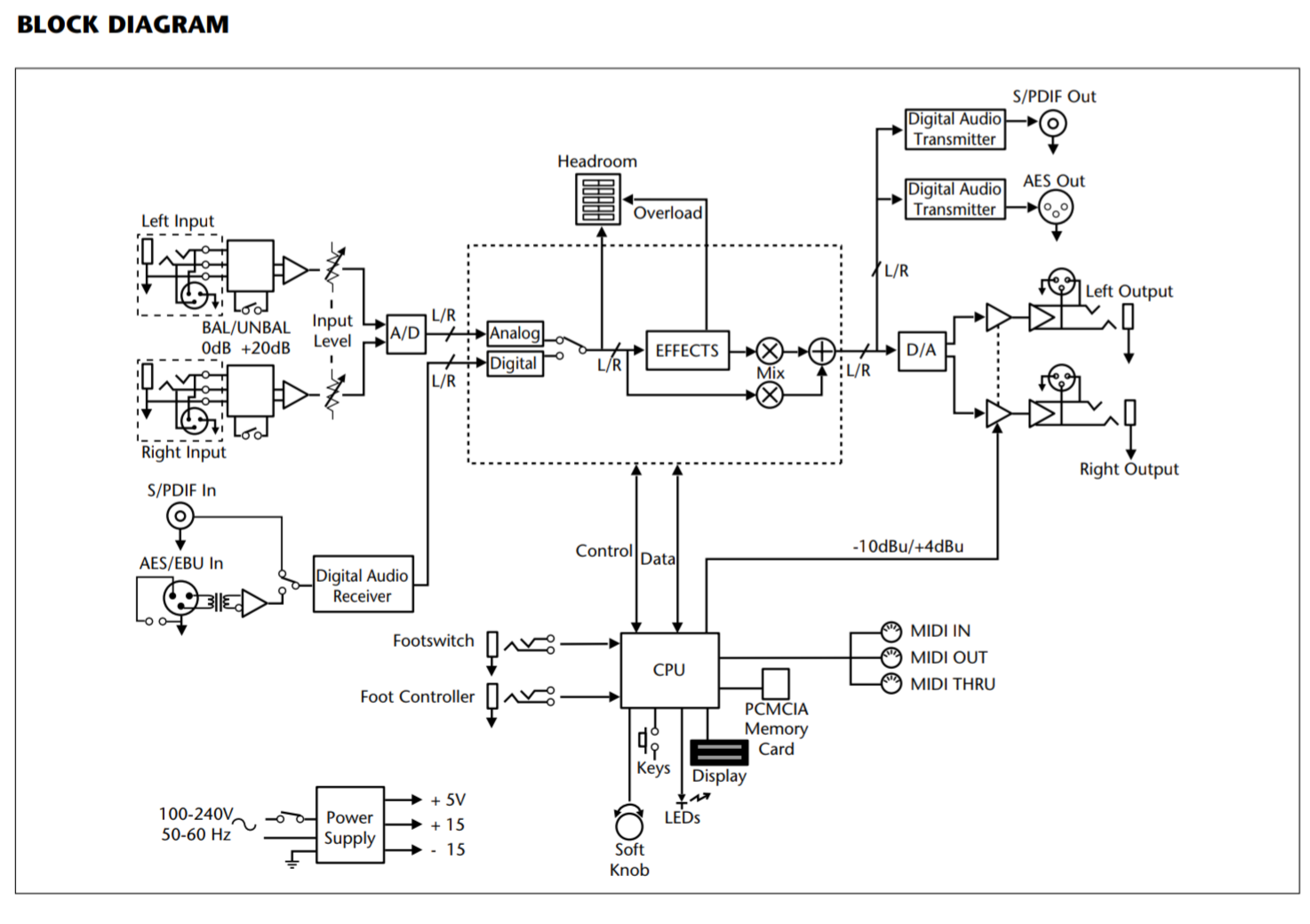

I downloaded the manual, the schematic looks like the inputs are summed into mono to the main processor, so I can't see how feeding both inputs would make any difference?...
If, by schematic, you mean the block diagram in the user manual, where do you see mono summing taking place because it doesn't show any mono summing of inputs.
(The separate L/R analogue inputs feed an AD conversion stage, drawn with two inputs, the output of which is a two-channel L/R digital signal (though the two-channel digital paths are shown by a single line with a little diagonal slash across it with a "L/R" label to indicate composite signal paths on the same drawn line). The L/R path continues to the FX processing block and then to the digital output drivers and the input to the two-channel DAC, after which the analogue outputs appear separately again.)

... the schematic looks like the inputs are summed into mono to the main processor...
No it doesn't — look again! (And it's a block diagram, actually, which is different to a schematic, strictly speaking).
The L/R marks indicate stereo paths through the entire structure. There is no mono summing...

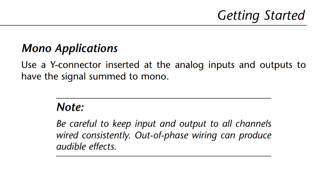

...and if there were internal mono summing Lexicon wouldn't have provided this clear instruction:
..so I can't see how feeding both inputs would make any difference?
Just because you don't understand doesn't make it untrue!
Some cheaper reverbs sum to mono before feeding the reverb processor. The better ones process in stereo. The PCM91 is the latter type.
You can learn or you can argue... your choice, but my patience is wearing thin.

Feed it dual mono from outside as the manual states. It needs a signal on each leg (channel) and despite being identical will likely process each one differently in DSP and spit out differently processed L/R signals as part of the stereo algorhythm's intended pseudo stereo reverb space.
Pan outputs hard left and right.

Not so much a 'warning' as helpful information that the input sockets are half-normalled..
I haven’t owned any Lexicon stuff that had this, and they’ve all worked fine, my 224, and my LXP1.
Past performance is no guarantee of future results....
Thats why manufacturers write manuals
... :-D

And write handy hints like "use left input for mono" on their products. Or don't. :tongue:
