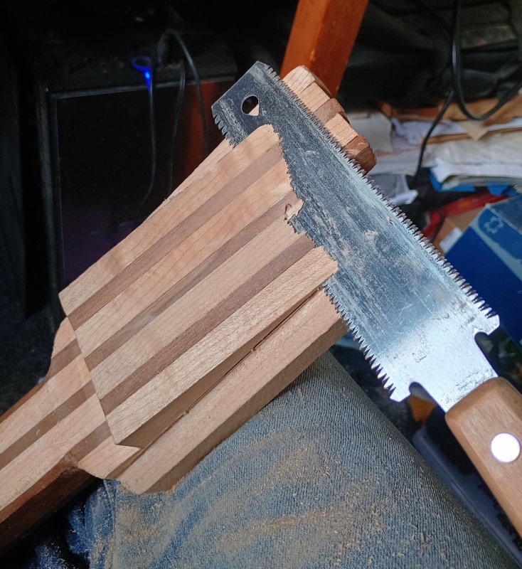

Yesterday, I summoned up the courage to saw off the spare wood from the back of the headstock aimed to take off slightly less than needed because I knew it would need some tiding afterwards.
turned out fine !

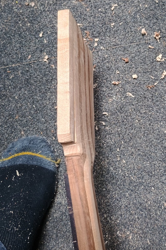

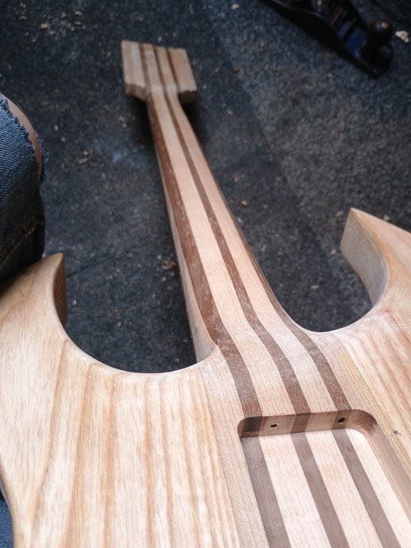

With the headstock trimmed down started reducing the neck thickness
now down to 26mm at 1st fret & 29mm at 12th fret - Uber chunky, but feeling strangely comfortable!!!
are my plans for a skinny neck changing?
...maybe, not sure, I might even retain a volute that is forming by accident.

It's all down to you. You can either try and duplicate a neck you already have and like, or just go by feel. Of course what may be comfortable for playing chords may not feel so good playing fast single note phrases. But if you keep the finish simple e.g. just clear lacquer, then it's not going to take much refinishing effort if you decide that it feels a bit too chunky later on and want to shave a bit more off it.
It's obviously a lot harder to make a skinny neck more chunky.

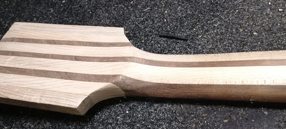

Quick update, neck now down to:-
22.6 at 1st fret
28.7 at 12 fret (needs more work at this end)
Feel nicer, I will go a little slimmer but waiting till I've recovered
Seem that thining the neck with spoke shave & scrapers whilst supporting the body between legs and the headstock on chest is not a good idea, I seem to have bruises on my chest! no real harm done, will be back to this in a couple of days.

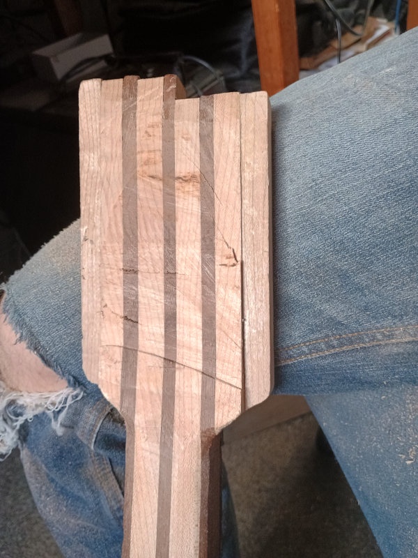

I'm having 'worries' about the headstock, did I do a good enough job with glueing?
I think so, but still concerned as it's thin (16.5mm). Thinking I might put a couple of 8mm dowels just to give it a little more lateral strength in case it gets bashed.
Never seen this needed, but I don't think it would do any harm?
(apart from the looks) It's a feature honest

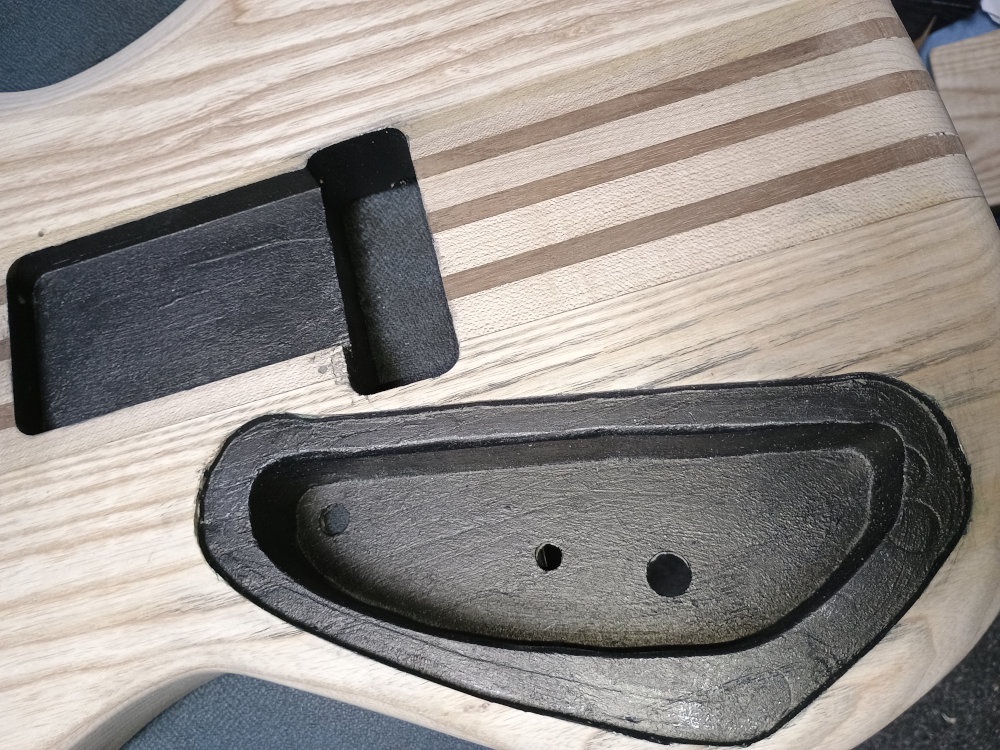

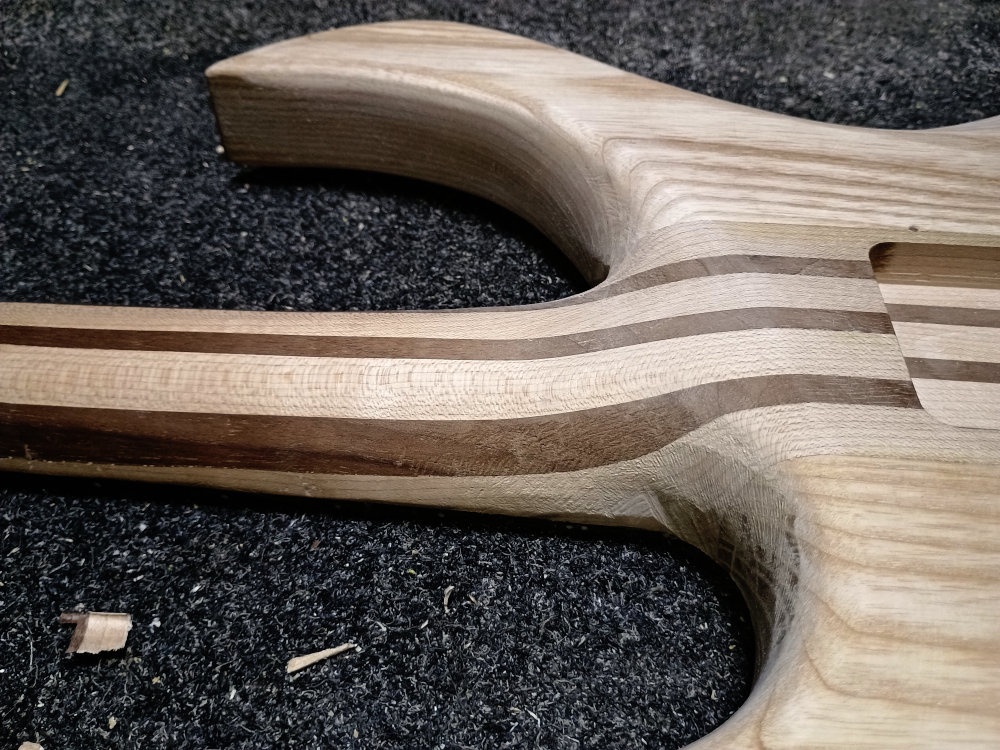

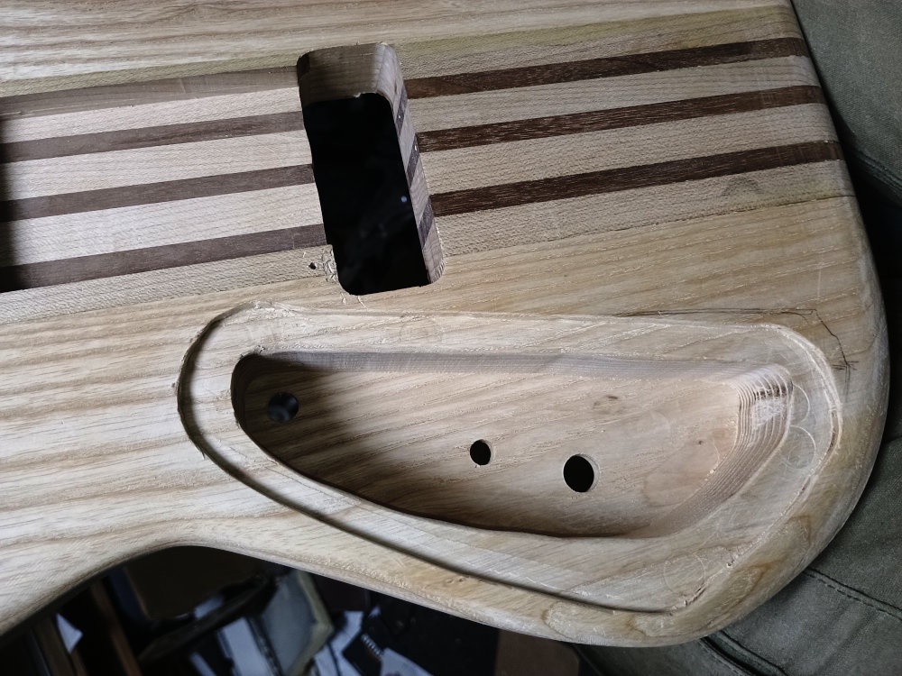

...so it's been another week - What's the lazy, no good, idiot been up to, will he ever get this finished ?
Neck shaping complete (stuck with 22.6mm at 1st fret , now down to 26mm at 12th)
Routed the back of the trem a little deeper' cut a piece of rubber and glued it in!
(blackend some of the edges of route before glueing) should allow a tad more upbend and also protect the cavity from dents.
Router blade arrived so control cavity now cut to proper depth
Made a template & routed for a cover plate, template moved again so a little closer to the edge of the body than I'd hoped.
..also made an Oopsie near the trem cavity. Luckily this is the back so I'm not going to worry too much!
Not sure if I will route for the trem cavity cover or if it will just sit on top will depend on clearance for springs & trem block - rear cover may end up one piece.

Just to comment on this. I was in the same position and had to glue some headstock 'ears' on. Never had any issues with them being strong enough - as I'm sure you know the glue tends to be stronger than the wood - and it has been bashed a couple of times as it's not in a hard case, with no ill effects.
Your decision, but personally I'd consider it overkill and unnecessary and would probably spoil the look.
Re: Idiot tries to build guitar!
I wouldn't say 16.5mm is thin. You might need to add 0.5mm of finish on to that. With most 6-in-line tuners, the centre of the string hole is between 20 and 22mm (depending on manufacturer) from the base of the tuner. With the washer and screw-down nut on top taking up about 3mm of extra height, you could have just a very small part of the tuner hole showing above the fixing nut.
If you've already bought the machine heads, it's worth trying one out against the headstock to see just how much of the tuning post is sticking out above the top. Ideally, unless they are locking machines, you'd want all of the curved section of the post sitting above the fixing nut.

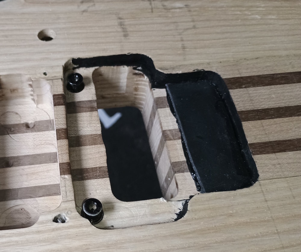

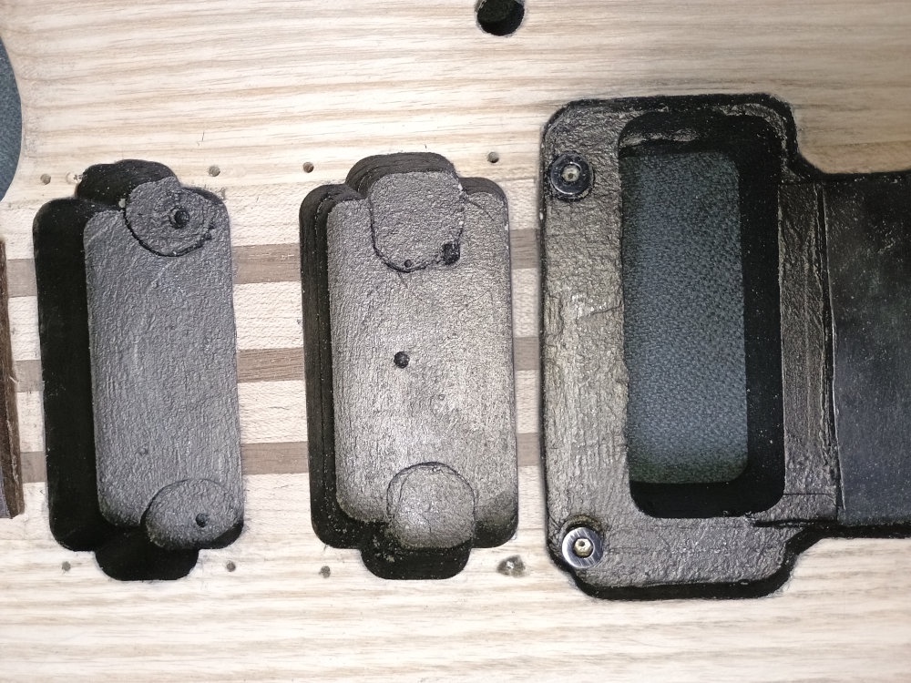

..had a nice holiday down south, then a busy week at work catching up on stuff that piled up when I was away!
Meant to post about shielding before I left - but time disappeared!
I bought paint & copper tape, wasn't expecting much from the paint but thought I'd give it a try!
The 'paint' even when dry has a 'graphite softness' so it's easy to smear. It will need sealing + some copper strips to mate with the cover plates
My multimeter test confirms that I have good continuity ! - so copper tape will go to the garden for slug protection.

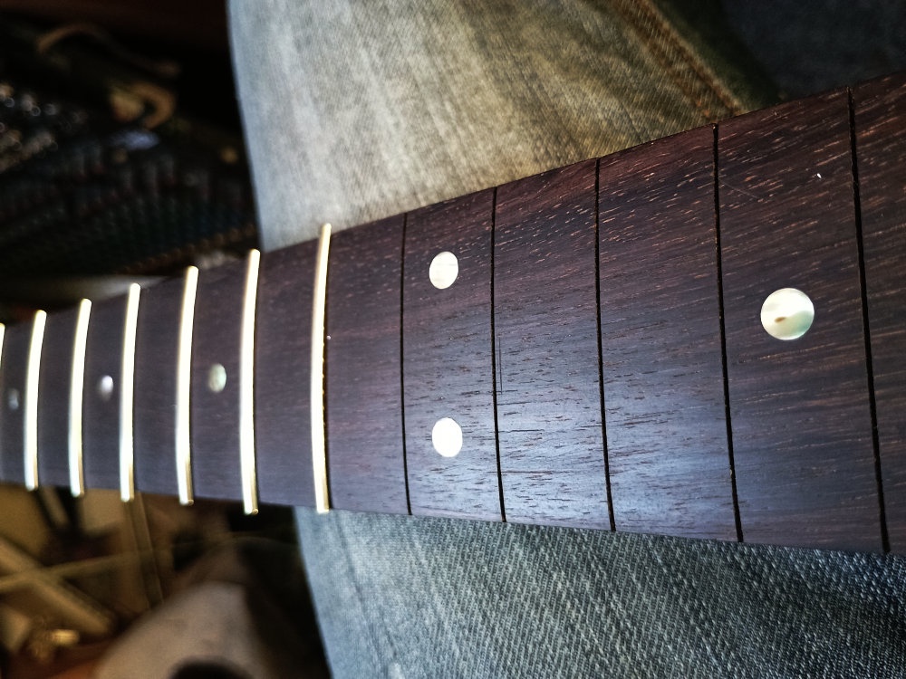

This evening I have mostly been installing frets!
The frets I bought were not radiused enough so I've been waiting weeks for a bender to arrive!
My 'spinal tap' moment "26 Frets - that's 2 better!"
Frets ends need trimming, dressing, then levelling & crowning, but feel It's starting to come together!

Don't forget to add the copper first, then mask the mating sections of the copper, then spray some clear to seal the graphite. It is messy stuff.
I always run wire (normally thin tinned bare wire) between the cavities to get a good ground path between them. Sometimes I use small screws, sometimes I just sandwich the wire end between two bits of copper tape.

I've drilled the holes between the cavities and was debating between trying to use paint to connect or add wires.
Thanks Drew!

Looking good JS. I found it really annoying with the fret radius - the precut ones were always too shallow, which is why I now buy long lengths of it and can bend it as necessary.
For me the neck was the best part, all the fretwork, markers and everything and is quite intricate which I enjoy.
