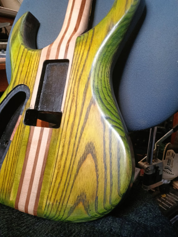

Re: Idiot tries to build guitar!
thanks for all the comments and suggestions!
Drew - I didn't trust the black dye I have, to work well enough for 'full burst', but I did use it on the edges has come out a dark brown which is OK
Garratendi - All hardware + pickups will be black
Wonks/ Kwak - I'm putting the strap button right on the point ! (I will use a slightly longer screw)
Jumpeyspyder wrote: ↑Mon Sep 22, 2025 2:54 pm Wonks/ Kwak - I'm putting the strap button right on the point ! (I will use a slightly longer screw)
Hmmmm. I can see the wood at the very point splitting quite easily.
If you really want to stick it there, then I'd round it off a bit and re-stain first.

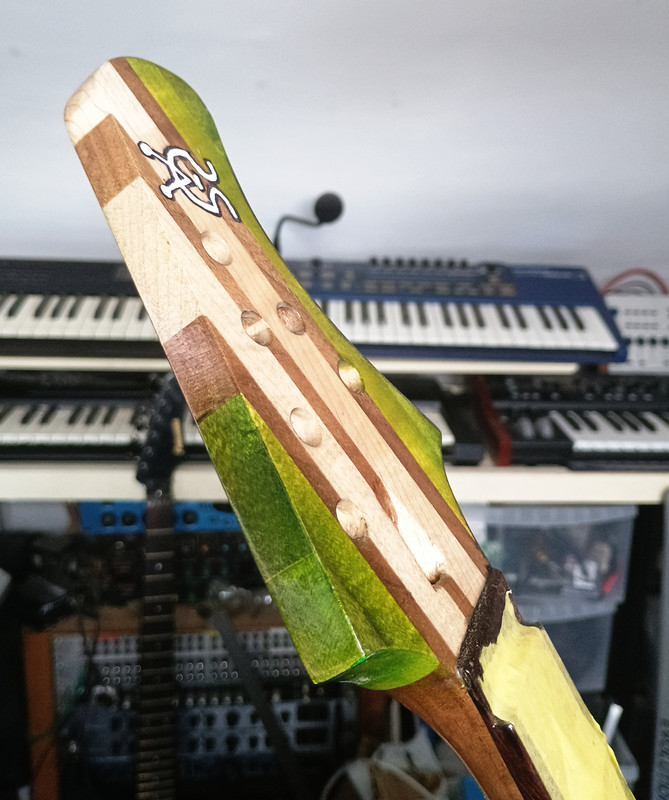

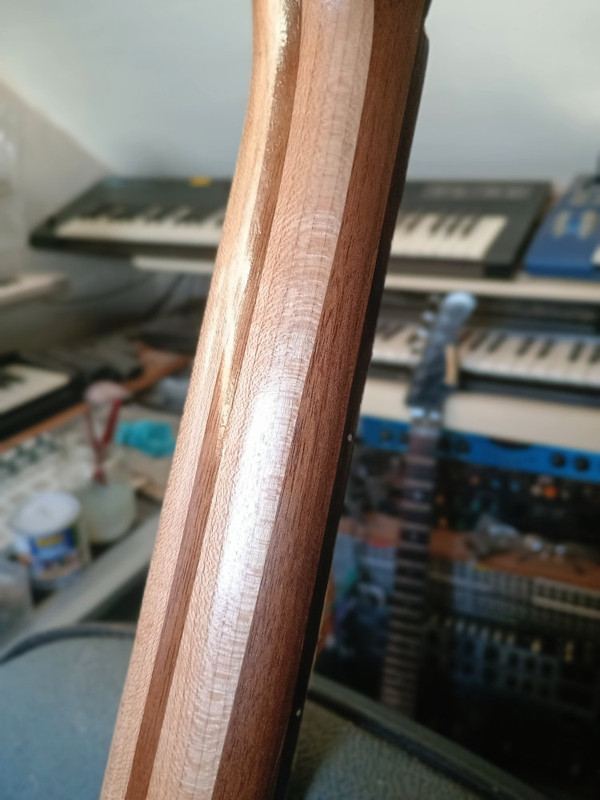

thanks Wonks & Telemaxis comments appreaciated
..So getting colour and finish at neck / body joint was problematic and also headstock colour would have too 'woody'. decided to stain the outer maple strips.
New stain not as even as I wanted. I did have an idea to mix a small amount of stain into the poly finish, I hoped it would help blend in some more colour, but some kind of reaction happened and the mix solidified into bright green plastic like lumps!
Really pleased with the headstock
Neck body joint finishing not quite how I wanted it - but happy enough after some touching up with a marker pen!
..so tempting to call it a day with finishing and just get all the hardware installed! Must persist and get back to 'varnishing'

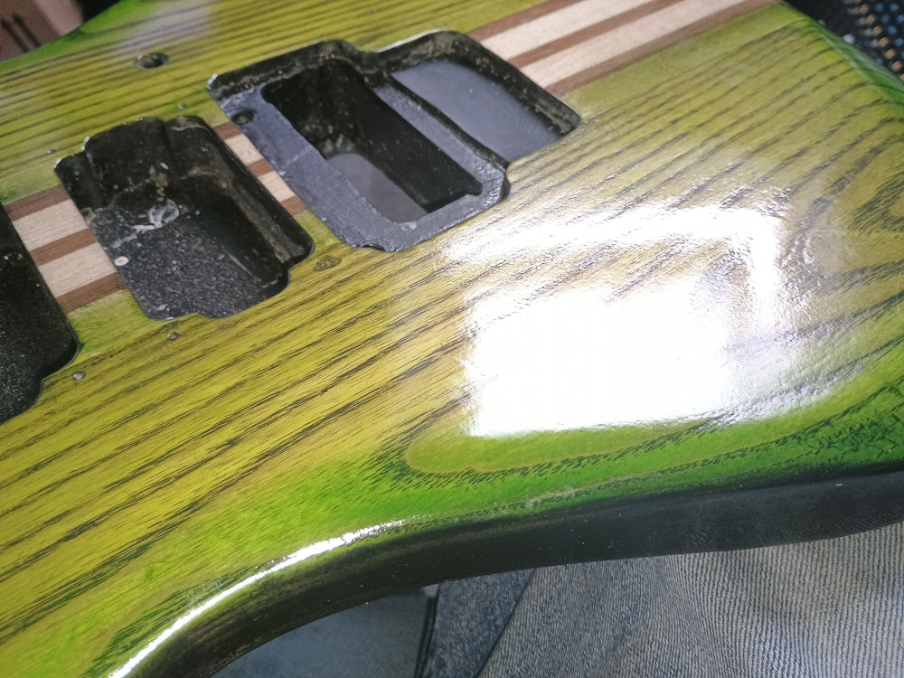

I guess I also need to do an update!
I've spent the days & days applying poly (I don't thing I enjoy 'finishing' so much)
I used a few light coats of 'U-Pol clearcoat' spray just provide a seal on the water based dye - worked well (But very sticky and probably hazardous so sprayed outside).
Then I reverted to layering up what turned out to be a water based poly.
No problem, but didn't polish very well:-
Not as good as the neck with just a few coats.(and no polishing)
So ordered 2 cans of U-pol, one can should be enough, but if it doesn't react well might need to scrape off all the water base poly and reapply!
Got a quite few coats of U-Pol done today waiting to see what it looks like tomorrow.
Also added a Headstock logo (by hand - I don't think you needed me to tell you that)
Gave it a few coatings to seal it - but sanded just enough to make it smear.

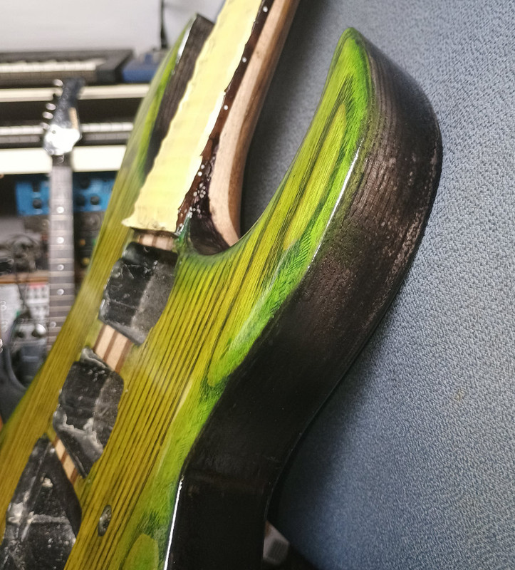

Finished, finishing last night!
Not perfect, but I've learned a lot - (when sanding the if there are any shiny bits left - its not flat enough!
I could add more coats and sand back again - but weather is against me and I'm happy enough with the results as a first attempt!
Next jobs - Clean up some of the mess from the cavities, file out overspray from inside machine head holes, install hardware & electronics, make cavity covers!
Getting very close!

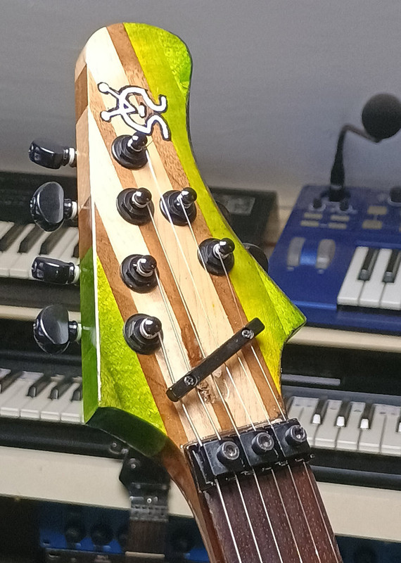

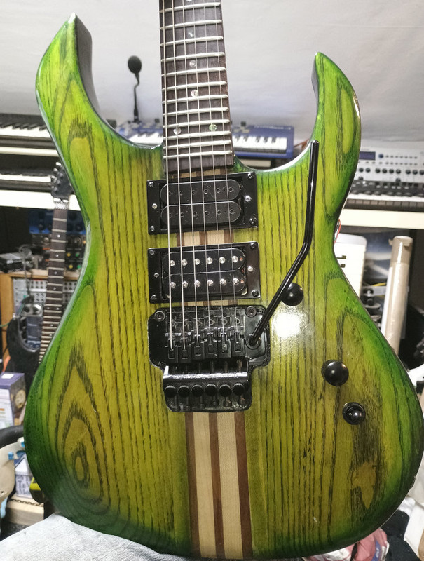

Hardware & strings fitted!
Glad it didn't explode into splinters with the string pressure!
Tuners fitted fine, but low E took a little fettling to make it work.(the headstock was slightly too thick due to the unplanned volute)
Some idiot seems to have fitted the string retaining bar and blocked access to the truss rod hex
Discovered what I thought was a Di Marzio bridge position (DP151) actually had DP159 stamped into the back = neck position!
Luckily I bought a cheap set of alnico humbuckers so just swapped around
FR copy Trem is not impressing me, fine tuners are not smooth and the assembly doesn't inspire confidence - will live with it for a while - maybe it will improve with setup - if not I might fork out for a schaller or a real FR.
Just soldering up the electronics, cover plates, & strap buttons to go!

DP159 is an Evolution bridge pickup (not neck). However you may have meant it’s a standard width, not an F-spaced one. DP151 is a PAF pro which is good for both neck and bridge (though again, there are standard and F-spaced versions).
The 159 has a significantly higher output than the 151. (400 vs 300 in DiMarzio output ratings).
The 158 is the Evolution neck pickup. Which is still a reasonable output at 298 output. I doubt it would sound quieter than the PAF Pro.
Wonks wrote: ↑Thu Oct 09, 2025 7:25 am DP159 is an Evolution bridge pickup (not neck). However you may have meant it’s a standard width, not an F-spaced one. DP151 is a PAF pro which is good for both neck and bridge (though again, there are standard and F-spaced versions).
Excellent info - I mostly use bridge pickup so much happier to use the higher quality pup in the bridge position, Thanks Wonks
