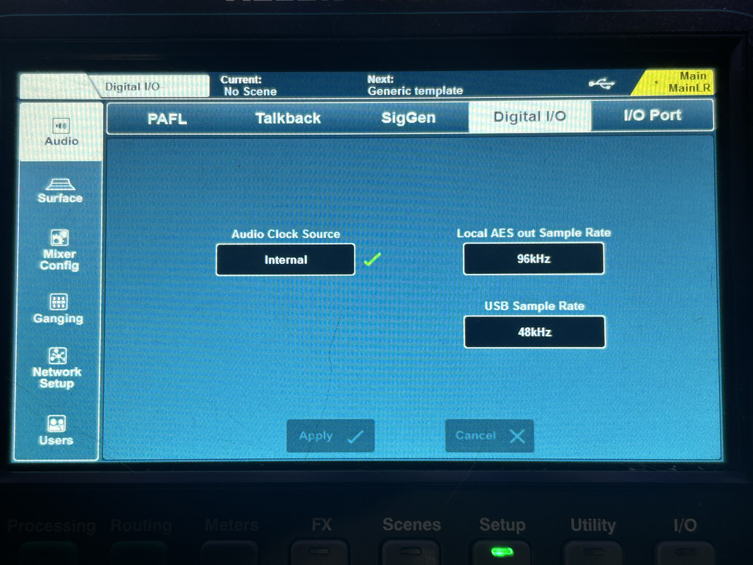

One thing you haven't told us in either thread - what sample rate is the SQ6 running at? You need to look at the desk itself - not what the computer says.

Hi
So it looks like its been 48k all the time on the SQ6.

I can't see where it tells you the internal audio clock frequency in that picture. I presume that it doesn't do sample rate conversion internally - or does it? Is it actually working with those settings?
I'm just wondering whether the mixer wants the USB interface to be working at 96kHz? WASAPI will sometimes do automatic sample rate conversion which is fine for convenience but not necessarily great for ultimate audio quality. ASIO usually passes data with no SRC so will only work when all the clock rates are matched.

Hi
I went thru the manual and didn't see any other places to view / set the sample rate than in the photo.
48k seems to be the standard for the SQ6, and lets keep in mind that the SQ6 works just fine with anything thats created on the BASEMENT PC, and that the issue I am having is only in relation to songs created on a different PC.

I believe the SQ6 operates at 96k internally, and SRC's when required to 48k for recording to a USB drive or when used as an interface.
I'd check the native sample rate of material created on the basement PC as compared to the other machine.
I suspect your ASIO machine was creating files at a rate the desk didn't like, and the WASAPI driver is 'fixing it' for you in a way ASIO can't.
The ASIO/WASAPI driver is part of the computer's own interface between DAW and sound card/desk connection. It's not part of the DAW... so the problem will be with the settings in your DAW, not the driver. WASAPI is just bodging a 'fix' for your DAW configuration error.

As long as you can get the latency down as much as you need without dropouts, it should be fine. I seem to remember having to use WASAPI on occasion.
As Hugh says, the pic seems to indicate that it's set to 48KHz via the interface.
