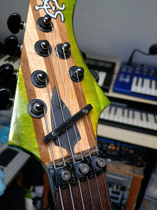

Some people might have spotted the position of the saddles on the FR...
Yep, looks like I was about 2mm out on scale length (I probably shouldn't have used a genuine FR template for a 'licenced' Floyd rose )

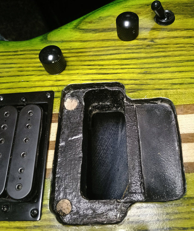

Made dowels from a chunk of maple (cut to square, planed to octagon, sanded to round ) and redrilled! not a lot of body meat- but wouldn't have got intonation without it - risky but drilled (Yes) 'close to the edge'

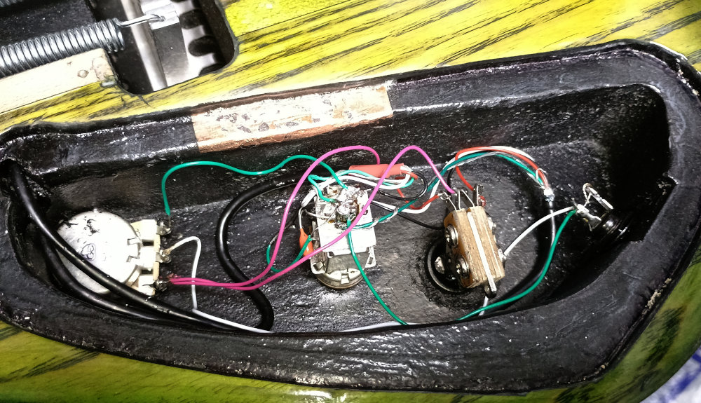

Wiring took much longer than I expected, originally wired the volume pot back to front so turning up actually went down - quick swap of signal and ground fixed it!
(noticed while posting the image - I've forgotten to ground the volume pot)
Now I have sound!
played for about an hour and really happy with the tone - cheapo neck pickup sounds great!
I have some buzzing on b string and some choking high on the neck - hope this will resolve with some setup work.

Congratulations Eddie, it must have been a big moment when you “heard” it for the first time. Did you have the volume turned up full (ie off!) when you first tried it? That would have caused a bit of panic, before the easy solution was found.

Would it not have been better to use the existing holes and bought a proper Floyd Rose? Cheap copies really are not worth it. They rarely use materials of the same quality as the originals, and the knife-edge bearings often wear out very quickly due to being made of softer metal.
Posts: 19207 Joined: Thu May 29, 2003 12:00 am Location: Freethorpe, Norfolk, UK

Not panic - but definitely a 'what the hell have I got wrong now' moment! :lol:

Wonks wrote: Sat Oct 11, 2025 8:27 am Would it not have been better to use the existing holes and bought a proper Floyd Rose? Cheap copies really are not worth it. They rarely use materials of the same quality as the originals, and the knife-edge bearings often wear out very quickly due to being made of softer metal.
Absolutely correct, but a real Floyd is more expensive, than any guitar I own!
I'll see how the cheapie works out - not sure the rest of the guitar is worthy of the additional expense!

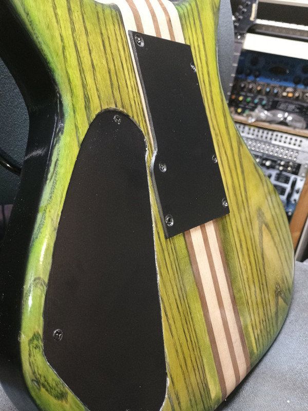

Cover plates done!
Took a lot longer than expected, possibly cheap plastic may have been a mistake?
It seems to want to melt, rather than file, or cut.
Took 3 goes to get truss rod cover (Will probably remake this again as I'm not 100% happy with it)
Rear covers not that pretty either, but no one will see, so not really a problem!
Making progress with setup, somehow nut was too low on B & E strings so shimmed with a slither of metal.
High E slipping out of the saddle has been a nightmare, now solved by bending into a V shape. (Never needed to do this before on other FR style bridges)
Action still a little high but it's playing better up the neck than a few days ago.
Small changes, bit by bit, and I think this will be playing OK! :thumbup:

Your truss rod cover is a nice design :thumbup:

For an "idiot's" build, I'd say this is top notch! I'd be happy buying one of these if I could. I also like the truss rod cover!
