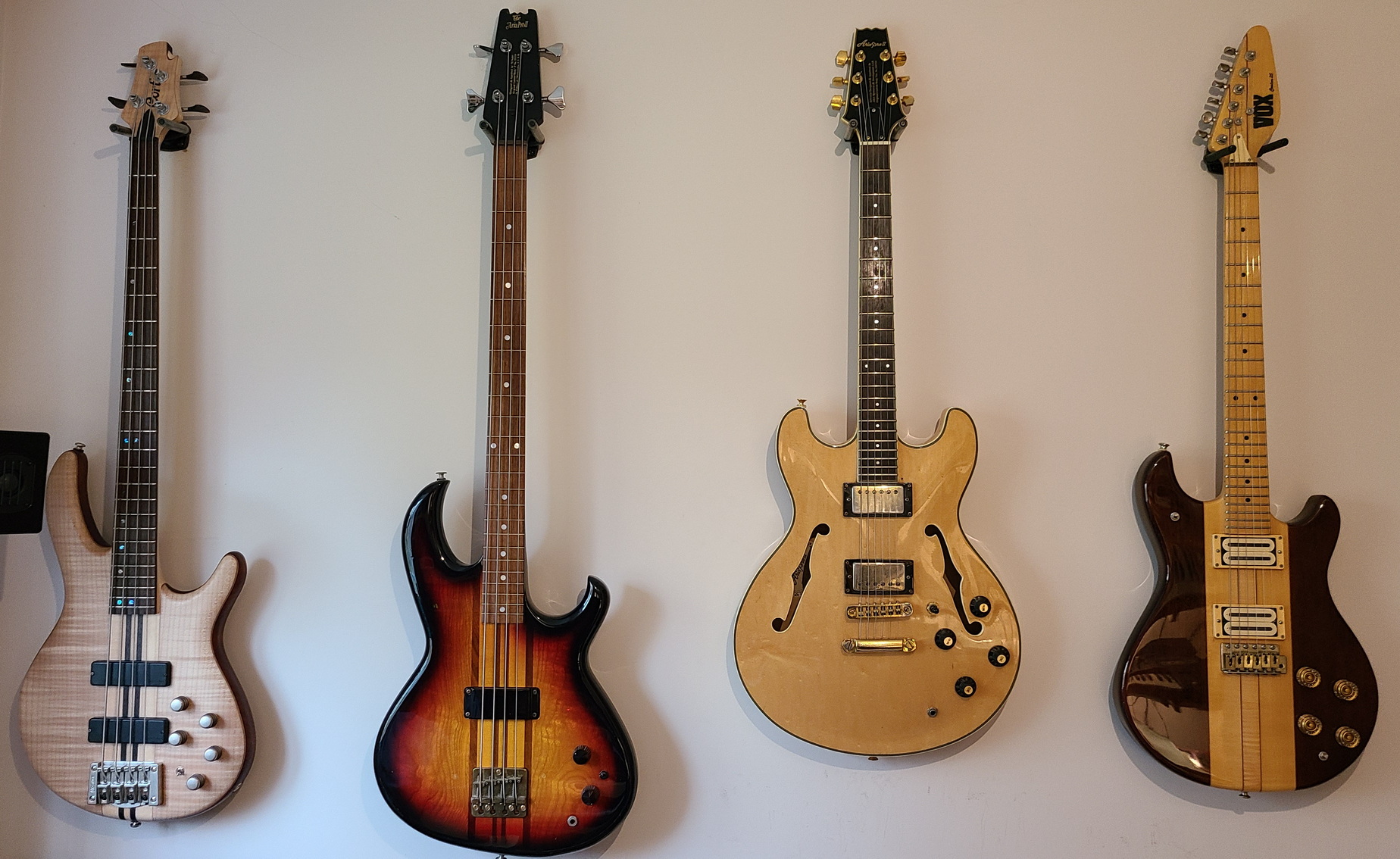

...the Aria Pro II Ta-65 turned up this morning and it sounds as lovely as it looks.
Of the guitars I have owned, this is definitely the easiest to play. What hadn't quite occurred to me, is that it joins two other Matsumoku guitars that I have had since the eighties, the Pro II SB-600/700(?) fretless bass and the Vox Custom 25. I may have to get rid of the Cort bass and replace it with a Matsumoku fretted bass (only kidding...).
Apart from showing off a bit, the purpose of the post is to ask a bit more advice. The Ta-65 is a bit dusty and mucky. I felt like I needed to wash my hands after playing it. What would anyone suggest to give it an overall clean and polish? I have orange oil for the fingerboard but would like to clean that as well, before applying oil.
There is a bit of scratching on the back where it has obviously leaned against a stand. Any advice on polish that might infill the scratches a little?
The pickup switch felt a bit loose but I twisted the toggle in until it felt firm and it works perfectly, no noise. The jack nut was loose but I hand-tightened it and is now firm, and holds the jack lead tightly, no contact issues. Will tighten a bit more later. The volume pots were a little crackly, but nothing awful. Is it worth prizing the knobs off and trying to get some faderlube down the shaft? Can't see any other way to get to the pots.
The intonation on the G string feels a bit off (1st/octave fretted and harmonic, but I want to check it with a turner). The saddle intonation adjustment for the G string looks to be set closer to the bridge than for any of the other strings, so I assume that would be the thing to adjust, with the string loosened off.
There is some loss of gold finish on some of the metalwork but I'm not really bothered about that.
Any thoughts on cleaning/tidying would be appreciated. After that it has to go into storage until Christmas!

Lemon oil or mineral oil (wooden chopping block oil, which is cheaper than lemon oil and is basically the same stuff without the lemon scent and colour) will also clean the fretboard. Just apply, leave for a while and then rub with clean lint-free cloths. Repeat until clean.
But if there's quite a build up of crud, I'd scrape it either with a woodworking scraper, or else a single edged razor blade (now used mainly for DIY purposes). the razor blade is probably thinner so easier to get right up against a fret and then pull it back across the surface until you reach the next fret. It's also a good way to remove small indents in the fretboard. Then add some lemon/mineral oil to the fretboard.
It depends on how dirty the surface is, and what you think is on it. Just a damp cloth can normally get most surface grunge off. Anything that won't come off easily should then come off with naphtha (lighter fluid). But to really polish it, I'd use a car finish scratch remover. If reasonably deep scratches, I'd start off with a medium scratch remover like T-cut. I'd then move on to a finer remover like Meguiars Scratch X2. And then I use a really fine scratch remover/polishing agent, normally Micro-mesh Micro Gloss.

Thank you, Wonks.
Are you saying lemon/mineral oil for the main body?
The finger board didn't seem too bad (as in needing scraping) but I will have a closer look.
Regarding cleaning, would you suggest taking the strings off and, if that is the case, replacing them? And, if that is the case, how would I know a suitable gauge? Vernier caliper on the bottom E, or is it just common knowledge (for knowledgeable people) what would suit a guitar like this? Apart from being a bit old and mucky, they feel like a good weight to me, light, very easy action, easy to bend.
Note your comment about the futility of squirting lube down the shaft of the pots. I'll give them a good spin. But I would be a bit terrified of trying to take the electrics out through the F-hole. Even more so getting them back in!

No, just oil the fingerboard. It will help clean the body but then you’ve got an oily body which you then need to get rid of. Better things for cleaning the body.

Thank you, both. Pardon me for asking dumb questions until I think I know what I’m doing.
No ambitions to become a luthier. It’s basically OK as it is, and I don’t want to mess up anything. I might be able to get stuff out, but I can’t see how, for example, I would get the jack, or the bridge pots, back into place.
White spirit to the body and neck, Andy? Will that just remove grease and dirt and not affect the nice varnish? And by polishing, do you mean applying polish of some kind, or just rubbing with a clean cloth?
Regarding the fretboard, Wonks, there is a little bit of crud either side of some frets. Back to my original question. Is it necessary to remove strings, or could I just loosen one side then the other? Or is it important to get access to the whole surface?

BillB wrote: Fri Nov 07, 2025 11:59 pm White spirit to the body and neck, Andy? Will that just remove grease and dirt and not affect the nice varnish? And by polishing, do you mean applying polish of some kind, or just rubbing with a clean cloth?
To paraphrase my late teacher Norman Reed...
White Spirit is what you use to clean wood for painting and painted surfaces, and lacquer and varnish are just posh paint. It is precisely the right thing to clean the surface and it's not going to do any harm, it's not an aggressive solvent so nothing to worry about.
I use kitchen roll with the White Spirit to clean the surfaces, then buff it dry with more clean kitchen roll and finish with a soft cloth like the classic yellow duster. And yes, by polishing I mean using a polish of some kind. It isn't really necessary.
BillB wrote: Fri Nov 07, 2025 11:59 pmRegarding the fretboard, Wonks, there is a little bit of crud either side of some frets.
The single edge razor blades Wonks described do a great job. Stanley knife blades are a very good alternative. And for gunk building up on either side of the frets wooden cocktail sticks come in very handy. Used with care they can remove a lot of that crud.
