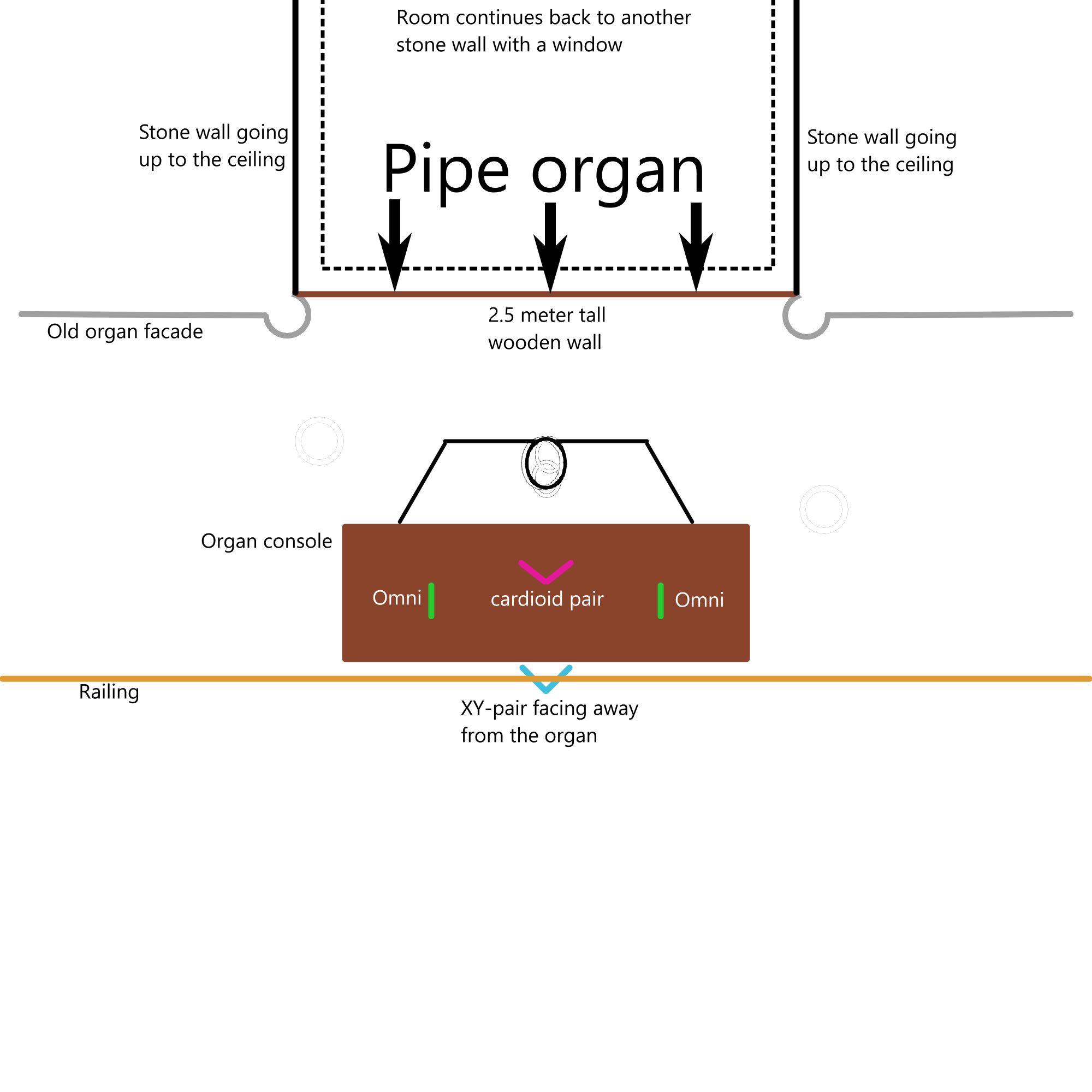

I made a layout of the organ loft and how I set up the microphones. Here it is:
The distance between the omnis, a pair of Neumann KM 183, is 64 cm. The distance between the cardioids, a pair of Neumann km184, is 17 cm and the angle between them is around 97 degrees. Both pairs are at around the same height as the top of the wooden wall. The distance between the microphones and the first row of pipes is around 2.5 meters. The XY-pair facing away from the organ is unfortunately a cheap mic-capsule, a Zoom XYH-6. I still think it did a pretty good job of capturing the reverb of the church, which was its purpose.
The recorder I used was a Zoom F8n.

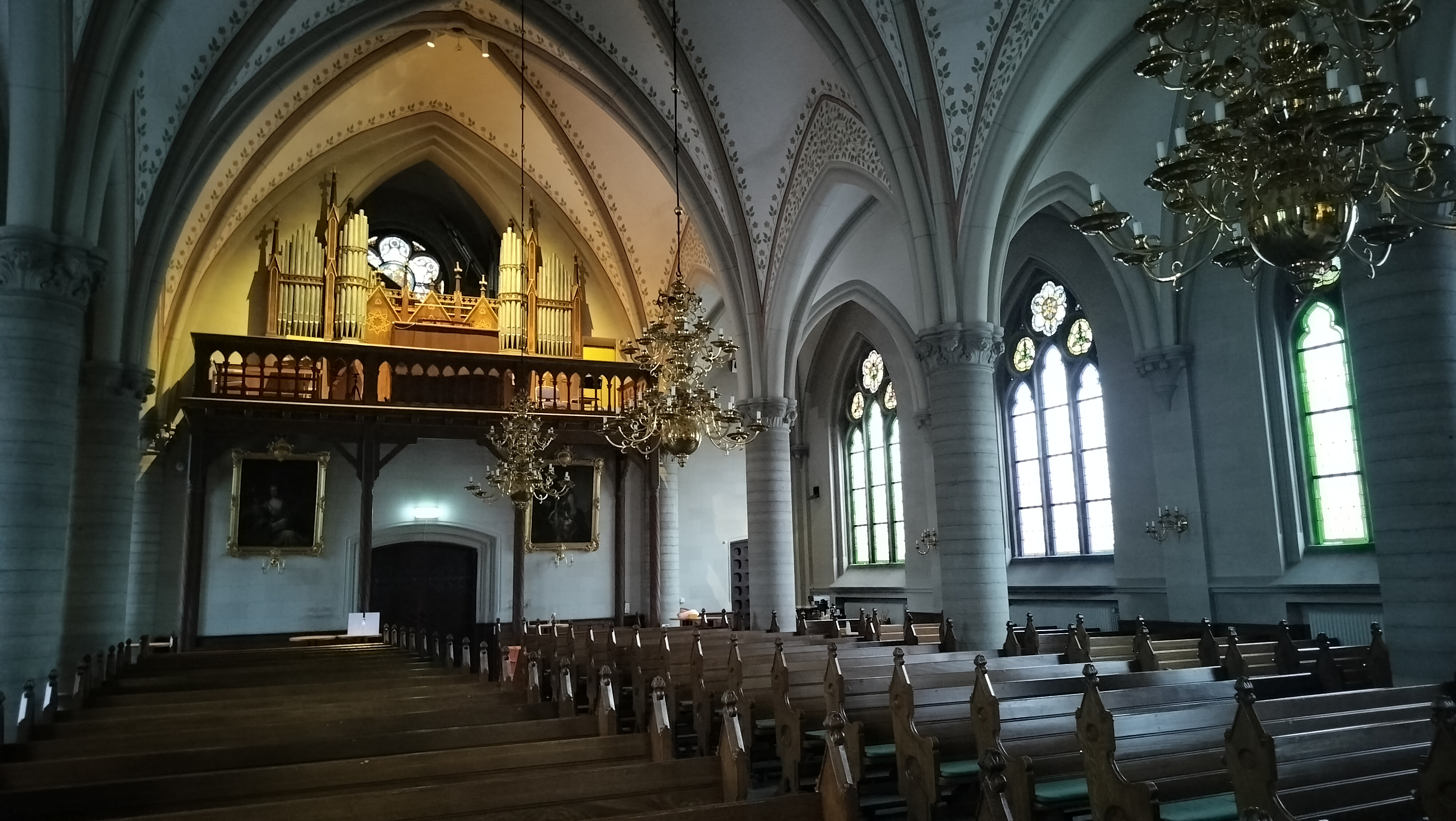

Here is a good look at the organ loft from a distance:
You can see that the sound from the organ goes between an arch and the wooden wall that I depicted before it fills the church.

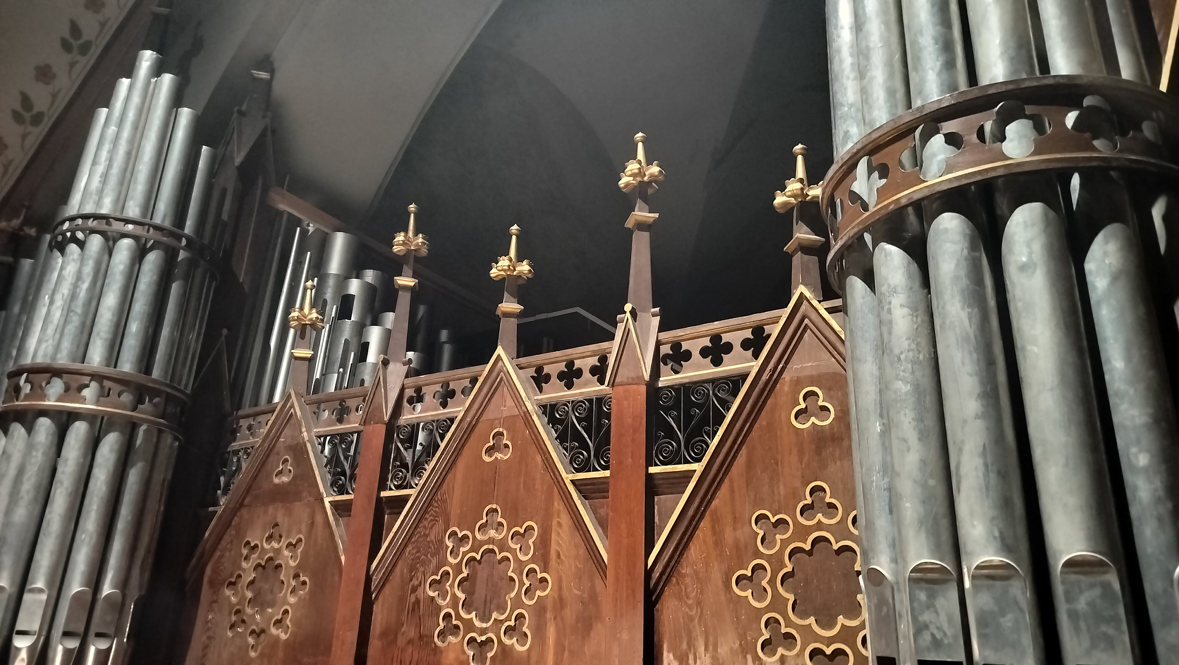

Here is a picture of the wooden wall:
You can see the longest pipes of the principal 8' sticking up behind the wall.

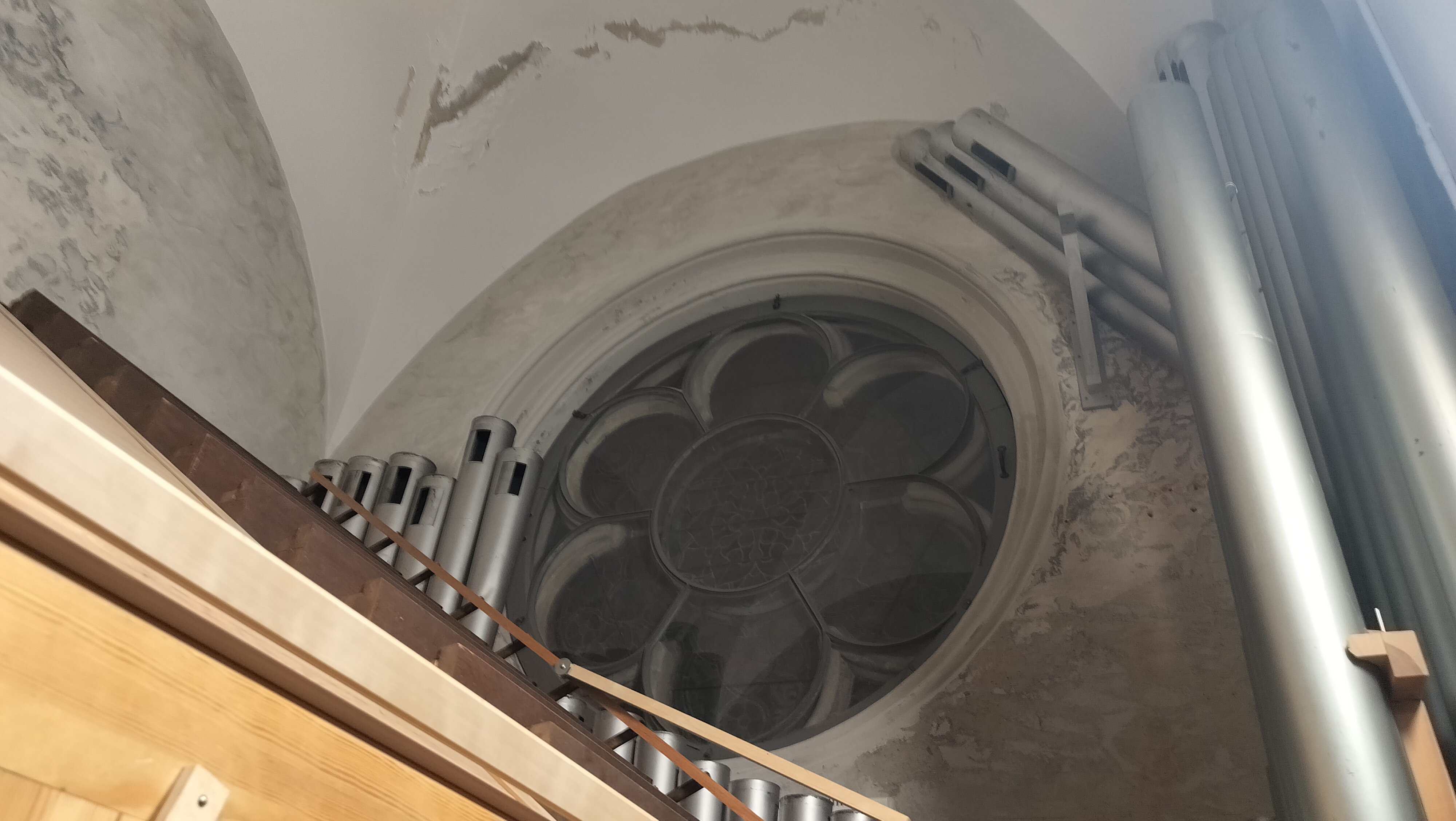

Here is a picture of the back of the room with pipe organ:
You can see that the longest 16' pipes had to be bent at the top to fit in the room.

the view of the organ loft from a distance:
https://drive.google.com/file/d/1LZZtrY ... sp=sharing
the wooden wall:
https://drive.google.com/file/d/1dFPC4y ... sp=sharing
the back of the room with the pipe organ:
https://drive.google.com/file/d/1y09fYg ... drive_link

And the layout of the organ loft:
https://drive.google.com/file/d/1yr1q8o ... sp=sharing

Your clip of the blower reveals constant tone and volume, it's when they change that blower noise becomes noticeable. When I turn the blower on, (if I'm not on a remote console), I hear the blower, then the sound disappears from my consciousness. The same here, where I wasn't aware of blower noise in the first recording from your sonata which was without removing the blower noise. (Both gave me hints of Paul Hindemith, by the way). Removing the blower sound may cause more problems than perceived gains.
The recording felt a little tight: it captured the sound of the instrument but not the space, but I am sure that Hugh, Bob, etc., will be able to comment on that as I am not a sound recording specialist.
Re: I recorded some of my organ music
Nazard wrote: ↑Wed Jan 14, 2026 7:50 am Your clip of the blower reveals constant tone and volume, it's when they change that blower noise becomes noticeable. When I turn the blower on, (if I'm not on a remote console), I hear the blower, then the sound disappears from my consciousness. The same here, where I wasn't aware of blower noise in the first recording from your sonata which was without removing the blower noise. (Both gave me hints of Paul Hindemith, by the way). Removing the blower sound may cause more problems than perceived gains.
You highlight exactly what I was thinking, and the stereo wasn’t very wide.
Not enough acoustic, where were you monitoring? Did you get someone else to play a sound check?
Just a thought, I like spaced omi's for organ, a couple of DPA 4006’s were our first port of call, they have a lovely bass, great for pipe organs.

Stereo image seemed plenty wide enough to me, but I agree that more room acoustic would be nice. It does sound like it was recorded at the console rather than in the body of the church.... but that's very much a taste/aesthetic thing.

First of all I'm not monitoring anything since I was playing myself. This is beside the fact that I have no experience in monitoring. I did not have anyone do a sound check. I did however do a test recording at an earlier session when I was practicing. I then tried a couple of mic positions and decided to use the one displayed above.
I agree that the sound could be a bit more reverberant. I turned down the level of the ambience pair during the mastering stage for some reason. I could turn it back up i suppose, but that means I have to do all the noise reduction (removal of click sounds from the pedals and keys) again, since I did the noise reduction on the final mixdown.
Anyway, I plan to do more recordings of my music in the near future (not only of organ music, by the way) so I will consider leaving the ambience pair at a slightly higher level.
The Km184's and the Km183's are very clear and articulate. I especially like the Km184's for it's ability to capture instruments in the alto/soprano range in a natural way. At the same time, I think both mics lack a certain spaciousness. I'm sure the DPA 4006's are wonderful. Unfortunately I can't afford them at the moment. My end goal some years down the line would be to get a contract with a record label so that the whole recording/mastering process won't eat up my time (or money). In fact, I'm willing to work with an experienced sound engineer right now. Though, that person would have to be aware that any income at the moment would have to be through split sharings from streaming sites.

guttenor wrote: ↑Wed Jan 14, 2026 5:40 pmI turned down the level of the ambience pair during the mastering stage for some reason. I could turn it back up i suppose, but that means I have to do all the noise reduction (removal of click sounds from the pedals and keys) again, since I did the noise reduction on the final mixdown.
Like all real instruments, some mechanical noise is expected (especially blower noise), and removing it will often do more harm than good.
Moving the mic array (which is basically OCCO) further down the church will not only capture the organ with more acoustic space, but also reduce distracting noises from the keys and pedals. It might reduce the impact of blower noise too.
Remember that organs are voiced to sound balanced to the congregation/audience, not the organist in the loft, so I'd always start experimenting with the mics that area first.

I think most of us do as hazard says and tune out the blower noise once we’ve heard it. It was quite an issue when I recorded the Conacher organ at Raunds to support the rebuild grant application but the various soloists were all happy enough with the result, as they were with the extensive editing I did to correct as far as possible the pedals’ tendency to give a short cipher of the adjacent note when the worn woodwork “felt like it”!
I had more trouble with the mike placement as it was hard to get a rich ambience, presumably because the church is a biggish but bare-ish barn. The corollary to that was that we did get good detail, a benefit with players like James McVinnie and John Robinson, both organ scholars at the time. Fortunately we recorded an initial CD with a good local organist who was able to give assistance with assessing the overall sound, so I went into the recitals with a basic technique prepared. Being a typical “box of pipes” instrument one side of the chancel (the right), I set the mics at an angle and worried. But as I say, all the players who let me know what they felt liked the sound. The first organist’s opinions were very helpful.
Yes, you are right. Most importantly, I think, moving back the omni pair and the ambience pair 3,4 meters would make for a much more spacious and reverberant sound. The problem that is I would need to find a mic stand that I can raise 7 meters into the air, but that's another story.
