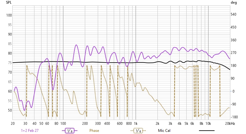

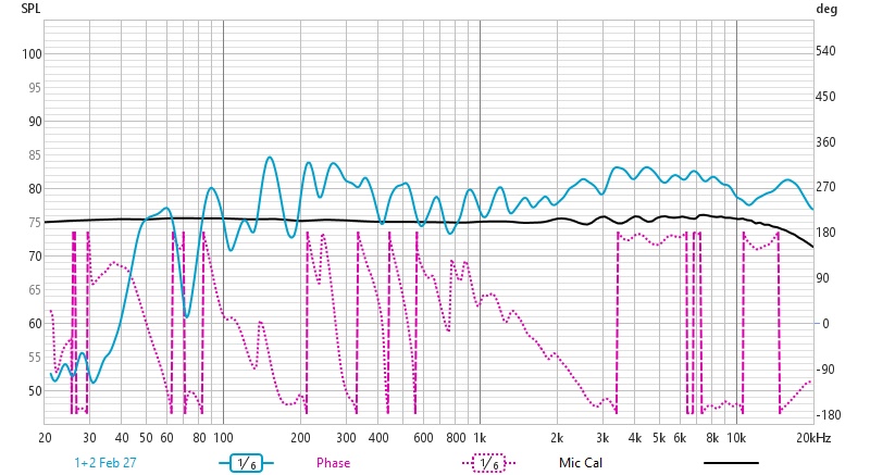

Hi,
I recently did a room measurement using REW to get a rough idea of how my speakers are performing in my room. I only had a Behringer ECM 8000 and the calibration file for this mic to use.
The first image shows my KH120's by themselves and the second is with the KH120's + the EVE TS108 sub :-
KH120's
KH120's + Eve TS108
I've been considering either changing my sub to the KH750 DSP or change my complete setup to a single pair of KH150's. Also, the new Palmer Orbit 11's look quite interesting.
I'm new to using REW and understanding what these measurements actually mean so would really value advice please.

Hi Richard!
Well my first of the cuff reaction would be that sadly, your sub doesn't seem to indicate any low end reinforcement at all - perhaps it would benefit from a higher output level, and/or different room placement.
However, apart from that large 80Hz dip (a typical feaure of most smaller rooms - mine's at 90Hz, and these can generally be flattened out by more bass trapping), your response seems to about +/-5dB across the rest of the range, which isn't too bad, and could relatively easily be flattened using software correction like the ubiquitous Sonarworks.
Do beware though that individual Behringer ECM8000 'measurement' mics can exhibit wild differences in response above 1kHz - borrowing a calibrated measurement mic would give you a more accurate picture of your high end.

Martin Walker wrote: ↑Fri Feb 27, 2026 1:50 pm Well my first of the cuff reaction would be that sadly, your sub doesn't seem to indicate any low end reinforcement at all.
Well... it's adding 10dB below 30Hz...
I'm not usually a fan of subs in small rooms, or any inadequately treated rooms. And it's clear that your sub isn't really doing anything useful — at least as measured in the mic's location.
However, if you're looking to upgrade, there is a fair argument of the KH750, since not only would that replace your existing sub, it would also add DSP correction to your KH120s.
And I'd think hard about some effective bass trapping — which you could install before splashing out on a new sub.

And the other thing to do is experiment with your sub positioning. The better you can get that before doing any kind of software correction then the easier that job will be.

Thanks for advice. I've started to try different filter settings on the TS108 and KH120's. I've found I'm getting a flatter measurement when the KH120's are playing full range without the 80hz hpf from the sub. The TS108 also has other filters that limit how high it goes. I have this set to 100hz.
I don't expect to sort the room modes out with DSP but it could be helpful to smooth out the peaks and dips.
If I went with the KH750dsp it would need to go under my desk where my existing sub is which isn't ideal. I've had a look at the REW measurements of my KH120's by themselves and I'm not sure if the measurements with the TS108 sub are a little better?
From a listening perspective the TS108 does make a noticeable difference. Bass does sound deeper and you can really feel kick drums and the overall bass frequencies sound like they reach a lot deeper though it doesn't look like this on the REW measurements

Try moving the measurement mic...

dickiefunk wrote: ↑Fri Feb 27, 2026 4:01 pm From a listening perspective the TS108 does make a noticeable difference. Bass does sound deeper and you can really feel kick drums and the overall bass frequencies sound like they reach a lot deeper though it doesn't look like this on the REW measurements
Well as Hugh pointed out, the sub does seem to have added a huge 10dB peak at 23Hz (I assumed this was a measurement anomaly, since the sub didn't seem to have reinforced/extended your response below 80Hz or so where subs normally do their thang).
However, if this is a true rendition of the measurement, then you will 'feel' kick drums more, but a sub that generates one-note frequency isn't doing its job properly.
