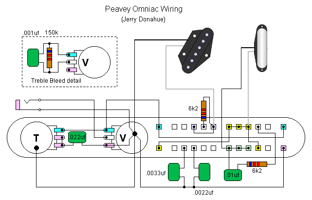

This has set me thinking about rewiring my P90 'bitsa' Strat. It has 2 x P90s with a three way PU selector, one tone and one volume pot and a toggle switch instead of the blend pot mod (which I have on my '61 style Strat). I might fit one or two push/push pots (I'm not a fan of push/pull pots), the tone one to bypass the tone control for sure and I'm not sure how to utilise the other. Maybe a volume control bypass for a quick solo boost? Suggestions anyone?

How about the Jerry Donahue tele wiring?
This is the Peavey JD Omniac version. You might want to tinker with the cap and resistor values but it might be worth a try.
Andy
