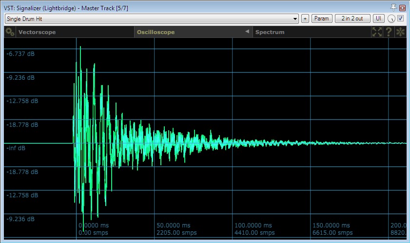

Here's a screenshot I've just taken of a single snare hit (for James ;) ), showing how well you can set up its triggering for a stable waveform in Oscilloscope mode (every time the snare hit happens, the waveform appears in exactly the same position on screen, so you can easily see how compressors, preamps, and saturators are affecting the transients of the waveform as you switch them in and out):

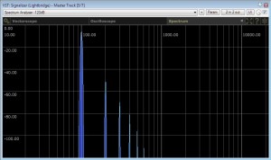

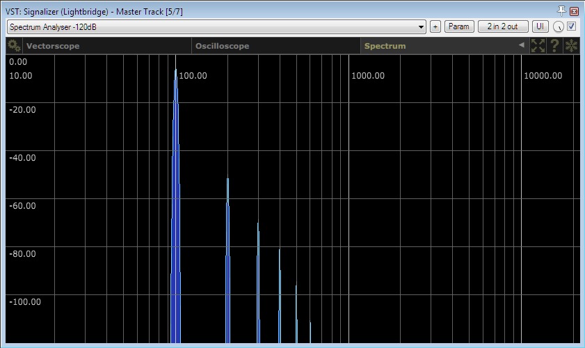

I also use its Spectum mode to show me the harmonic contributions of preamps etc. (here's Fuse Audio's VPRE-2C plug-in in action):

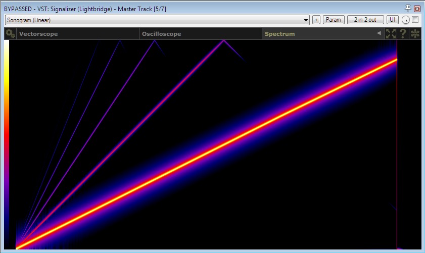

Spectrum also offers a Sonogram mode, which is perfect for examining harmonics and aliasing (here's the same preamp showing how clean it is):

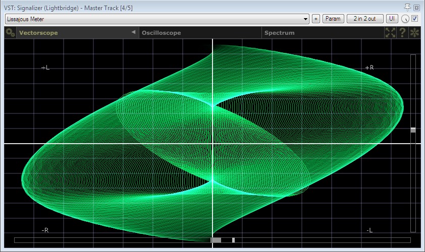

There's also a Vectorscope option to examine stereo phase information, which I've used extensively when examining the width & depth of chorus/flanger circuits (here's Arturia's JUN-6):

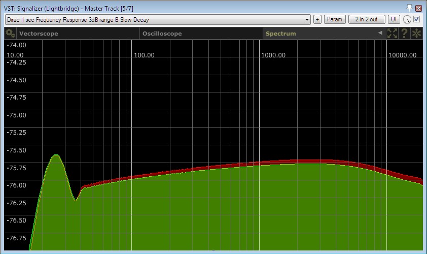

With a 1-sample length Dirac pulse as the input signal (freely available online) Signalizer's variable persistance trace means that you can capture stereo frequency responses (this is True Iron):
Now that's looking fairly sophisticated with variable trigger position too. If I needed that level of control then I'd normally have to get out a real oscilloscope. Looks like I'll have to download this...
