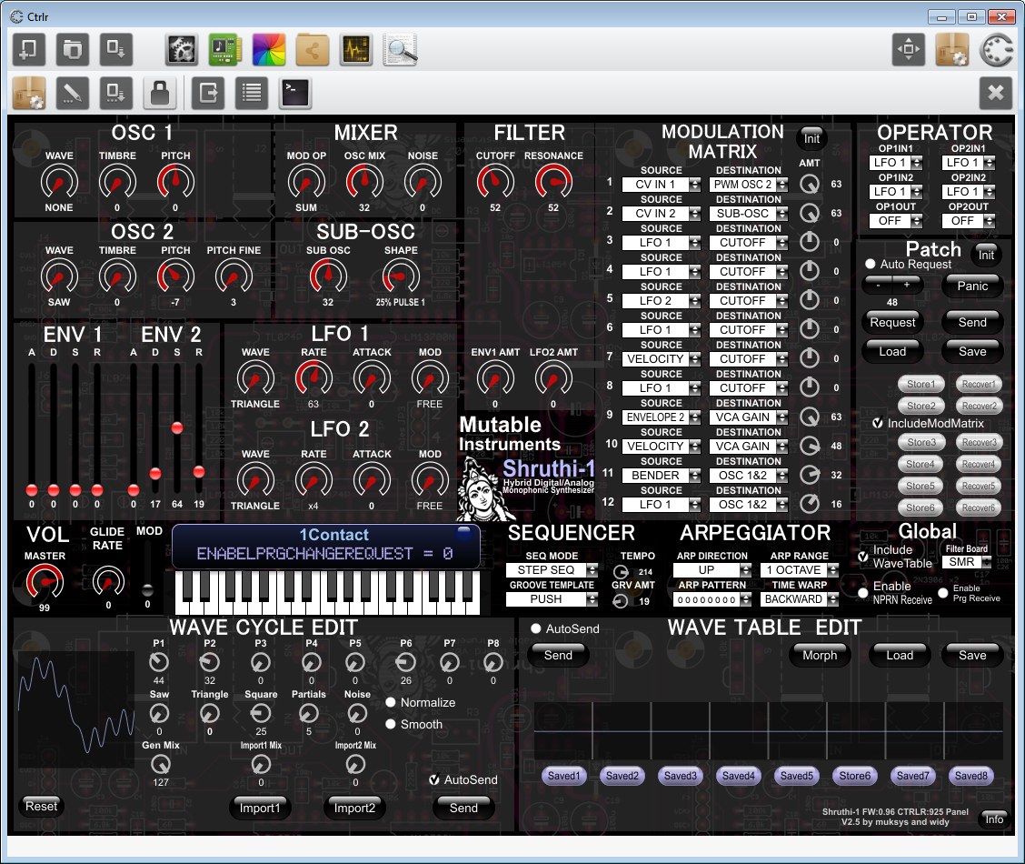

n o i s e f l e ur wrote:There's always ctrlr;
https://ctrlr.org/
^ To handle the SYSEX, mappable to any touch interface.
Oh, that looks EXACTLY like the sort of thing I had in mind.
I don't think it existed last time I was looking.
Thanks very much for the tip!

I looked at it briefly but wasn't sure if it's designed for touch and especially multi-touch.

No problem, glad to help.
As mentioned by Agharta, it may not be multitouch-capable, but for what you've said it's for it should suffice. Oddly, I didn't even consider it as a touch interface in itself but it ought to at least respond to single-touch and for simple sysex editing of parameters that's basically all you're going to need I'd imagine. It's not like hardware MIDI is designed to accomodate vast volumes of realtime sysex anyway.
I should really fire it up on the old touchscreen laptop here and test it for touch just for laughs! Will mean re-enabling the touchscreen but that's no biggie.
Another benefit to this over something like Lemur is it uses an actual scripting language (LUA), so any time spent learning that might have wider application - versus whatever application-specific abomination Lemur interprets.

I've used a Ctrlr editor for some years now with my steampunk Shruthi synth, and it's wonderful.
However, my experience also is that when working with existing editor templates, the version of Ctrlr you use can be crucial - in fact, so many people had problems trying to get the Shruthi editor to work with more recent builds that I've ended up hosting the particular elderly version it needs on my web site so that other Shruthi owners can download it

Yeah, that's a very good point Martin. I was lucky in that the panel I was most interested in seems to work fine with the current version.
Generally speaking I think it pertains more to the GUI scripting side of the app, so any existing panel that doesn't work can always be cannibalised for sysex formatting at any rate, and applied to a new panel of your own devising.

Hey, just following up on this to ask how you got on?
From my own testing it doesn't appear to respond to multi-touch, and in fairness I wasn't expecting it to - but it does work adequately well in single-touch mode, as an FYI to anyone reading this and interested in a solution.

Okay, I need to post a correction!
Further testing reveals it DOES actually respond to multi-touch - great news for those that want a more realtime performance capability.

I hate almost everything about MIDI Designer, from the confusing tabbed page layout, to the absolutely impossible-to-understand design saving, loading and sharing system. I feel as if I need to completely re-learn it every time I fire it up. I truly wish they could simplify it, and give it some prettier controls. I think that a large part of the trouble I had getting going with MD is that the web page seems to assume you already know everything about it before you even start. I've tried to show others how to use it, but within minutes they are utterly stuck.
TBH I really wish that another software designer would come to the rescue and create a more friendly piece of software with the same capabilities.
But the end results work really well, and nobody else is going to create me an editing panel for some of the obscure bits 'n' pieces I use.
It's been a while since I needed to create a sys-ex control, but I don't recall it being anything more onerous than any other control.
Re: A Windows-equivalent for Hexler's TouchOSC
The Elf wrote: TBH I really wish that another software designer would come to the rescue and create a more friendly piece of software with the same capabilities.
You make it sound almost as difficult to use MIDI Designer as it would be to create an editor from scratch using something like Visual C++.
Posts: 16991 Joined: Mon Sep 10, 2001 12:00 am
The Elf wrote:I hate almost everything about MIDI Designer, from the confusing tabbed page layout, to the absolutely impossible-to-understand design saving, loading and sharing system. I feel as if I need to completely re-learn it every time I fire it up. I truly wish they could simplify it, and give it some prettier controls. I think that a large part of the trouble I had getting going with MD is that the web page seems to assume you already know everything about it before you even start. I've tried to show others how to use it, but within minutes they are utterly stuck.
Heh, you've summed up my feelings toward Lemur pretty well there!
Regarding MD, I looked at the documentation briefly just to get a feel for how easy (or not) it would be to create the sorts of complex stuff one can in Lemur . . . but it didn't look to be the case. In fact the documentation made it seem a bit complicated to do fairly simple stuff. That said, it's probably *still* less onerous than programming Lemur.
Well, Lemur "scripting" gets close to "real" programming once you move beyond the basics of throwing a few controls onto a page and attaching / targetting some MIDI / OSC. I definitely think the time spent on mastering the damn thing for those who aren't already programmers would be more profitably spent on learning C++ . . . and I've seen many actual programmers express a lot of frustration with Lemur - as being as hard to learn as a real language but without the capability of one, and badly let down by archaic limitations in the runtime. Oh, and the booby-traps present in the editor app.
Oh, it's not hard to create a sysex control in Lemur. The issues people were having was in creating full-fat sysex editors, capable of sending and receiving patch (bank) dumps etc.
So that gives you some idea of the ambition and scope of what can be attempted. It's just control over timing and having to construct data-structures out of 2D arrays etc tended to hobble these attempts.
