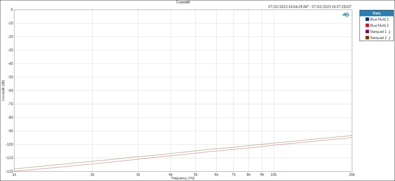

I would also be interested to know if the crosstalk of the stereo cables was acceptable?
I measured -96dB at 10kHz, reducing to around -102dB at 1kHz on a 25 metre cable run. So definitely perfectly acceptable. (The x515 residual crosstalk is -136dB at 10kHz, so this is real measured cable crosstalk). I'd expect cat-5 carrying balanced audio to be about the same.
I've used starquad for stereo mics on 3 metre runs from a stereo dead cat on a stick into a shoulder recorder many times without any problems. But I was slightly nervous about a long 25m run — hence the AP tests. I need not have worried!
I have to go to my 'man cave' near town to retrieve my long two-pair multicore cables (with separately screened and insulated pairs) to see how they compare. I'd expect less crosstalk, but probably not that much lower. I'll report back once I've tested it.

As promised... a visit to the man cave to retrieve my two-channel multipair cables for a comparison:
There's a small difference, as expected, with the multipair cable (separately screened twisted pairs in separate jackets within the outer sheath) having no more than 2dB lower crosstalk across the range 1kHz to 20kHz compared with the Starquad cable (using opposite wires for the two pairs). Both were 25metres in length.
Not surprisingly, I found the destination impedance affects the measurement. The figures quoted in the previous post (-96dB at 10kHz) were with the AP test set presenting its default 200k Ohm load impedance. In this graph I used the 600 Ohm option which is a closer approximation of a typical mic preamp and gives about a 3dB better crosstalk figure overall. So we're looking at roughly -99dB at 10kHz for the Starquad, and -101dB at 10kHz for the multipair.
Starquad costs half as much as the multi-pair cable for a given length! So it's a no-brainer to use starquad for balanced stereo audio cable, at least for lengths up to 25m... unless you need to break out into separate tails in which case the multipair wins hands down for ease of construction.
Hope that's of interest.
