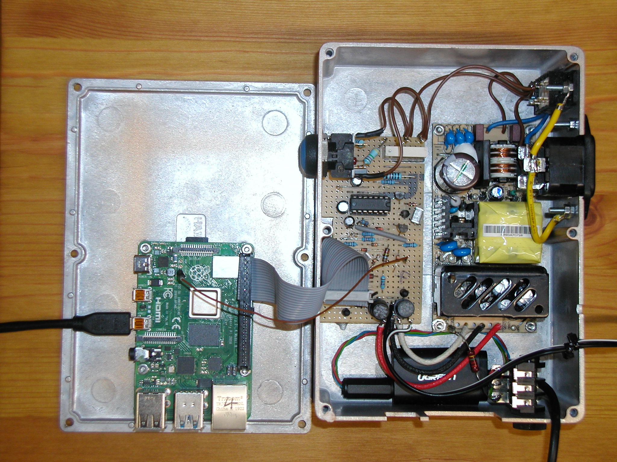

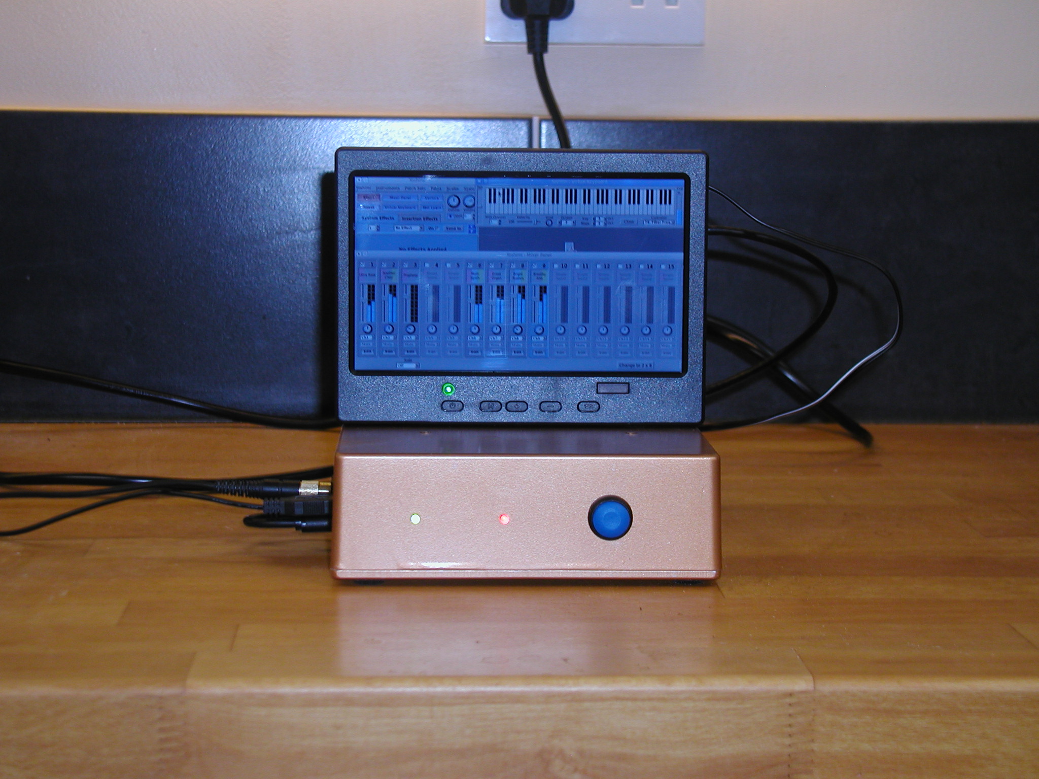

Well, YP 004 (copper) is now complete and assembled, tested, running on soak and waiting for a home.
Here's a look inside. As you can see, the layout is quite different to the earlier ones. It makes assembly a lot easier, gives more airspace above the Pi CPU, separates the mains area from the rest better, and allows the power control PCB to be made longer if more features are added.
This missive wouldn't be complete of course without a veiw of it's running copperyness

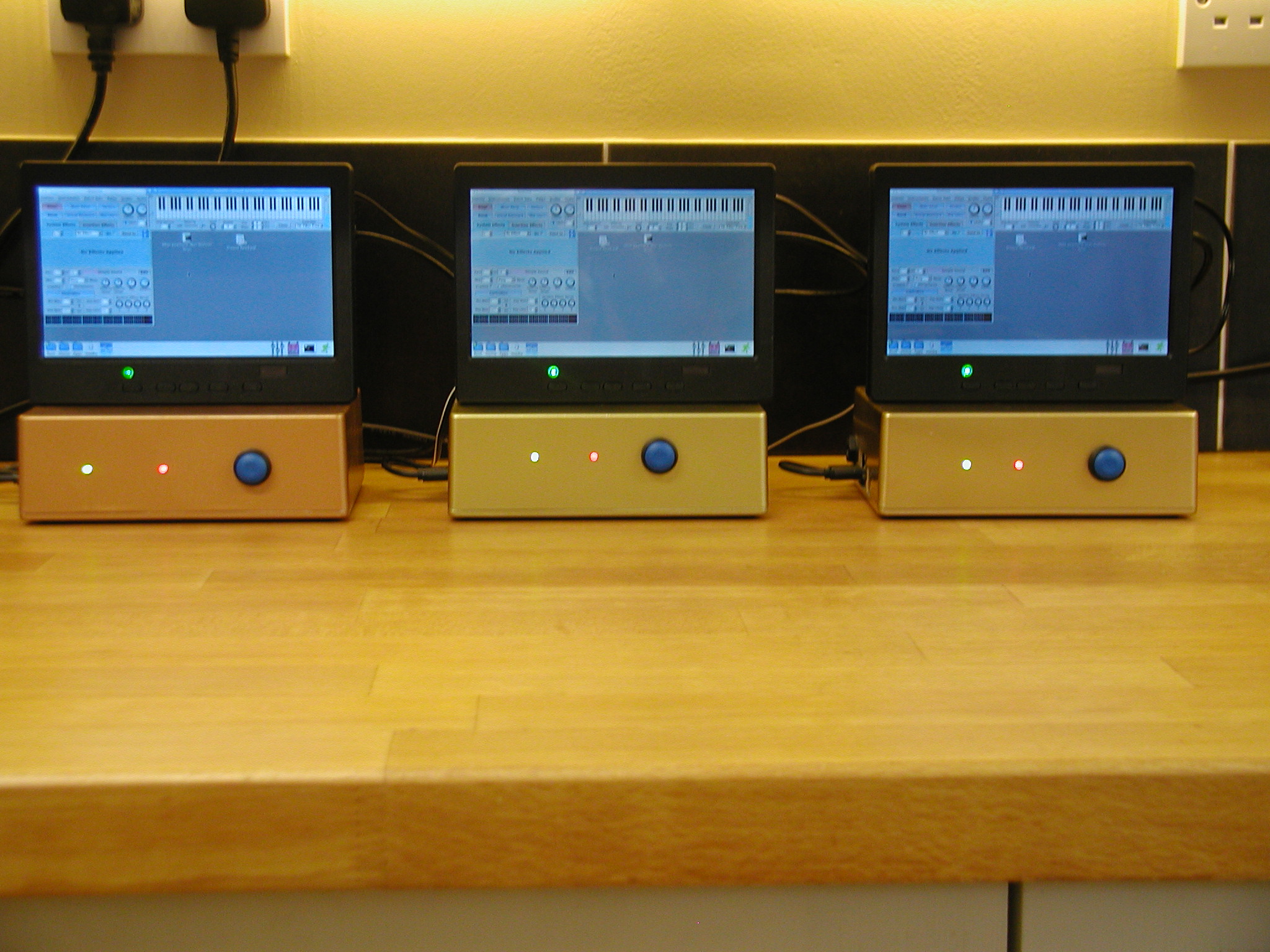

And Then There Were Three
006 was being a bit difficult and had to receive 'correction' and 007 took longer to dry out than expected
but they are all in line now, as you can see here.
I had to turn the flash off otherwise the screen displays were just about invisible. This of course screws up the colour, but left to right they are copper, brass and gold.
