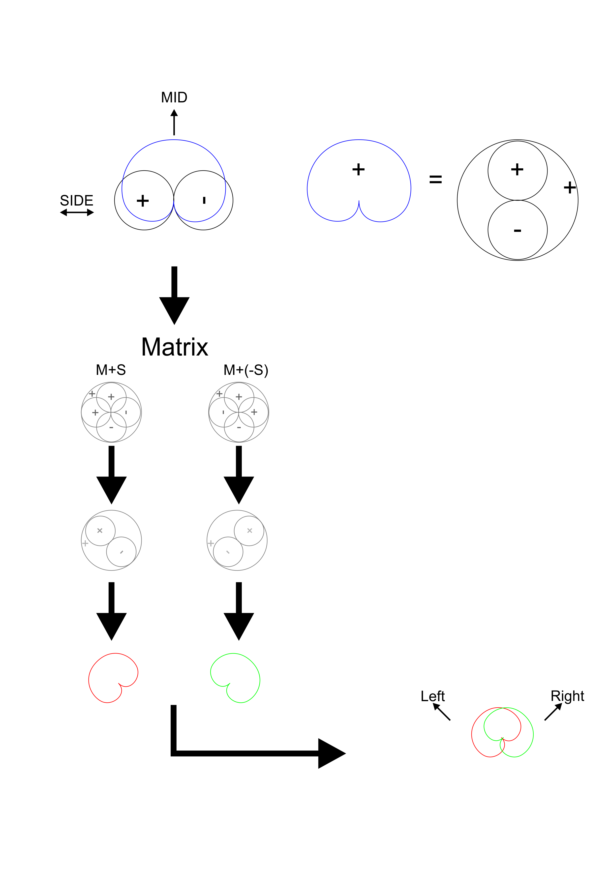

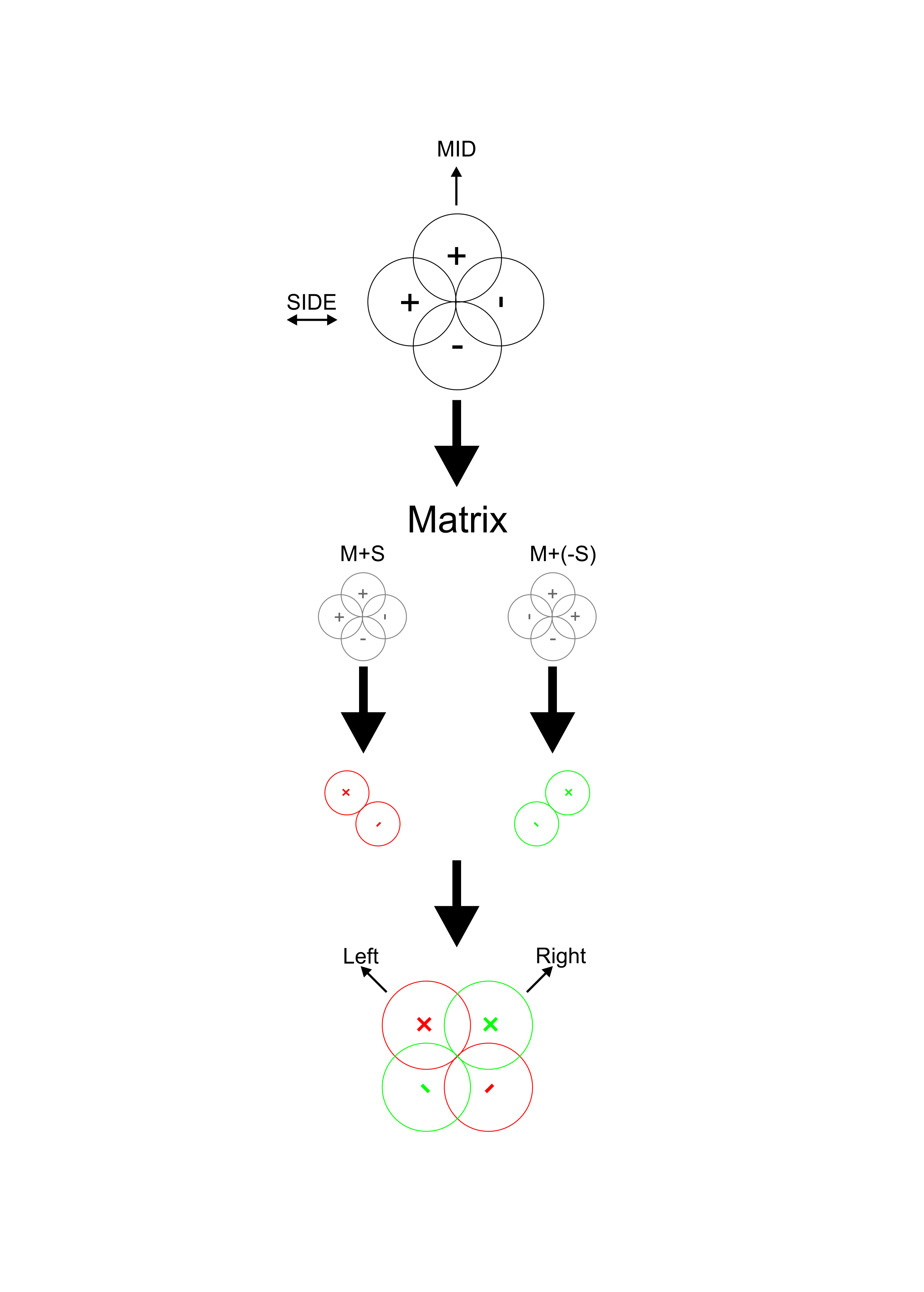

Here are a couple of diagrams to illustrate the way the sum-and-difference matrixing (that you might create using duplicate panned Side channels and polarity inversions etc, or an all-in-one plug-in) work, but by thinking about how the polar patterns of the Mid and Side mics are combined in that matrix decode process to create 'virtual' left-right microphones.
This first example is with a fig-8 as the Mid mic:
And then with a cardioid as the Mid mic (remembering that a cardioid comprises equal fig-8 and omni components):
Hopefully that will help with the comprehension of Mid-Side conversion
