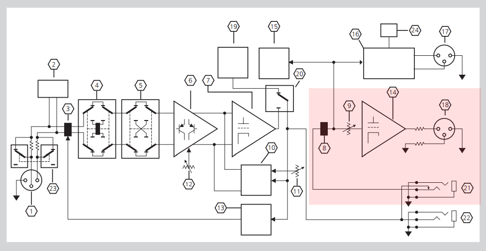

There is indeed an insert point that seems to include the tube stage as well the limiter before the signal hits the AD converter.
The first stage is a class “A” PNP ultra low noise variable gain differential amplifier having a gain ranging from -3 to 41dB. The second stage, directly coupled to the first stage, is a patented “Reflected Plate Amplifier1” differential tube stage with a fixed gain of 21dB. The combination of these two stages provides a novel and unique front end yielding from 18 to 62dB of gain.
I am almost sure the impedence will play a role as the signal reduction in order to bring it to the mic level. Surprising the preamps is extremely quite for it having a tube stage.

Since you have an insert after the transistor first stage, you should be able to inject signal in at that point with no fuss, though it's likely to be unbalanced. It would help if you gave us the make and model of the device

I have checked the very comprehensive user manual for the Aphex pre amp and had a look at their description of the "Reflected Plate" amplifier circuit. The latter is ingenious but I am not sure it is really revolutionary? Better valve techs than I could comment?
The Burr Brown+ Jensen transformer pre amp is going to give very clean results whereas the Aphex has both a THD and IMD specification at least an order worse than a top line, fully solid state pre amp. Yes! Even one with those horrible chips in it! It is no surprise to me therefore that the two pre amps sound differently under critical listening conditions.
I am rather surprised that such a complex and expensive pre amp does not have a high Z input. Almost any guitar pedal, NOT of the daft "true bypass" stamp and using an op amp, not FET buffer stage will be more "transparent" than the Aphex IMHO.

It's a good preamp. And -- as someone enquired/suggested earlier -- it does have a line level insert point with the return signal passing through one of the valve stages in the preamp before hitting the converter. So that is another option which is open to you to get some valve colouration in the preamp without having to smash the signal down to mic level and back again. Just adjust the output level of your source carefully to avoid overloading the preamp converter.

Hugh, the signal diagram for the pre amp shows that insert is post the front end and one of the valve stages that give this "reflected" plate malarkey.
Presumably this is what the OP is after?
Re: Line to mic conversion
ef37a wrote:Hugh, the signal diagram for the pre amp shows that insert is post the front end and one of the valve stages that give this "reflected" plate malarkey. Presumably this is what the OP is after?
Presumably so, and the block diagram also shows that there is a second reflected plate stage in the signal path from the insert return (shaded in pink in the diagram below).
I have no idea whether this single stage will provide the colouration the OP seeks, but it is probably worth some experimentation to see...
