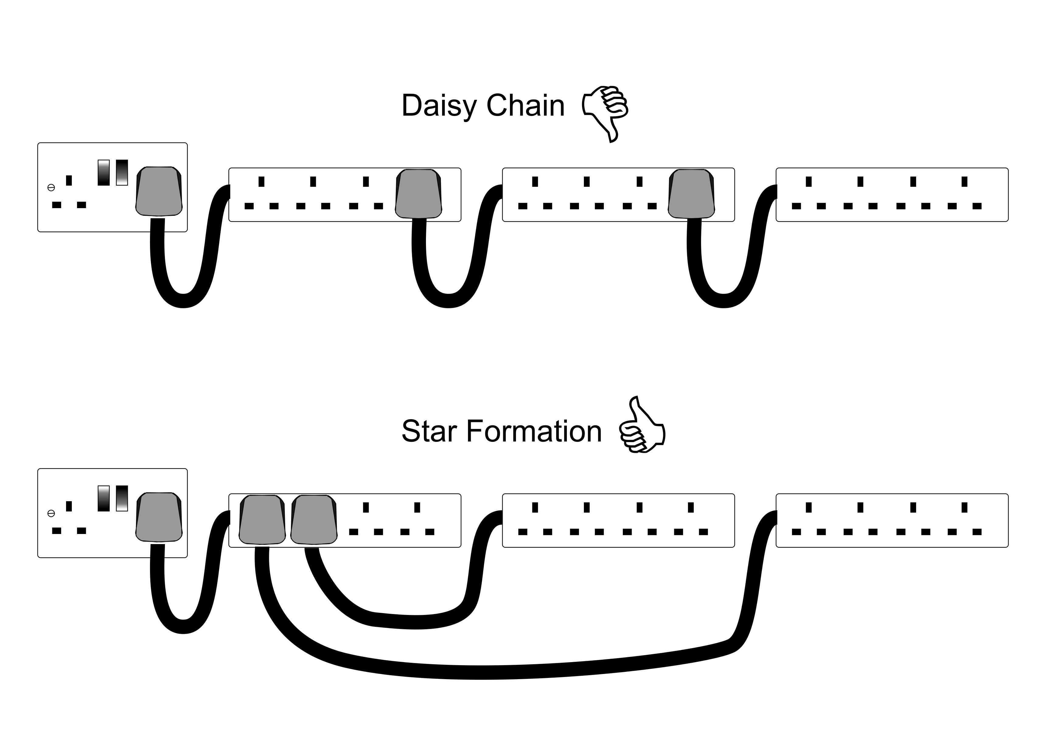

Hi everyone,
I'm new to this forum and this is my first post.
I have been reading articles on this website about powering all kit from a single dual wall socket and I have to say I am confused. Articles I've read here recommend a star formation with extension leads is a way of avoiding ground loops, but elsewhere on the net I've read that plugging extension leads into other extension leads is dangerous. I understand the concept of overloading wall sockets and what may happen as a consequence which is fine, but the star formation as I understand it is effectively 'daisy chaining' albeit in a different way.
Am I missing something here; can someone explain the 'star formation' and its practicalities.
Cheers

Hi Neil and welcome.
The reason for running all the gear back, ultimately to a single wall socket is so that there is but one mains earth path. Discussions about earth loops etc can get complicated but having a single power point is the best first step.
Safety. I know electricians do not like an 'extension into an extension' I am not really sure why. If the primary extension is of the proper current rating and properly fused I can see no problem. I do agree it looks messy so maybe Sparks as a breed are OCD tidy?
All that said, DO buy quality products. The £3.99 six ways from Rock Bottom are not recommended. Look at CPC and others. The diss strips that get fitted to network cabinets are of excellent quality. If you feel qualified you can buy the strips and fit custom length cables. Avoid if you can strips that are touted as 'surge supressed and filtered' They rarely are needed in UK, do no good that I can see and can, in some circumstances, make ground noise worse.
Lastly, do not worry about loading and safety. Even a very big studio rig would not come close to the 13A limit. (that excludes things like lights, heaters or 2kW power amps!).

BH12neil wrote:...but elsewhere on the net I've read that plugging extension leads into other extension leads is dangerous.
Lots of things in have the potential to be 'dangerous'. The trick is to gather knowledge and understanding to enable you to minimise or mitigate that danger. And with the best will in the world, the Internet isn't always the most reliable reference source!
As a general-purpose, arse-covering, rule, that standard advice is to avoid running one extension board from another. However, the reason is really only to avoid accidentally exceeding the current rating for the board's internal wiring and external cabling.
If you know the plug-board is built to a high standard, and you know the current demands of the intended installation, and allocate those loads to plug-boards appropriately, there is no risk. And in the case of a typical home studio, the total power loading -- and hence current demands -- will be way less than the roughly 3kW limit for a single wall socket / plug-board.
So, assuming you are using decent quality plug-boards with well-made socket contacts and switches, there really aren't any safety concerns at all. Obviously, though, the plug-boards should be fitted with the appropriate gauge of mains cable and fuses, but any reputable brand will be... (by law)
Also, don't ever use tarnished plugs! The oxide coating that forms on the plug pins over time increases the contact resistance, leading to potential overheating -- and you really don't want that. So it's worth unplugging everything at least once a year to check the state of the plugs, and clean them with deoxit d5 or similar.
There is an important difference between daisy-chaining and star-formations. In the daisy chain, you have board 1 plugged into the wall, and then board 2 plugged into board 1, board 3 into board 2, and so on (see below). If each board has four sockets then with three boards you would have a total of ten sockets available after they are daisy-chained together.
With the star formation, board 1 plugs into the wall, and then board 2 and board 3 both plug into board 1. This still gives you ten available sockets. However, the earth path from boards 2 and especially board 3 is very much shorter in the star formation, with everything being reference to the earth point in board 1 -- and that small detail can make a very significant difference when it comes to minimising ground loops.
In the daisy chain situation, board 3's earth reference is contaminated by currents flowing in boards 2 and 1...
Finally, always plug the heaviest power-consuming devices into board 1, and in sockets as close to the exit cable as possible. This, again, helps to minimise contamination of the ground paths. We're talking here about big power amps, active speakers, chunky computers etc ...
