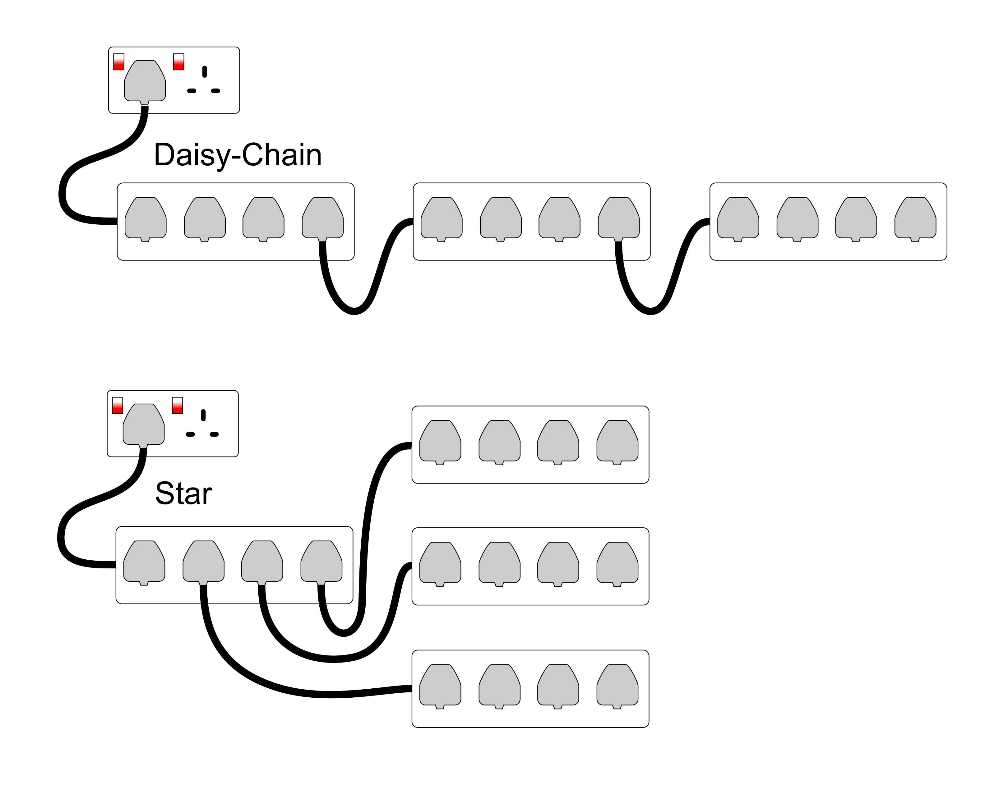

I need a translator. What precisely is meant by the phrase "star formation" in the UK?

Same as in the US (I've certainly had US manuals that refer to star wiring), though you need to have come across the term. In practice you plug in say one 4 way block to the outlet. Then you plug another 4 x 4-way blocks into the first 4-way block, to give you a total of 16 power outlets. Not quite true star wiring. as that would all wire back to a single connection, but topologically equivalent and practical.

"Star formation" means all the mains extensions run from one point, in a small venue usually a dual 13A socket or, in a bigger one, a single distro with multiple C-Form or 13A sockets. The important thing is that the earths/grounds don't form a loop and the power requirements don't add up to more than the supply can.... er.... supply.
But, in practice this is usually impossible and mixed star and daisy chained systems are the norm. A typical small band stage requires in excess of, say, 10 mains supplies to various points on the stage, sticking to a strict "star formation" would need a 10 way distro and 10 separate single socket mains extensions. In practice keeping the number of mains connectors to a minimum usually trumps it and I use a couple of 'B&Q special' cables with 5 single sockets spaced at 1M intervals across the front and back of the stage and with, where necessary, a short 4 way (I may swap the 5 singles for five 4 ways to reduce the number of potentially dodgy 13A plugs in any single supply and would be closer to a 'star form' system if I get around to it).

Watchmaker wrote:I need a translator. What precisely is meant by the phrase "star formation" in the UK?
The diagram below shows the daisy-chain arrangement at the top -- which is 'bad' -- and the star arrangment below -- which is 'good' !
The daisy-chain method of distributing mains power is more likely to introduce ground-loop hums and buzzes than the start-distribution method. This is because all of the ground currents have to flow along the whole daisy-chain which creates a larger voltage drop and thus powered equipment ends up with slightly different ground references depending on where they are plugged in.
In the star formation the ground currents in each plug-board are smaller and sum at the star point (the first plug-board in this example), and thus the voltage drop for each line is lower, and thus the chances of a ground-loop hum are also lower.
