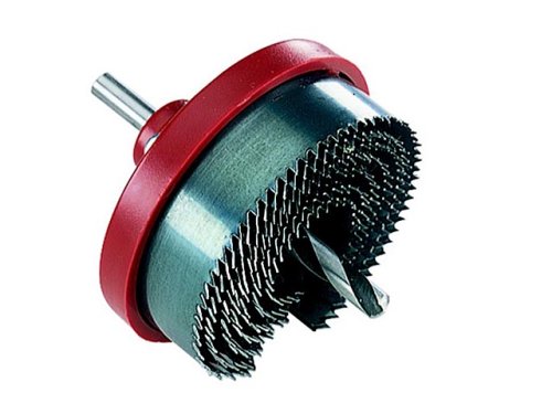

It worked. I placed a die 15mm on a side on top of the stand and placed the S1 Pro on top of that and the result was fully stable and I could remove the speaker from the stand afterwards without problem. The bottom of the micro switch (this looking down into the socket with the S1 Pro upside down) is, so far as I can tell, at 17mm so the micro switch should still be activated.
The solution, then, is to cut a disk of wood 15mm in thickness and 30mm in diameter and stick it permanently on the end of the stand. This will not prevent the stand from being used with other speakers but should make it usable with the S1 Pro without doing anything tricky or drastic like trying to slim the post down. I do agree with Wonks, though. This design is asking for trouble.
Me too.
Thanks all. This thread has been a fine example of what makes this forum such a good place to seek help. Thanks in particular to Rob who did the key research.
Cheers,

Think I'd be inclined to see if 9 or 10mm thickness was sufficient to stop jamming, before glueing anything permanently in place?
Rob

I certainly wasn't intending to glue permanently until I had checked my handiwork first. So far as I recall the wood I have lying around is 13mm thickness so I was going to start there. I've got a set of drill circular cutters so I'll just choose one of those of suitable diameter. This sort of thing.
