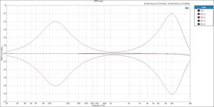

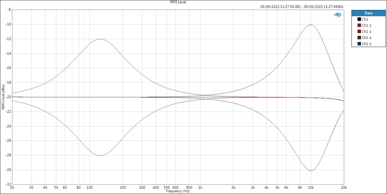

A few quick measurements...
First off, the channel EQ ranges. These are simple symmetrical bell-style EQs. The bass range is +/-8dB centred at about 120Hz, with a bandwidth of around 0.66 octaves or a Q of 2.4.
The treble EQ range is +/-10dB centred at 10kHz. The bandwidth is 1.25 octaves and the Q around 1.1.

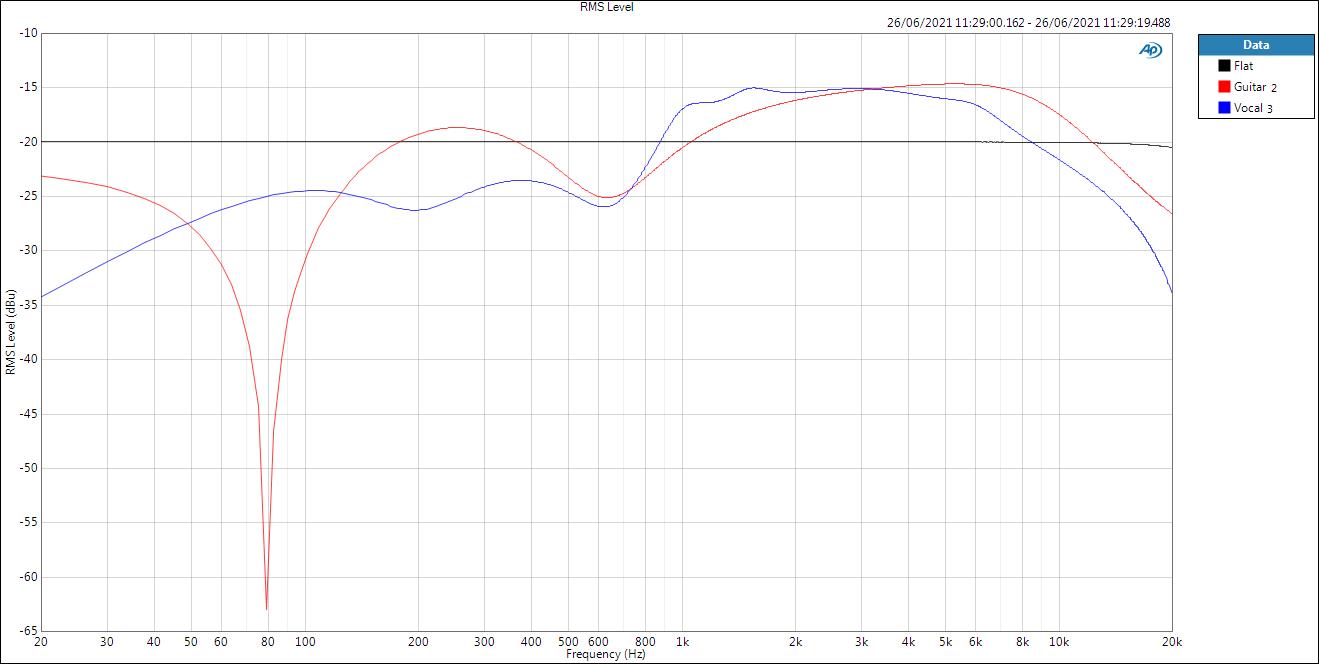

The 'tonematch' EQ is more intriguing! The black line is the flat mode, the red is the guitar setting and the blue is the vocal setting.
As you can see, in the guitar mode there's an 80Hz notch (presumably to remove sound hole resonance), with a little dip around 650Hz and a very broad boost around 4kHz.
The vocal EQ mode thins out the low end a bit with a modest shelf below 850Hz and a roll-off below 100Hz, combined with a broad presence boost centred around 3kHz.
Both EQ options are typical of generic PA EQ settings for those sources, really.
