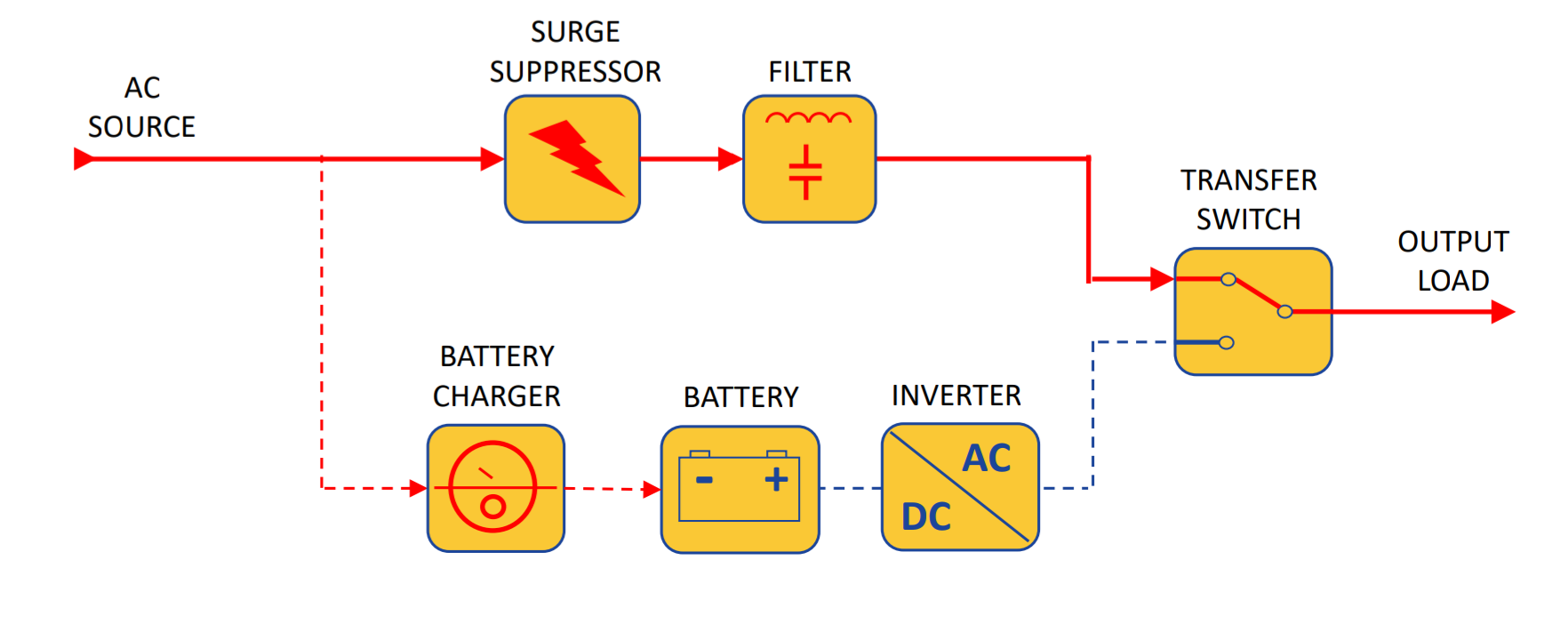

There are several variations on the UPS theme, and different manufacturers have different names for them... but APC offer three types:
Standby UPS is the commonest arrangement where a battery powers an inverter and the load is switched across only if the supply fails. The incoming mains may be filtered somewhat, but won't be regulated. The inverter output may be sinewave, but is more often a crude stepped waveform which can cause issues with computer-based equipment.

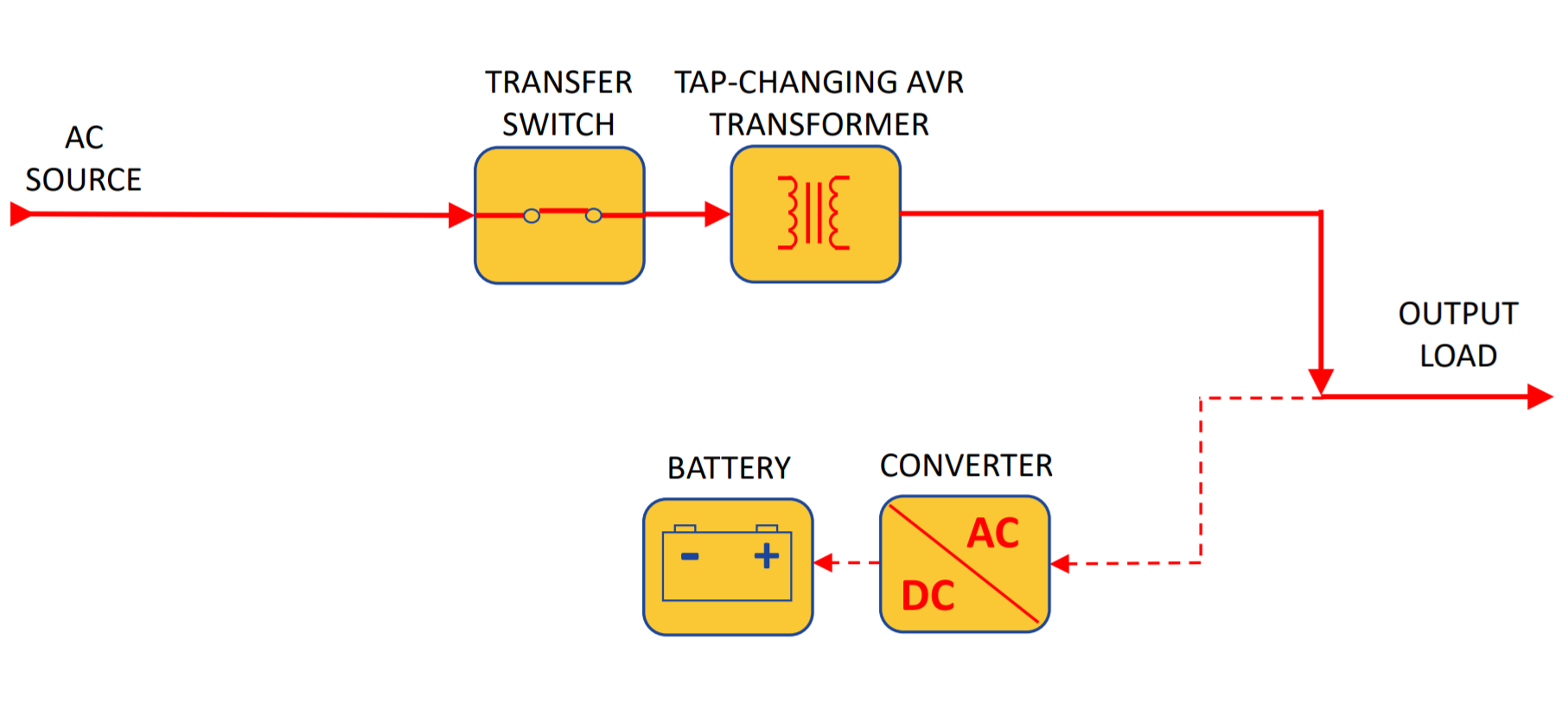

Line Interactive means the battery inverter is always connected to the output, charging the battery when mains is available and instantly powering the output if the mains disappears. This arrangement provides automatic mains voltage regulation, additional mains supply filtering, and reduced switching transients compared to a standard Standby UPS...

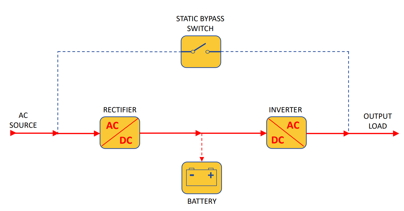

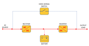

Online UPS uses a double conversion setup such that the output is derived directly from the battery at all times.
