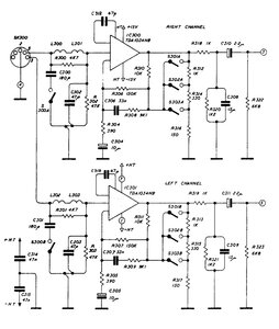

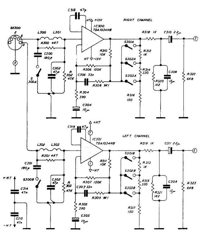

ef37a wrote:If anyone was contemplating building an RIAA pre amp the best IC is the NE5534 single op amp. Gives about the best noise performance at MM cartridge impedances.
It was what Quad chose for their 44 preamp (this shows the TDA1034, which was the chips name before it changed to NE5534). The switches shown select one of three different input sensitivities (1, 3 or 10mV for a 5cm/second groove velocity) and introduce a 180pF capacitance in parallel with the 47k input termination.
Posts: 42142 Joined: Fri Jul 25, 2003 12:00 am
Re: Vinyl Recording - 24-bit, interface Q, processing
Ah, well done Acoustical! I especially like the RF stopper at the front end but then would expect nothing less from them.
I understand the discrete 33 stage was not so clever?

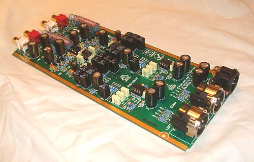

I've been tempted to try building Doug Self's design - a two stage preamp using the 5534. He takes great pains to accurately implement the RIAA eq using standard parts.
There's a version of it at
https://www.markhennessy.co.uk/showpic. ... /Phono.gif
with a short description at the bottom of
https://www.markhennessy.co.uk/preamp/analogue.htm
but you'll need to read Self On Audio for a full description.

James Perrett wrote:I've been tempted to try building Doug Self's design - a two stage preamp using the 5534. He takes great pains to accurately implement the RIAA eq using standard parts.
The Signal Transfer Company make several Doug Self designs available either as kits or ready-built and tested PC boards.
I have built the kit of his RIAA preamp (the balanced output version, but there is an unbalanced output version as well) and it performs superbly well. It also has selectable MM and MC inputs (the latter via a discrete transistor stage IIRC). If you're interested I could dig out the build manual and share the schematic?
http://www.signaltransfer.freeuk.com/RIAAbal.htm
