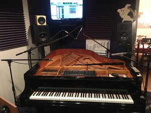

Sure, but what is more fun than than removing a grand piano lid with your uninfected kids! Gotta get them some school credit for this.
Photo:
https://drive.google.com/open?id=1MNz2u ... bZ0x39tJYj
Mix:
https://drive.google.com/open?id=1HRlIZ ... iFzllN2-ea
XY mics above piano:
https://drive.google.com/open?id=1aAwX8 ... RESooJzFN0
KSM on left:
https://drive.google.com/open?id=1nNBiQ ... Te9KtKUOxg
SM81 on right:
https://drive.google.com/open?id=1tz4Ok ... XMBk43r0rD

With no lid, I hear very little difference from the playing position. The piano sounds the same sitting and playing it with or without the lid.
But the XY mics are now much clearer above the piano. Recording sounds more like the piano playing back to me in the monitors. I was able to move the XY mics farther up without the lid. Phase scope shows much less out-of-phase sound.
Mics out front sound the same as before.
Removing the lid has definitely cleaned up the tone of the XY mics above the piano to my ears.

DC-Choppah wrote:With no lid, I hear very little difference from the playing position. The piano sounds the same sitting and playing it with or without the lid.
It will depend to some extent on the room acoustics (ceiling height and surface, mostly, but also proximity of walls etc), but in general you're quite right: playing with the lid open or removed makes little difference to the sound heard at the keyboard.
You really are firmly wedded to using a plethora of mics, aren't you! ;)
