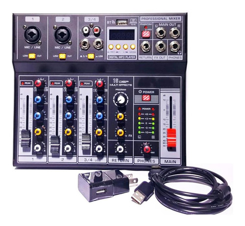

The mixer

I suspect the fundamental problem here is that your microphone is not designed to connect with a conventional balanced mic preamp in a mixer. Instead it is designed to connect directly to a laptop via either unbalanced 3.5mm with plug-in power (which is 5V or less) or via USB (which also provides 5V).
So although it uses an XLR for the output connection, the signals presented on the XLR pins are USB digital data and an unbalanced 3.5mm mic output expecting Plug-in Power from a computer sound card.
Neither of these things are compatible with a balanced mic preamp or 48V phantom power.
And the reason the sound dies with phantom power is almost certainly because the output circuitry can't cope with its high voltage and is basically shutting down.
You need a conventional microphone specifically intended for connection to balanced mix inputs to use with your mixer and, if that's a capacitor mic, compatible with 48V phantom power.

Thanks for the information!
I tried to connect the 3.5mm to the 3/4 unbalanced input and it works fine, so i think i will stick with that until i get a new mic or something. I really just wanted to connect the mic to the mixer so this works for me since now i can eq and add some effects directly to the input.
