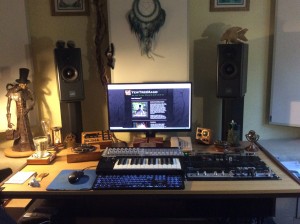

Not sure I understand entirely Martin.
My desk is like so:
I'm talking about replacing the top shelf (that the monitors and monitors are currently sitting on) with a new one, in the same place, but which extends backwards another four or five inches in the centre. This way the screens can sit further back without making any other changes to the desk or the monitor position.
(P.S. ignore the little desk off to the left, was doing some podcast recording for work).
My desk is like so:
Posts: 28013 Joined: Sun Jul 05, 2015 12:00 am
Re: What size screen do you use? (thinking about acoustics)
Ah, you'd better ignore me then
Yours is exactly the approach I had in my previous studio - a two-tier desk with rack bits and bobs slotted in underneath.
My point was that when I removed that shelf altogether and then propped up my two loudspeakers to the same height as before, I could hear the acoustic improvement immediately with all that 'free space' in front of the speakers.
If you're already happy with your sound with that full-width top shelf in place, and are about to replace it with a deeper one so your monitor screens can go further back then fine - carry on!
What I did instead in my current studio was to throw away the top shelf, saw a 19-inch wide 9-u high hole in my desk, installed all my rack gear horizontally into that to keep it well out of the way of the loudspeakers. buy 1-metre high floor-mounting stands for my loudspeakers to get them off the desk altogether, and install a huge 'megatrap' behind the desk that my monitor screen now sits on, as shown here:
