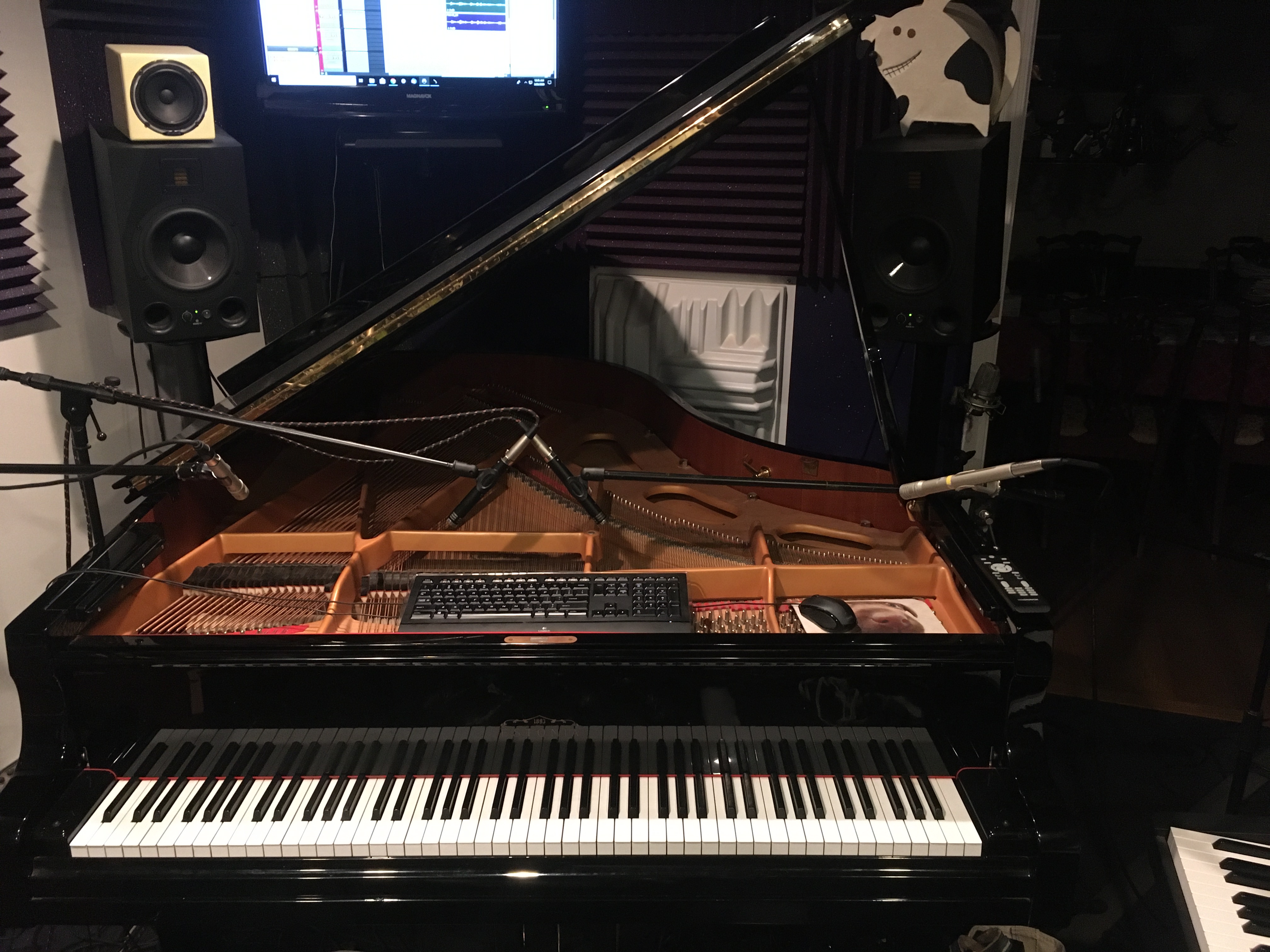

Taking High's advice, I ditched the PL9 and replaced with an SM81.
I tracked down the L/R imbalance on the XY mics. One of the channels in my analog mixer was set to PRE so the faders were not balancing properly. I fixed that so now when I hit a middle D, the mics ring at the same level.
I tried the SM81 all around the rim along the curve, but it always sounded hollow and like the sound hole. I tried the SM81 inside pointed at the strings. Same hollow sound. Very hard to combine with the other mics too. But just sounds bad on its own.
So then I moved the SM81 out front like the KSM137, but pointed at the high strings. This sounded good and more natural. So it seems the lid is not my friend. Gotta stay away from it.
So then I figured that instead of removing the lid, at least open it up on the tallest stick. The outside mics don't interact with the lid because of where they are out in front. The reflections from the lid don't come towards the outside mics perhaps.
This setup is actually sounding much more like my piano coming back through the Adam monitors. Cool.
Here is a photo
https://drive.google.com/open?id=1nTh7N ... -gKMYEoxWZ Here is the blend (no processing)
https://drive.google.com/open?id=1I8_cs ... ufEaxwzu2P
Tracks
Stereo mics (PULSAR II) over the hammers
https://drive.google.com/open?id=1z_lg9 ... w4qrFvLOWD
KSM137 out front L
https://drive.google.com/open?id=1advsg ... AfK6l2m5hi
SM81 out front R
https://drive.google.com/open?id=1k6Zxz ... zObFkePA2u
Please let me know how this sounds. This sounds much improved to me. At least much more like my piano.

Greatly improved, tonally, but the stereo imaging is excessively wide with a strong and unpleasant 'out-of-phase' quality to my ears. You can see the problem on a vectorscope or phase meter quite clearly.
Mono compatibility is not entirely desperate, thankfully, probably because you're blending in those close hammer mics with the wide-spaced front mics?
If you're happy with those mic positions you could try panning the front mics inwards a bit, rather than hard left/right. That might help. Or you might find that flipping the polarity of one of the front mics helps. Worth a try...

Hugh Robjohns wrote:Greatly improved, tonally, but the stereo imaging is excessively wide with a strong and unpleasant 'out-of-phase' quality to my ears. You can see the problem on a vectorscope or phase meter quite clearly.
Using the phase scope I see what you mean. Lots of anti-phase sound in the mix.
Playing with the out-front mics, these have little effect on the anti-phase sound. Flipping the polarity just takes out the body of the sound and no effect on the anti-phase signal.
Putting the phase scope just on these out-front mics and they don't show much anti-phase sound.
The anti-phase stuff is all coming from the XY pair. Flipping polarity on one of those mics takes the body out of the sound and does not reduce the anti-phase.
Putting the phase scope on just the XY mics shows lots of anti-phase sound. More than the center actually by quite a bit (5- 10 dB).
The only way to reduce the anti-phase sound on these mics was to put on an M/S and reduce the sides by 8 dB. But when I do that, it just sounds mono.
I wonder if my XY mics need a re-arrangement to get a stereo sound without the anti-phase stuff?

I would definitely start with looking at your x-y pair. If you've got them correctly set up it shouldn't sound phasey.

The XY pair is not XY.
XY describes a stereo array with coincident capsules, but none of the mics in DC's multimic rig are coincident.
The strong out-of-phase elements are essentially because you're using spaced capsules, and the sounds captured by the different mics are significantly incoherent (ie different to each other). In effect you have the classic 'hole in the middle' effect.
The important thing is to be sure the summed mono sound has all the characteristics you value in your piano sound. And if no, tweak the mic arrangement/mix until it does. Then you have the desirable situation where mono sounds great and stereo sounds even better...
It's easy to get into the situation where stereo sounds great and mono sounds compromised... or even bad. That's what you need to avoid, but no one said it was going to be easy!

OK, mics over the hammers are now a proper XY with coincident capsules and 90 degree angle. This gives me much less anti-phase sound for these mics according to the scope. Anti-phase sound is now 10 dB below the center channel sound.
Switching to mono yields no change in tonality. Just brings the image in-between the monitors.
This sounds good to me.

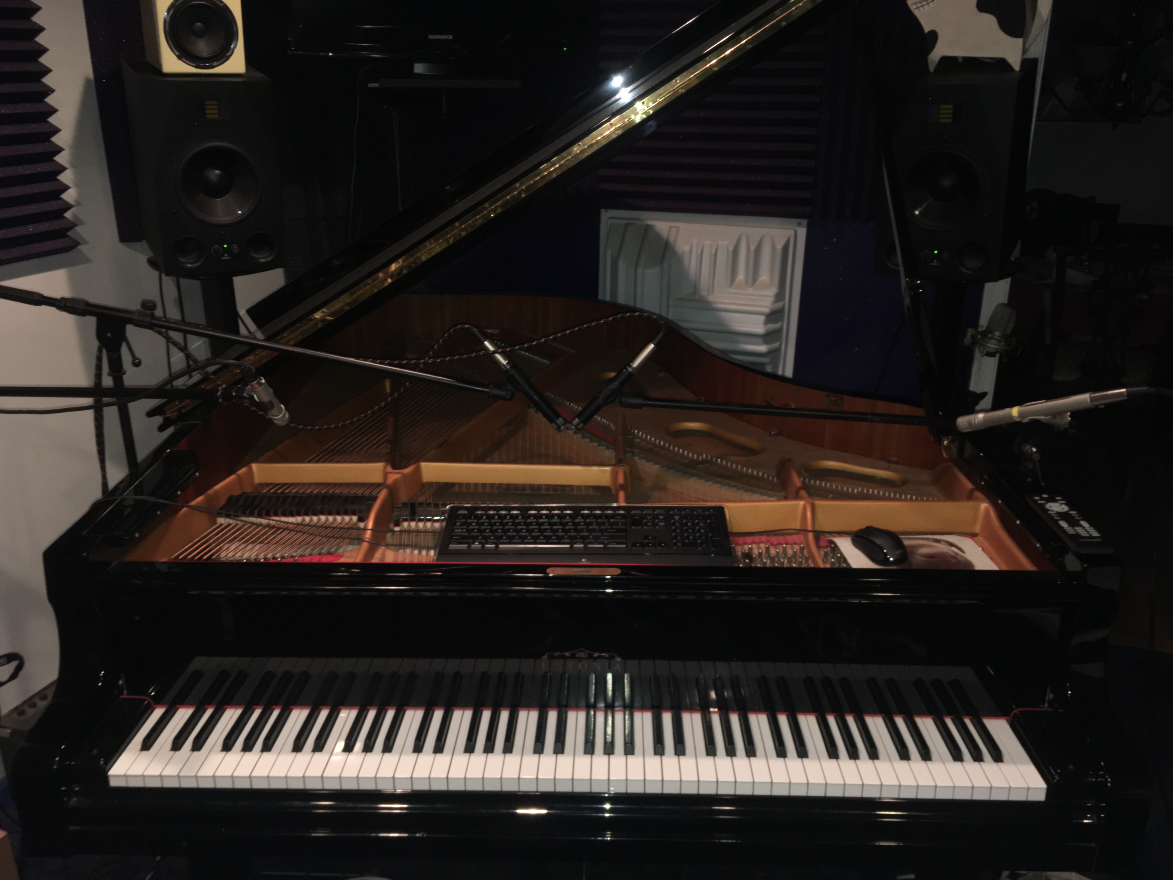

Picture:
https://drive.google.com/open?id=1onuot ... xBDlJwskp- I did try other configurations. For example I made the angle tighter of the spaced pair (45 degrees instead of 90) but that made the anti-phase sound even stronger.
For the coincident XY, it does seem that on the phase scope, the anti-phase sounds spike when I play single notes at the farther end of the keyboard. So the amount of anti-phase sound is just related to how many times I hit a solo high or low note.
Mix (no processing):
https://drive.google.com/open?id=1HkfGU ... Z5NK6w97MN
Stereo mics (PULSAR II) over the hammers in proper XY
https://drive.google.com/open?id=1gewUo ... D6gQ8Czc0S
KSM137 out front L
https://drive.google.com/open?id=13UCUn ... nVWqxt9DDI
SM81 out front R
https://drive.google.com/open?id=1-6FUQ ... R0uvkDhRl1
Picture:

It's certainly getting a lot better (personal subjective opinion of course)...
The mix seems to be left-heavy most of the time, and that appears to be mostly down to the XY mics in the middle. Being so close to the hammers, these are always going to over-emphasise some small regions of the keyboard at the expense of others, and it just happens that the key you're playing in here makes the track left-heavy. A different piece played in a different key would probably produce a different result!
There is also a lot of attack and distracting damper noise from those XY mics, again because they are so close.
Personally, I much prefer the sound of just the spaced outer mics (the KSM and SM), but panned in to about 50-60% each rather than fully hard left/right. Much less damper noise, less transient attack, more body and weight, nice stereo width and movement without phasiness, and quite reasonable mono compatibility.
So if it were me, I'd ditch the XYs, keep the spaced mics, and just pull the pan controls in a bit.

And just to add I think your Jazz playing and creation is going well, and once the headaches of mic's and recording are finalised it will go from strength to strength. If I could get my wife back on the keyboard I would record her, but she's concentrating on setting up teaching from home with all the problems it is bringing up. She's also had to give up all hopes of doing her recitals in London and Manchester until who knows when.
Re: Please help recording grand piano to eliminate phasey sound
Disinfect a friend and have them play the piano and listen while moving about.
Repeatedly I find a sweet spot at the inward curve, perhaps a foot or so up, pointing across at the centre. Slightly spaced and angled pair, or M/S or XY if you want real punchy mono compatibility.
Lose the lid and boxiness will go, because the box is gone! You will discover amazing clarity and pinpoint imaging of each note.....
DanDan wrote:'Disinfect a friend...'
I love that. Strange times we are living through indeed.
I am afraid to monkey with the lid myself. When my tech comes over to tune the piano eventually, I can have him remove the lid so I can record once and hear the difference just to try it. If you follow my stuff above, it really was the lid and music stand that was affecting the piano tone quite a bit.
It seems to me that any mic that is getting strong reflections from these big hard surfaces combined with the direct from the strings is going to be comprised in tone. At least that has been my experience. What the audience hears though is mostly what reflects from the lid I guess. But get in close on the side of the piano and you get both direct and lid reflections.
The real clincher for me was when I moved the SM81 around to find a place for it. All by itself it had the phasey, hollowed-out sound anywhere under the lid. So it was not the combination of mics, it was the single mics themselves that had problems for me.
The mics out in front of the lid get away from the lid reflections. Less liddy-sounding.
