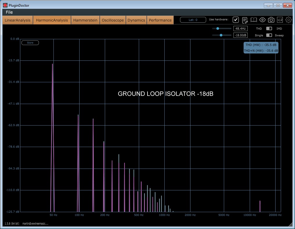

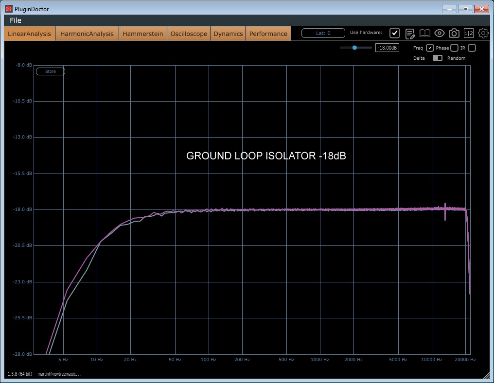

The tiny isolation transformer I bought cost me the princely sum of £4.21 for a stereo unit, and was like yours fitted with 3.5mm sockets and came with a short male to male lead.
As I mentioned, I was more interested in using this for some 'mojo' rather than for isolation purposes, and for this purpose it performed quite well - I don't have a scope, so tested it at 44.1kHz sample rate via PluginDoctor. It's 3dB down at about 10Hz (upper limit curtailed of course by Nyquist in this screenshot):
On the mojo front, with a nominal input level of -18dB its measured THD was -35.5dB overall, which equates to around 1.8%, so it proved useful for my purposes.

Re: Solving USB audio interface noise
The reason why balanced operation does not always cure ground loop problems is
Because electronically balanced inputs have a much poorer CMRR than a good 10k 10k bridging transformer*. The common mode impedance of an op amp input might be a few tens of kOhms whereas said transformer could be over 50 meg!
There is a paper on this by the Transformer Man Bill Whitlock (I'm sure Hugh has it filed?) and he rather generously developed an op amp circuit that mimics this huge CM impedance. They are marketed by the 'THAT' corporation.
Just a bit of a gripe Ajay. USB poor latency? You have not been keeping up with current events friend! RME have made very low latency USB AIs for years and my NI KA6 is no slouch. Later generation gear such as the MOTU M2&4 are even better I think and I am deffo going to get one of those Minifuse M2s very soon (in the latest mag).
But ground loops were always with us. We called them "hum loops" and I am somewhat ashamed to say we did some very naughty things to fix them!
