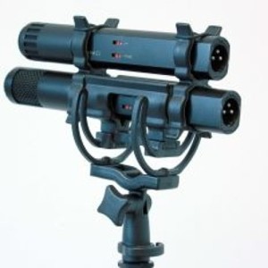

one configuration that I come back to often for small ensembles is a pair of parallel-mounted (one above the other) Sennheiser MKH30/30 (fig-8 Mid)
??? Is this pair at 90%, not parallel?
MOF
Posts: 2471 Joined: Thu Mar 06, 2003 12:00 am Location: United Kingdom
Re: Recording Sax orchestra live
I don’t think parallel is the correct term here. Vertically stacked in-line, diaphragm end to diaphragm end, with the mid pointed at the noisy stuff and the fig-8 sides rotated 90°.
Posts: 18277 Joined: Thu May 29, 2003 12:00 am Location: Reading, UK
The mkh30 is a side-address fig-8 (incorrectly mounted at the bottom in this Google pic), while the 40 and 50 are end-fire conventional pencil mics (on the top in this rig image).
Consequently, MS arrays using 30/40 or 30/50 combinations are mounted parallel, as shown above, one mic above the other.
For a Blumlein MS array using a 30/30 combination, you can use the same basic hardware, but arranged to be vertical with the fig-8 Mid mic at the front facing front-back, and the Side mic behind it facing left right, but slipped down a bit to avoid shadowing the rear of the Mid mic.
The two mics are still parallel in this arrangement.

We have four MKH40 at the studio, and I've always fancied an MKH30 to go with them, but if the Pearl lives up to expectation I may be able to forget about the MKH30!
I also like the Beyerdynamic M160/M130 pair in M/S - I use a mounting system that seems almost identical to the one in Hugh's photo, although a single clip seems to work fine since the M130 are so small.
