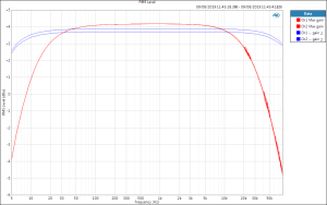

You seem to be suggesting that at higher gain, some preamps have an altered frequency response. Are you talking about specific preamps?

sonics wrote: Fri May 26, 2023 5:10 pm You seem to be suggesting that at higher gain, some preamps have an altered frequency response. Are you talking about specific preamps?
It's a depressingly common design failure that afflicts quite a few preamps — even scarily expensive ones.
Ideally the frequency (and phase) response should remain flat at all gain settings, but in many case the gain stage runs out of what is called "gain-bandwidth product".
In most amplifier designs the gain reduces as the frequency increases — it's a normal function of electronics — and it's no bad thing as long as it happens several octaves above the audio band (as it reduces the risk of RFI). But in a poor amplifier this falling HF gain can encroach into the audio band.
For example, the scarily expensive Neumann V402 shows a falling HF response at higher gain settings. In this particular case it's mild — just -0.5dB at 20kHz — and I've measured far worse (including some I've refused to publish a review for!), but there is absolutely no excuse for it happening at all. It's incompetent design, plain and simple, often due to penny-pinching and corner-cutting.
In some cases, the low-end can suffer instead (or as well), usually because of a problem with the feedback circuitry impedance affecting the LF roll-off... for example:

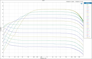

And here's an example that suffers at both ends of the spectrum:
As my favourite example of a perfect preamp, it's telling that Cranborne's Camden / EC2 / EC1 mic preamps offer significantly more gain than most competitors, yet maintain a perfectly flat and consistent frequency/ phase response to well above the audio bandwidth. So it can be done, even in affordably priced gear.

Thanks Hugh. I'm aware of those issues, but although I've experienced slight differences myself, it's been changes in upper treble, low bass, noise and, primarily, distortion. I've not experienced a preamp sounding noticeably thin just because it has more gain. Any source will, of course, sound "thinner" if it's quieter.

sonics wrote: Fri May 26, 2023 6:30 pm...I've not experienced a preamp sounding noticeably thin just because it has more gain.
That second example I posted above definitely did! But, thankfully, there are rarely that many preamps that are that blatant!
I've no idea what TRB was doing and what he was using to make his SM58s sound so poor. The sound of the 58 can change noticeably with preamp input impedance... and if high gain was needed because the vocalist had backed off the mic (like they might for an M1459) then the dramatic loss of proximity effect would have made it go very thin... And that seems a more likely scenario to me.
Nevertheless, it is not uncommon for mic preamps to run out of steam at their highest gain settings with a resulting audible change to their frequency response (and other characteristics as you've noted).

Hugh Robjohns wrote: Fri May 26, 2023 6:12 pm common design failure that afflicts quite a few preamps — even scarily expensive ones.
